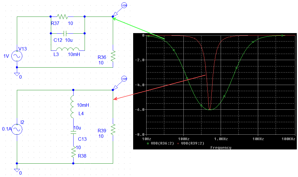

So, I revisited Nelson's current source plus filter articles and decided to DIY some switchable filters, which I have now done--3 switches, 4 coils, 4 caps, 4 resistors for each side, including the choice to short the components (not all three at once, of course). The reason I'm writing is because I spent way too much time looking for a simple explanation of the series filter in parallel "notch filter."

How do the RLC components work in a series filter in parallel with the speaker, as opposed to a parallel filter in series with the speaker--in layman's terms?
I had a good idea of how caps act in high-pass and inductors act in low-pass filters. The resistor seemed straightforward, and it was pretty clear to me early on that higher resistor values had opposite effects in the voltage-source vs current-source scenarios. Then, I got hung up on trying to determine the resonance frequency and bandwidth of my filter from the reactive components, and statements to the effect that capacitors become inductors and inductors become capacitors (in the "current source" case) confused me. I wondered, for example, if the resonance frequency of the filter was affected the same way when changing the combination of caps and coils. A literal translation of the statement above would seem to indicate that caps become low-pass components and coils high-pass. I couldn't immediately square that with my intuition or what little I know about electrical theory.
Here is what I never actually read, what I think is correct, and what would have been very useful to read...
In the "voltage source" filter, the signal must pass through at least one of the RLC components because the filter is in series. Therefore, the high-pass function of caps acts to pass high frequencies to the speaker, and vice versa for inductors.
On the other hand, the "current source" filter provides a parallel (alternative) path for the signal to ground, and that signal must pass through all three RLC components.
The resonance frequency of both filters using the same value components is the same. The difference is that the "voltage source" (parallel filter in series) passes the filtered signal to the speaker, while the "current source" (series filter in parallel) passes the filtered signal away from the speaker. The caps and coils still do what they do regarding their frequency effects. It's just that one filter is determining what goes into the speaker, and the other is determining what stays away from the speaker. In that sense, the caps and coils can be thought of as having the opposite effects on frequency.
But, they are not functioning differently in their electrical interactions with the signal. They are simply pointed in opposite directions relative to the speaker.
Am I correct? It occurs to me that the resistor being in series vs parallel with the reactive components may cause them to behave somewhat differently, but my intuition is that the resonance frequency of the filter won't change.

Drawings always decorate the discussion.
For infinite-Z sources and resistive-Z load, yes the L and C work the same.
The difference in this simple form is that the way I drew voltage-source the LC sees 10|10 of R while the current-source sees 10+10 of R, for a 4:1 difference of Q.
But we can make it more complicated. The R may be series or shunt with L or with C or with both. Some R in series with L is unavoidable in audio chokes. And lare R makes low price. Shunt R in L, and series or shunt R in C, is usually less significant. So a next step would be to allocate all R in series with L and see where that takes us. But not tonight.

Thank you for the reply. Very helpful. I think I'm following...the resistance in the filter is in parallel with the speaker (and any other) resistance vs in series, affecting the Q of the filter differently for any given R in the filter.
