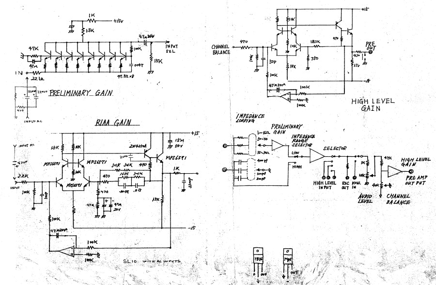

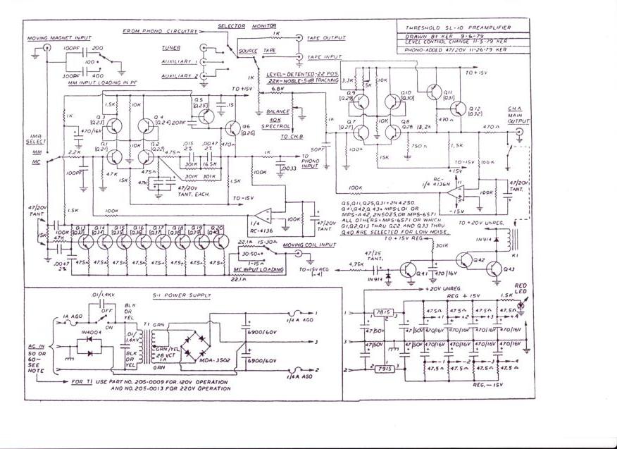

hello the one and only
im new to the forum but i bought a threshold sl-10 that i want to recap
it makes a hissing sound on the mc input,mm is still sounding ok
mc input is good for 10 minutes then the bad sound starts,must be bad caps or what?
found this list
Threshold SL-10 Capacitor List
Power Supply: Voltage Quantity
470uf 50v 9
47uf 50v 9
Phono Stage:
470uf 50v 2
220uf 50v 2
47uf 50v 8
4.7uf 50v 2
where is what going on the board?
soldering is no problem just figuring out where all caps are placed,ok
would be great if i could get the help here,THANKS

If you search through the forum you'll find quite a few messages about the SL10. Here are the schematics that others have posted. They are quite helpful in determining how to recap an SL10. In mine, I used a combination of Blackgate caps and some Nichicon bipolar caps. I described my experience here: http://www.diyaudio.com/forums/pass-labs/162305-restoring-threshold-sl10.html
