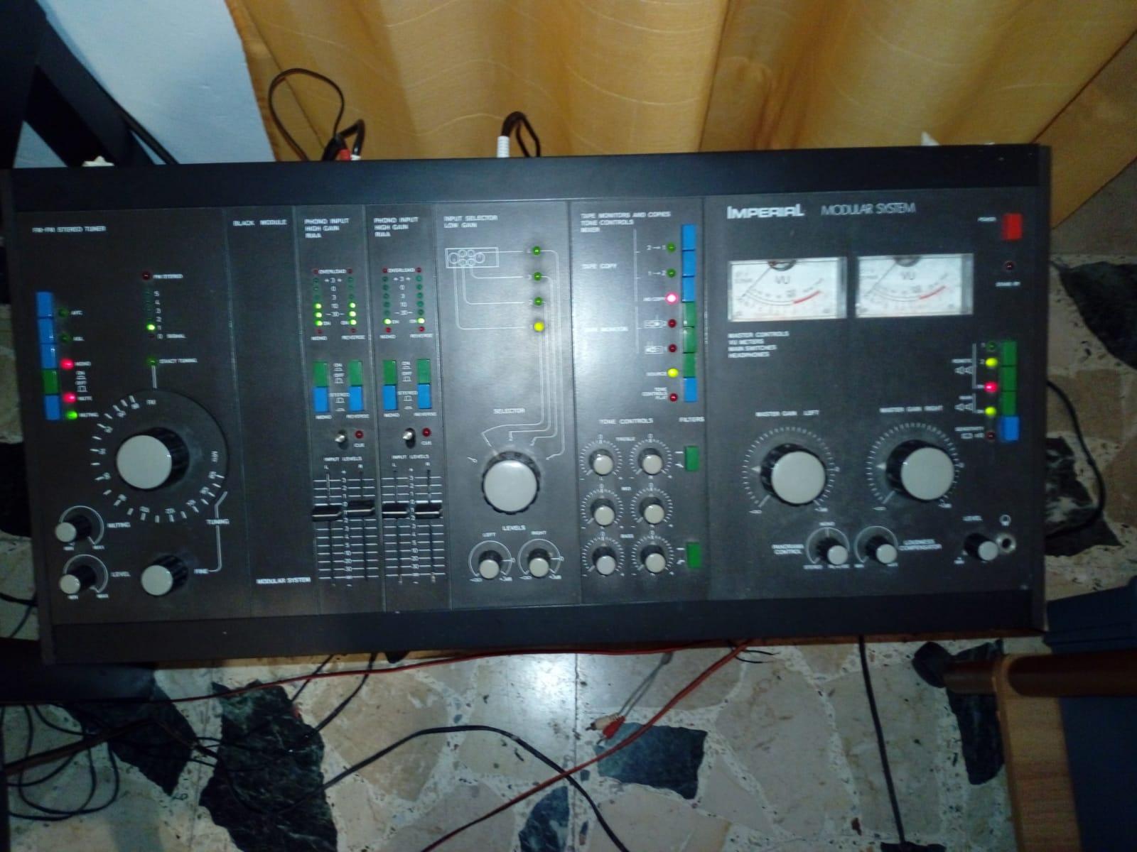

I would to recapping this old recapping stabilized current power supply from a vintage amplifier.
As you can see in the picture, there are three pink electrolitycs capacitors: the smallest ones are 3300uF 25 V, whilst the biggest one is 6000uF 32V.
I would to replace them with three capacitors with a bigger capacitance...but I repeat, it's a stabilizer current power supply board.
As I always say here, I'm just a newbie...so my question is: is this capacitors up-grade possible or could it a problem in a similar stabilizer current circuit board?

I would say you need to have RLC (ESR) meter make some measurements prior to do some conclusion.

I usually start from searching for a schematics. Otherwise I can only guess.
And I'm experienced with old Soviet capacitors, but have very approximate knowledge about foreign ones. That's why my guesses will be very inaccurate or of a very general type.
Look for 105 C rated caps, a 'general purpose' type.
You wan't find nowadays large axial capacitors now (it is very unlikely they are exist), so prepare to find a decision how to mount radial ones to a PCB instead of axial. But there are still small axial caps on the market (<=100 uF). Sometimes there is a possibility to place radial caps vertical with just making a new hole for one pin.
Those orange caps are likely tantalum (or of a similar solid-capacitor type) and usually work very long and don't have to be replaced.
As I see from a first photo there are only three large axial caps can be 'recapped'. They have not a large capacitance and quite a small rated voltage so it has to be quite easy to find a substitute for them. Actual caps are usually a bit smaller then old ones, this may help too.

Just a last important question: have I to keep the capacitance/voltage of the original caps or can I replace the two original 3300uF 25 V cap with two new 4700uF 35V caps and the original 6000uF 32V cap with a new 6800 uF 40V (or 50V) cap?
It is ok to increase a capacitance or rated voltage a bit. You may use 4700 uF 25-35V instead of 3300 uF 25 V, as well as it is totally fine to use 6800 uF 35-50V instead of 6000 uF 32 V.
To be sure I would measure real voltages across them.

Thank you again VovK Z: I've done what you've recommended to do: measuring the voltage across the pink caps with my multimeter setted on AC: on the two 3300uF 35V caps I measured 18 V whilst on the bigger pink 6000uF 32V cap, I measured 20 V.
