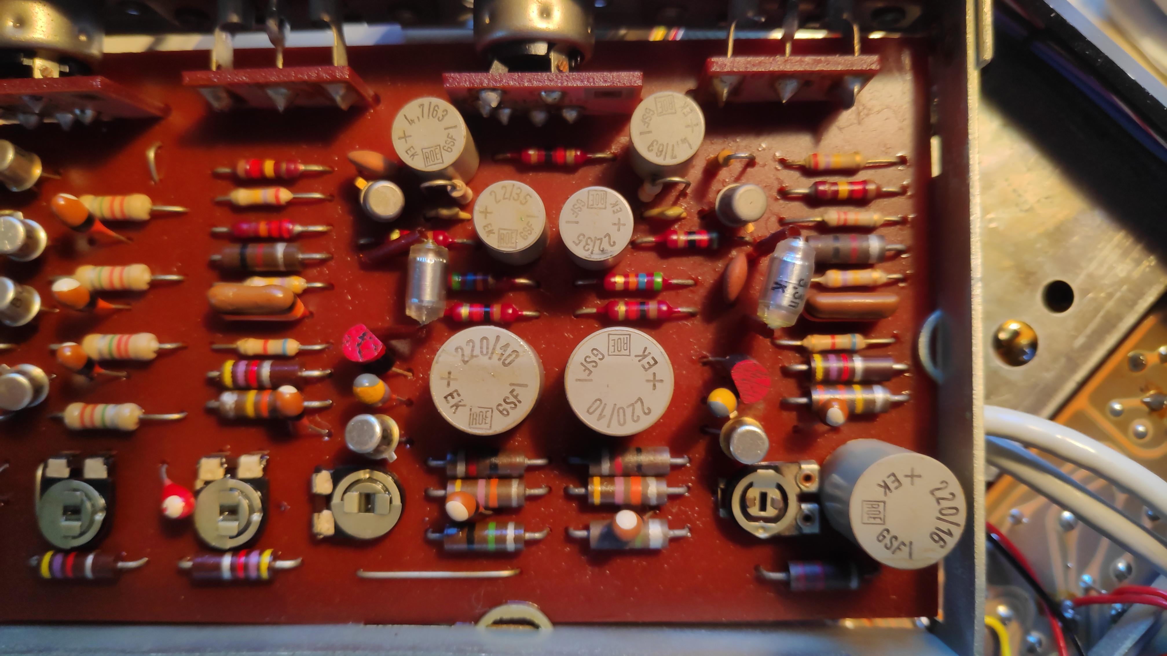

Hi All,
I have an old B&O Beomaster 3000 type 2402, which I love but it has a few problems - one channel dropping out randomly, very scratchy sliders etc.
I was going to recap the whole thing, but the old electrolytics look ok, no leaks, they are solid ROE types, see photo. But their measured values seem way off nominal - e.g. the 100/35 measured 149 uF, others were similarly off. Does this mean they need replacing?
Thanks for any advice - or if anyone could point me to a B&O repair forum?

Scratchy pots can usually be fixed with a good clean with deoxit or similar product.
With channel dropping out I found a couple of bad solder joints on some of my B&O stuff.

Theo, and all the rest of you on here, I have to yet again educate the "online" masses.....
Visual inspection of a capacitor to "see if it's leaking" is nonsense, because asides from fluid actually leaking from it, it can also be "leaky" electronically.
That means it allows DC to pass through it, causing issues with the equipment.
And the only sensible way to determine that is by measuring voltages with a meter, or other test equipment.
Whenever I see a person stating a visual inspection, I have to open my mouth (keyboard).
Bottom line, you cannot determine such things visually.
As for "off value" - it "can" be a clue to deterioration of the capacitor.
Because when the electrolyte dries up due to age, capacitance can actually go UP, bring the "plates" closer together internally.
Well, that amplifier is original and old enough (1970) to be using carbon composition resisitors. Sadly, ROE caps don't have a good reputation and no electrolytic is going to last 50 years whether in use or not. Just replace all the electrolytics with a good quality brand/grade, taking note that modern caps are much smaller and probably have different lead spacings and types of pins. Check the manufacturer's datasheets which are available from their websites or a distributor's listings.
All that fails on these well designed amplifiers is the pre set pots, they get tarnished and can go open circuit causing overheating and in some cases intermittent cutting out plus the sliders could do with a clean with Electrolube Switch Cleaner as can the switch contacts.
I recently had a B&O 2000 in for service, even older than the 3000. I removed the electrolytics to test the ESR and leakage values and found yet again they were almost as good as new with exception to the main smoothers and speaker coupling capacitors. Good fun trying to source the correct size and had to use slightly smaller physical sizes but always with the same values.
NEVER purchase NOS capacitors, it always ends in tears and extra faults!

You can't tell if a capacitor is OK by looking at it. Rising capacitance values typically mean the oxide layer is thinning out, so the voltage capability and (electrical) leakage will likely be much worse than original. Testing leakage requires unsoldering one terminal anyway, probably best to replace them and give the unit another few decades of life expectancy.I was going to recap the whole thing, but the old electrolytics look ok, no leaks, they are solid ROE types, see photo. But their measured values seem way off nominal - e.g. the 100/35 measured 149 uF, others were similarly off. Does this mean they need replacing?
