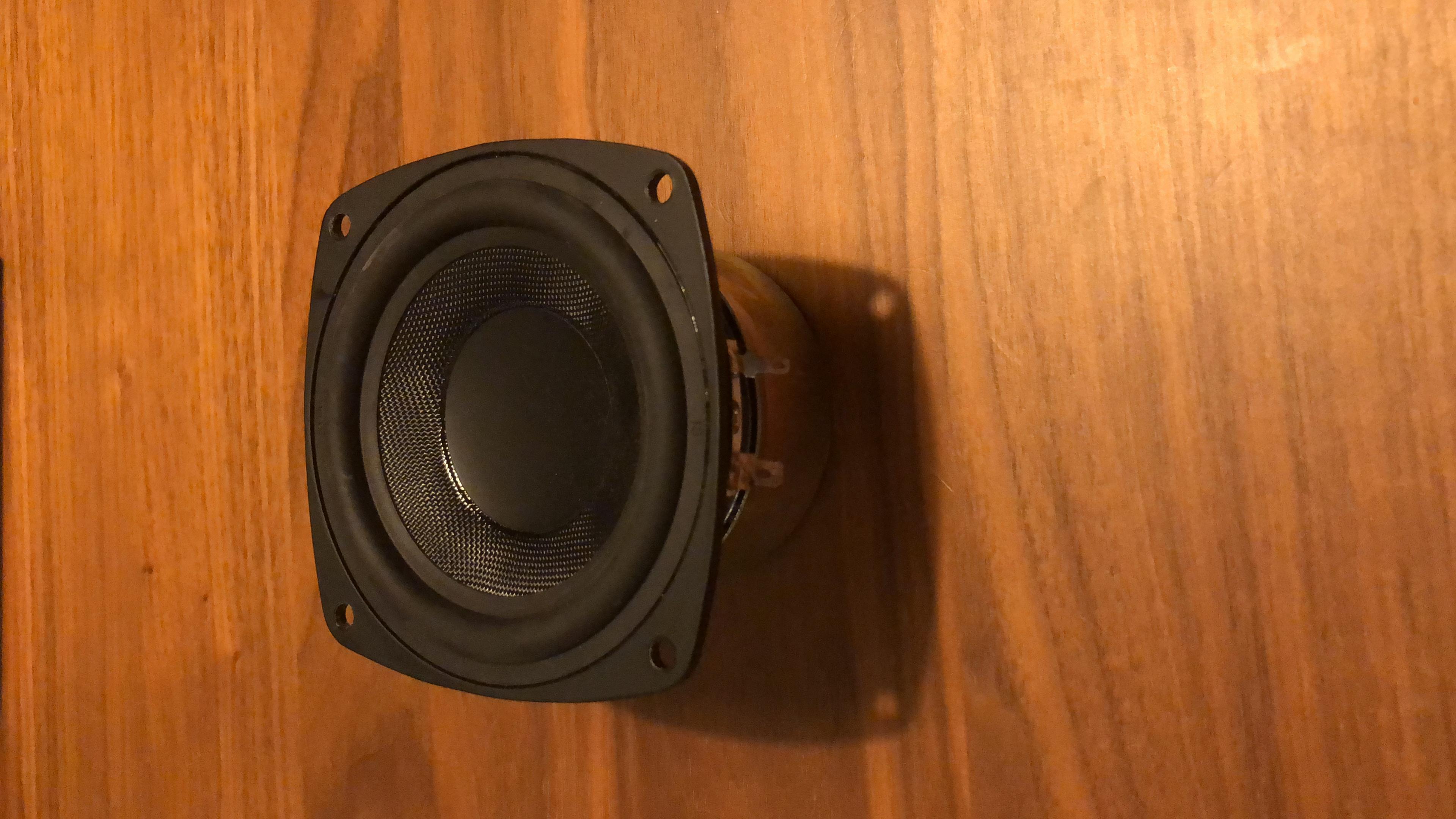

I am looking for build my own speakers atmos
i want to re built the speaker from book speakers Tangent evo 4 to on celling speakers.
the question is:
i can use the same square liters 1,4L or i can go better with a diferent volume?
the crossover it could be make with a better componet or maybe it is not the case?
Best regards
Andrea

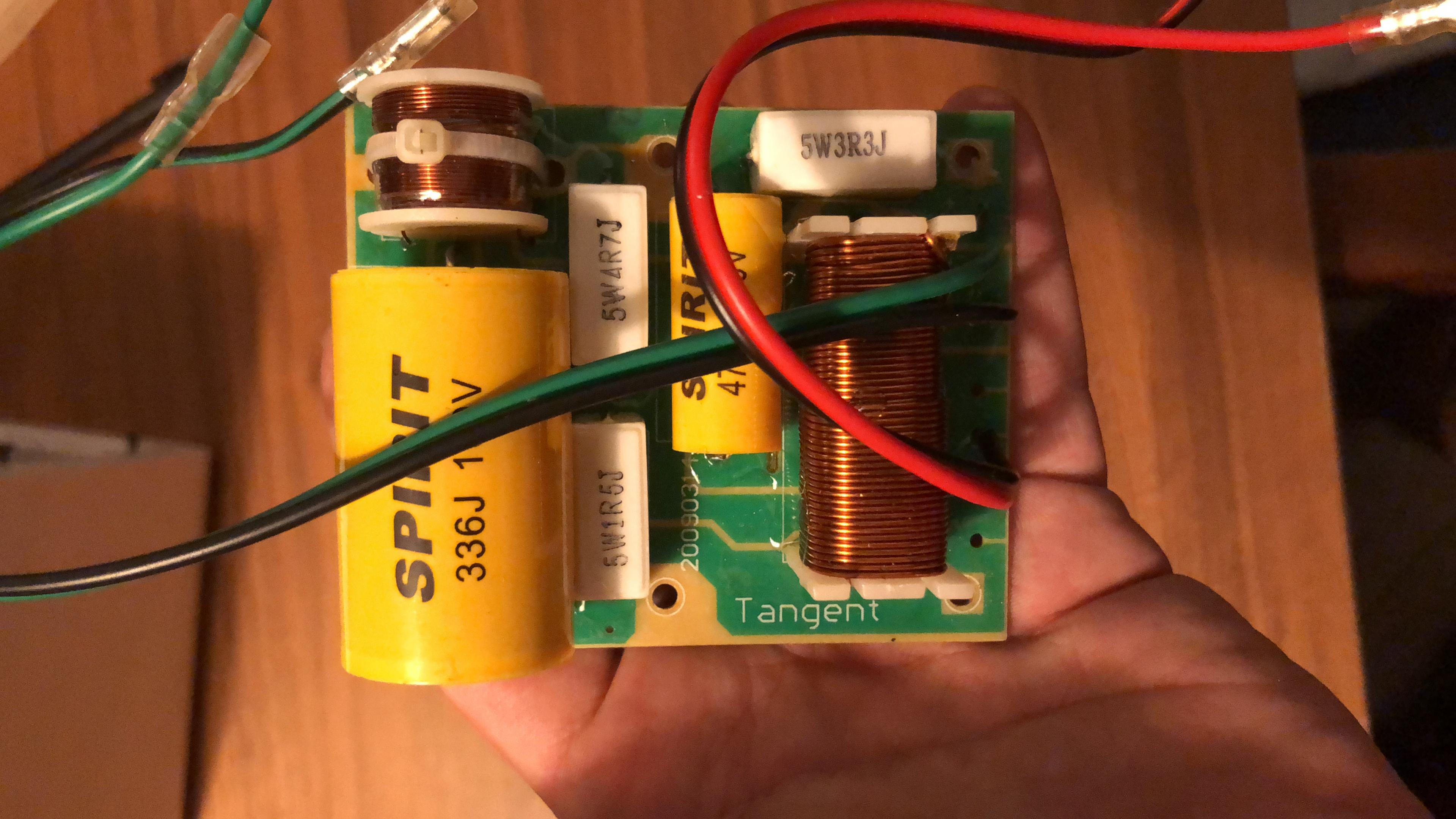

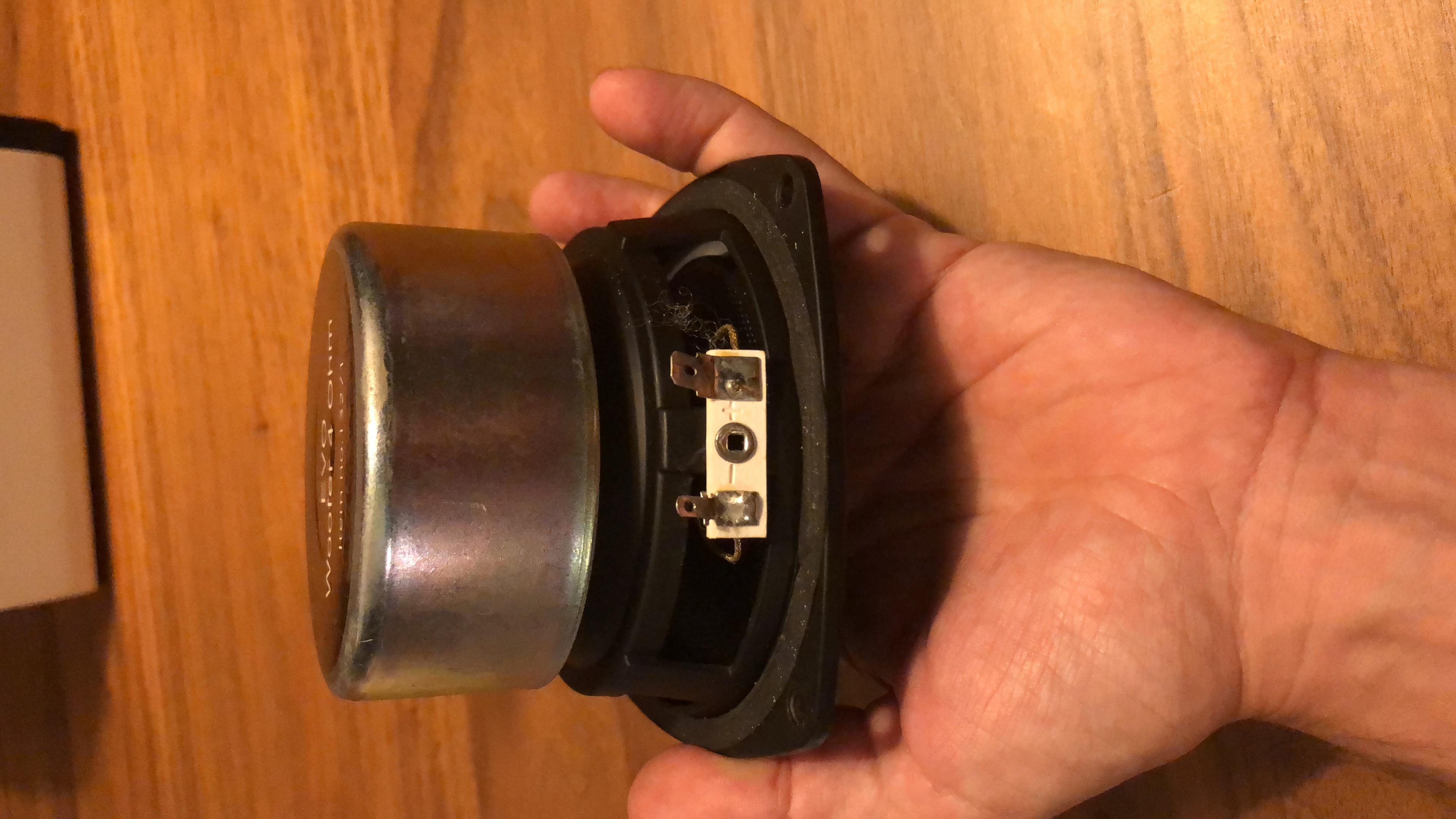

The quality of the crossover it seems very poor the woofer it seems no bad
Imean the magnetic part it seems enough big

On the contrary, quality of the crossover is very good.The quality of the crossover it seems very poor
There is no need to build a new enclosure. Simply mount the loudspeaker flash in-ceiling - you must have enough space above the ceiling for this, a least 16 cm (depth of the enclosure).

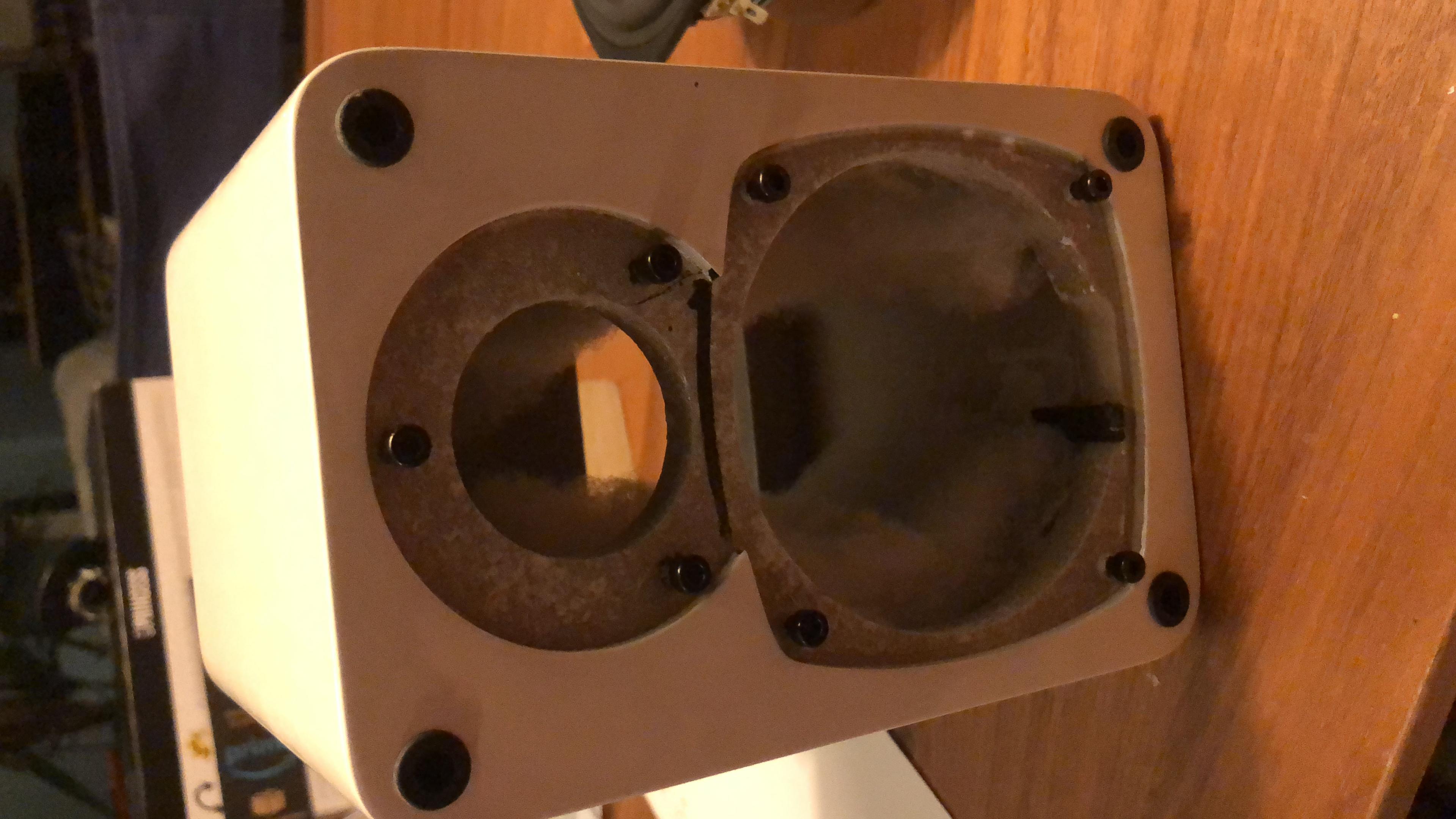

I will love to make a tinny speaker on the celling (like 7cm) and I do not want to make the hole on the cabinet
otherwise I will not know how attach on the celling
That why I want to make a new cabinet
Do you have some advertising for the shape and the size of the cabinet?
Thanks in advance

Do not make any hole on the cabinet! You should make a hole 19x13 cm in the ceiling (providing you have 16 cm empty space above ceiling) and flush mount the loudspeaker cabinet, facing down. If you don't have enough space above ceiling (is it only 7 cm?), than you must remove the drivers and the crossover and mount drivers directly in the holes cut into the ceiling. It will be easy to do if the ceiling is plaster-board (Knauf) construction. But if it is solid concrete, you have to build another, shallow cabinet with about the same volume as original (can be larger, but no smaller) and mount it on the ceiling. Shape is not important.
