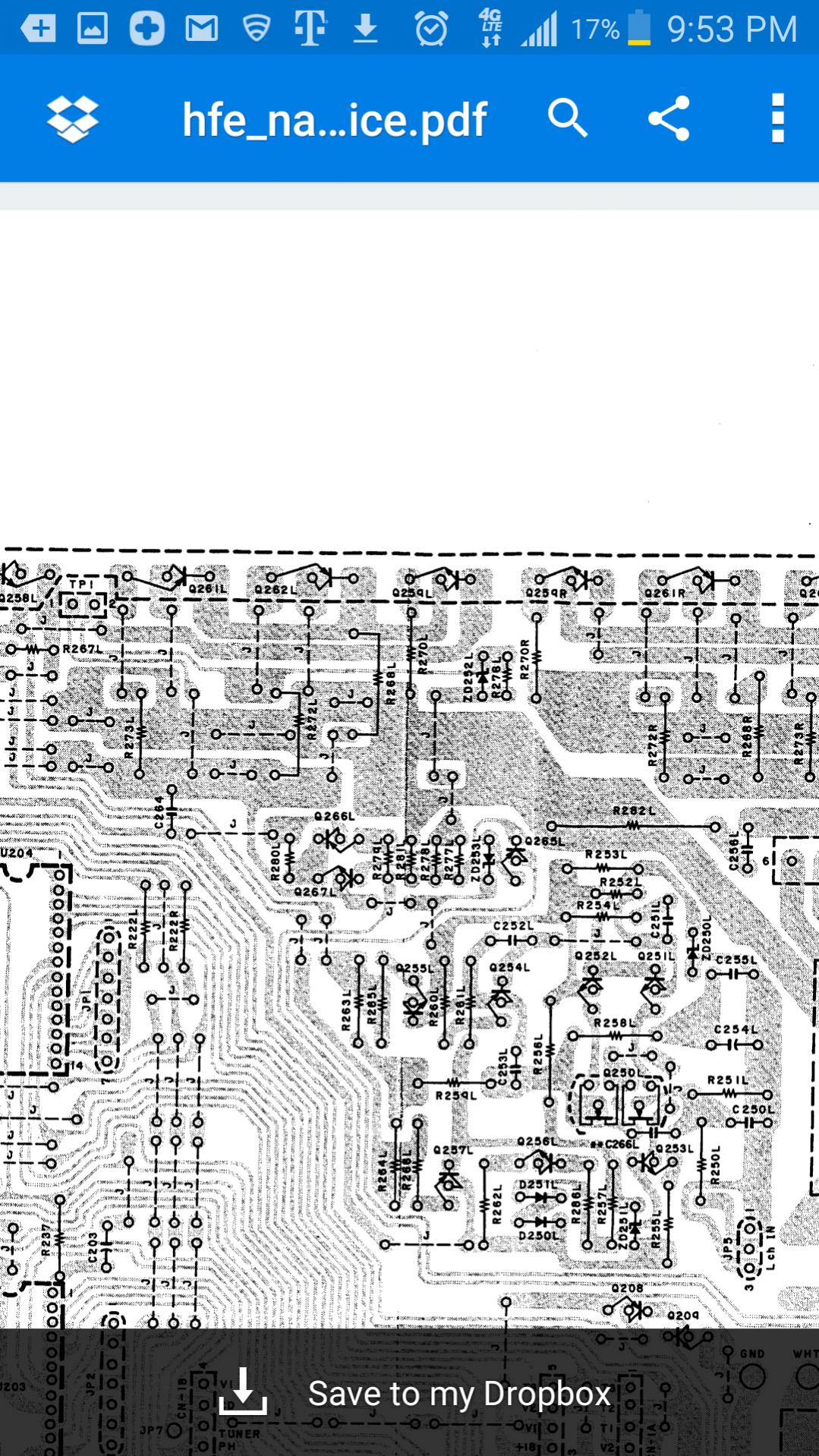

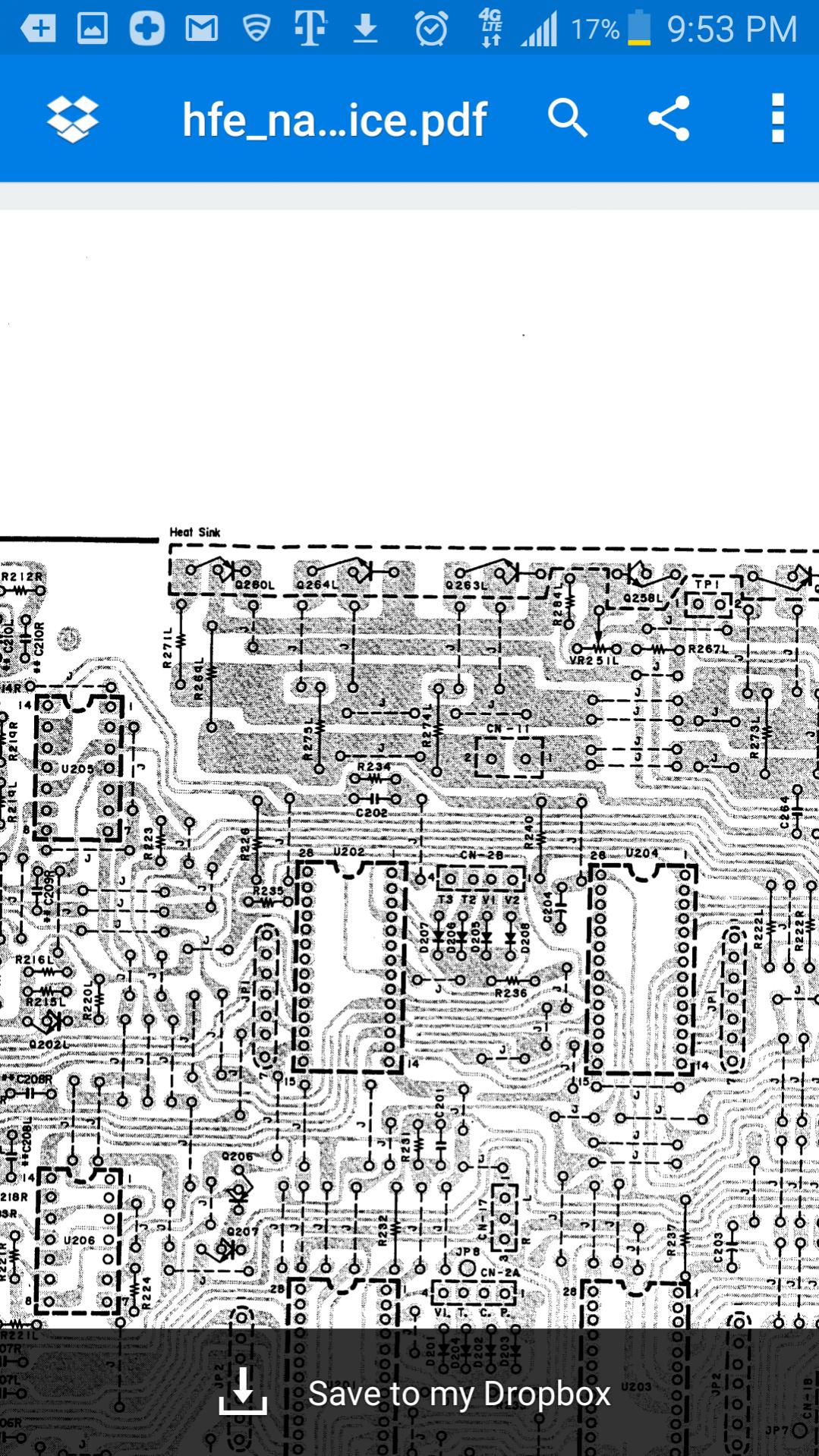

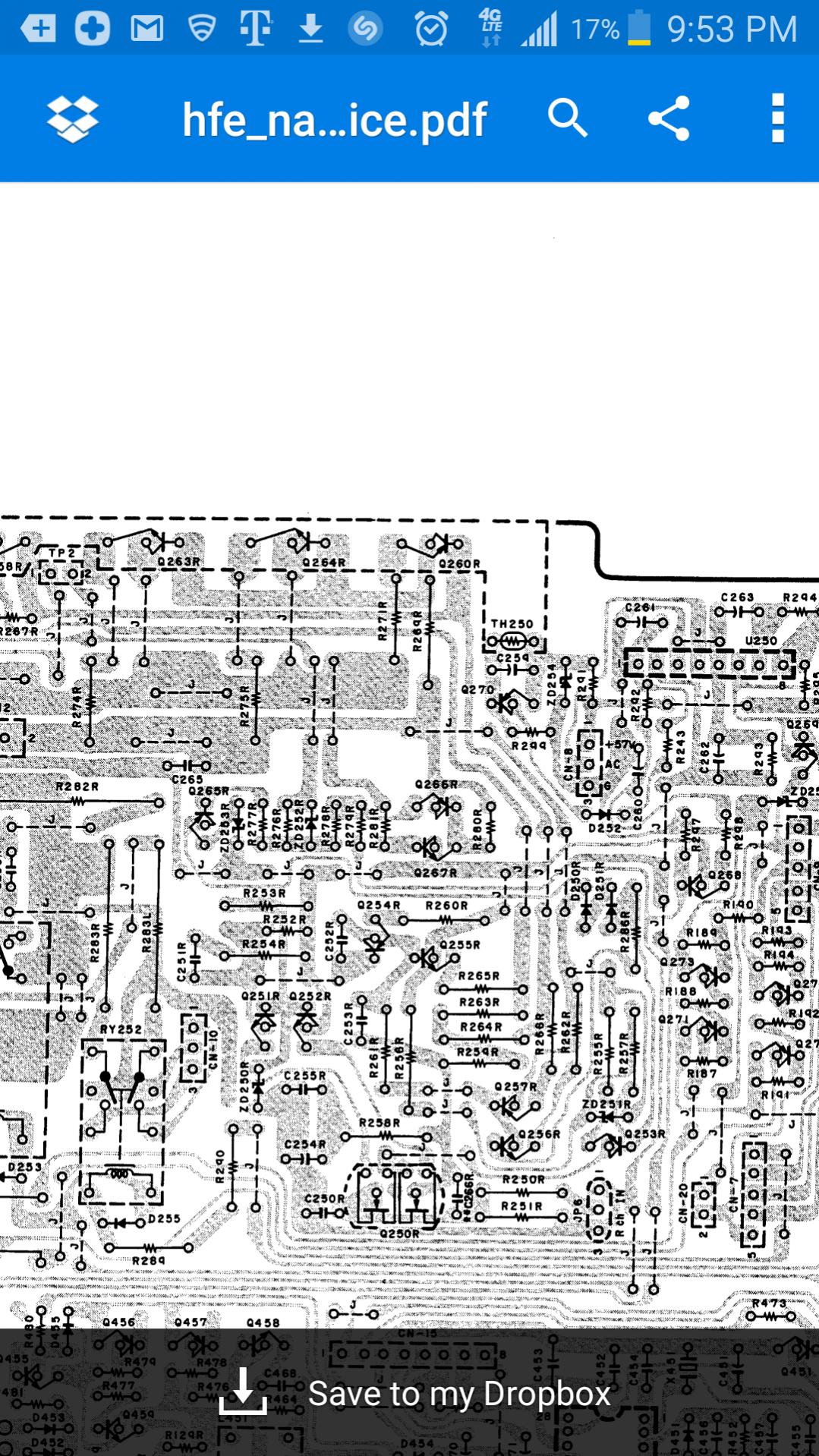

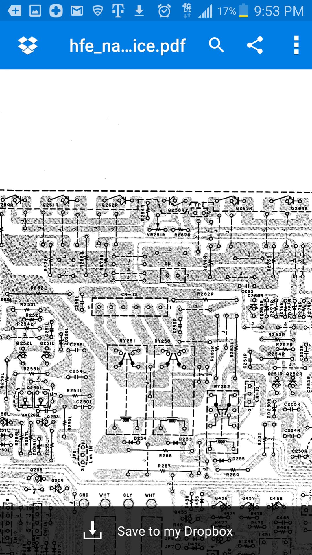

I am rebuilding power amp section if nakamichi ta-4a.
Shorted bias voltage terminals by accident. But power amp section had other issues.

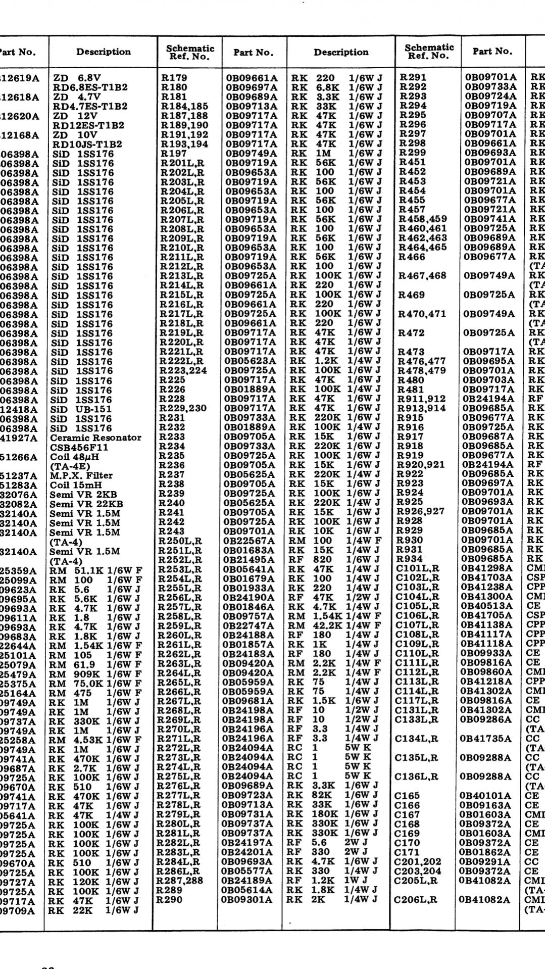

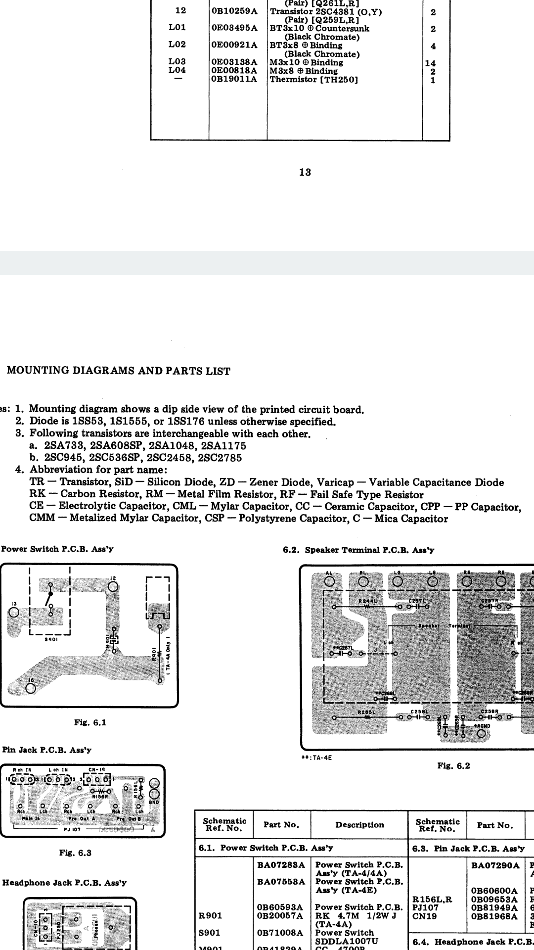

There are 4 types of resistors used in this nakamichi
Rk -carbon resistor
Rm- metal film resistor
Rf-fail safe type resistor..
Rc - not sure.. does not say in the manual. I guess carbon composite.
I am thinking of replacing all resistors with vishay bc metal film .
Except those fail safe resistors.. which resistors on digikey are good replacements.
I am ordering resistors 250 through 288.
Also what type could RC resistor be?
And some resistors say 1/4W J. And some 1/4W F, or 5w K.
What do those j,f and k letters mean? Tolerance? 1% vs 5% vs 20%

I attached pics of that manual page that explain resistor abreviations. It desiphers all except RC.

RC = Cement Resistor. Japanese gear commonly use Futaba or Noble non-inductive cement resistor as emitter resistor. They are usually white square shape. Rather difficult to source. Substitution is Koa Speer type BPR.
Failsafe resistor also known as Fusible Resistor, it has a fuse which will blow/open when exceeding wattage rating.
