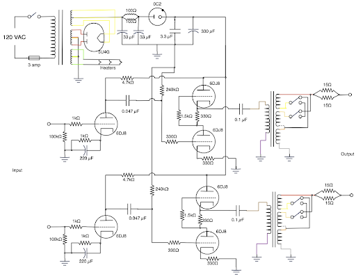

Hi Guys
I bought a Decware MLB from head-fi a year ago, and loved it. But i found that the bass impact was somewhat lacking. I've asked Steve at Decware on how to resolve this, and he told me to try changing in higher valued coupling capacitors which worked out pretty well. However, the internals are pretty tightly packed, so I want to rebuild the amp with better spacing, so i can roll capacitors more easily. So while I'm at it i would like to ask if there are other ways to improve the amp. Also theres a 0c2 voltage regulator tube, I was wondering if i can switch it to a 0a3 or 0b3. Thanks
