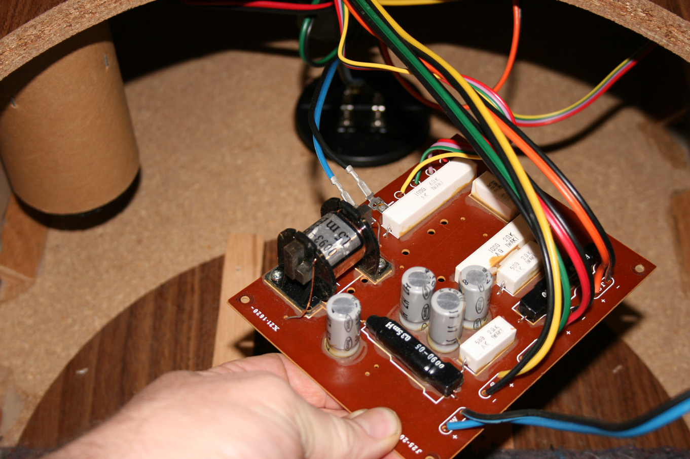

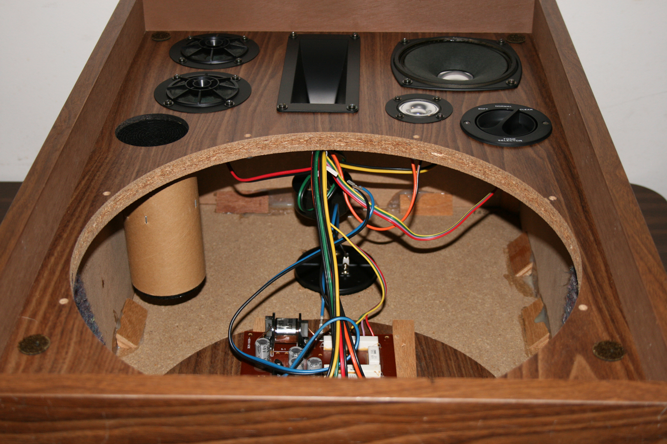

I'm in the process of trying to improve the sound quality of a set of Kenwood KL-777D speakers that I saved from a trip to the dump. They were given to my wife sometime in the mid to late '70's - so they are orginal. All of the drivers appear to be in great shape; no dents, holes, or tears.
So far I have replaced the input terminals with new terminal posts. My next task will be to replace the capacitors with new ones.
Are there any other things I could do cheaply, to improve the sound quality as well? Would adding any insulation help? I've noticed many of the latest speaker designs have batting material inside. There is nothing like that in mine, just some 1/2" to 1" thick fiber carpet padding in the bottom half of the enclosure.

First: remove the back panel . Remove the crossover . If you aren't going to use two stereo amplifiers , put a large (3-4 uH)inductor before the woofer . Putting Jantzen caps instead of the originals didn't change much .
But the best result is by using the big woofer in OB with a 10 dB bump below 100 Hz and cross it electronically at 500 Hz . Of course the cabinets should be kept horizontally to keep the mids aligned , but at this point also a big tweeter with a waveguide should be added to match the PERFECT quality of these drivers...

picowall's suggestion is fairly radical, but often done. Many of these boxes had great drivers implemented poorly. My suggestion for a radical change would be to make them a 3-way by eliminating the 2 paper mid-tweeters and the horn, and redong the XO...
Leaving things as are, the box needs at least the walls lines, i'd be tempted to stuff the entire box with 0.25-0.5 pounds of polyfluff per ft^3 of box volume. Better wire, ductseal on the baskets, at least minimal bracing of the cabinet..
More invasive, would be to coat all the paper cones with mod-podge (thinned -- as little as you can on the mid-tweeters & midrange), more on the woofer (and both sides). The next step after that is to EnABL everything.
You could also take a router with a round over bit to the edges of the box (means losing the grills)

Dave's right ...
Mines are a little bit different , having brown paper cones , 2 big midranges ,2 little horn tweeters ,and the little mica one ,and being originally sealed boxes .
My advice is to remove the back panel (and throw it away) ,put some varnish stripper behind the bolts ,then remove all the speakers , put a big Hi-vi RTS2 tweeter in place of the little drivers ,try to calculate a good crossover design ,then using as a source a portable CD player having a digital (analogue is worse) bass boost.
Except putting a new tweeter ,that's what i did . The shape of the box allows for an H-frame OB design . At the end ,bi-amping allowed me to have only a little CL filter for the tweeter . Ehi! Remove also the cloth behind the grill 🙄

Thank you both for the replies. I ordered replacement caps last night and should have them by Friday. I guess that's my 1st step.
Planet10, I will probably seal the baskets and stuff with the fluff, not sure yet about sealing the driver cones though. 😕 With each of these modifications, what difference in the sound should I hear?
The fluff should lower the Q of the box, refining the bass, and making it less lumpy.
Wire should improve the downward dynamic range... single strands of solid core CAT5 should work well for all but the woofer,
Puzzlecoating the cones will reduce the cone self-noise (ie increase downward dynamic range)...

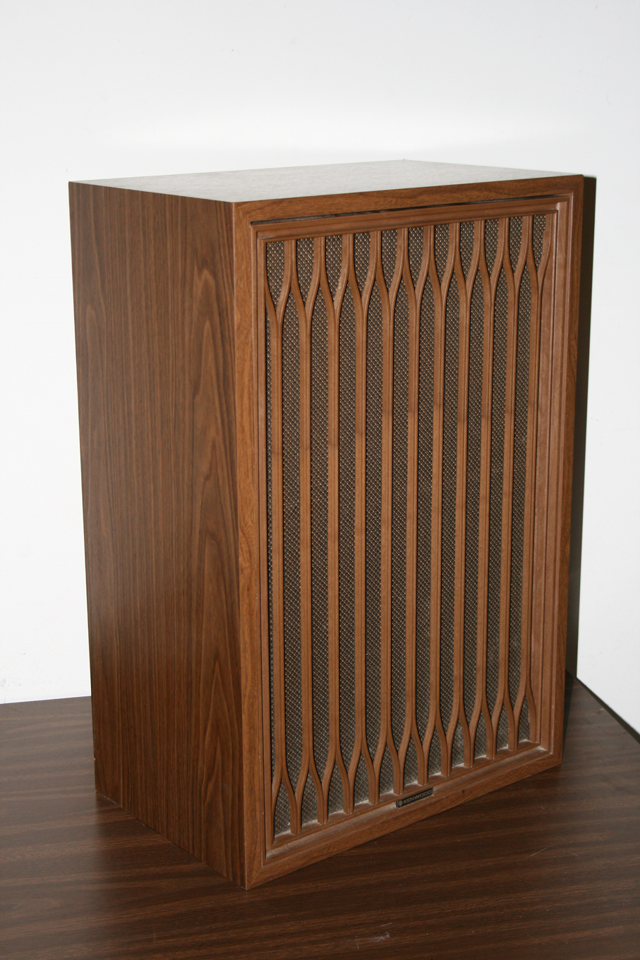

Kenwood speakers 777d
I just picked up the same Kenwood speakers 777d. Going to try to mod them using some of the techniques here. I'm only going to do one speaker at first to compare to original.

The more I look at these things the more I think "What the hell were they trying to achieve?"
Woofer, midrange, 2x upper midrange?, metal tweeter and a horn! Wow.
Did Rudy Bozak design these? 😀
Love the grills, tho.
