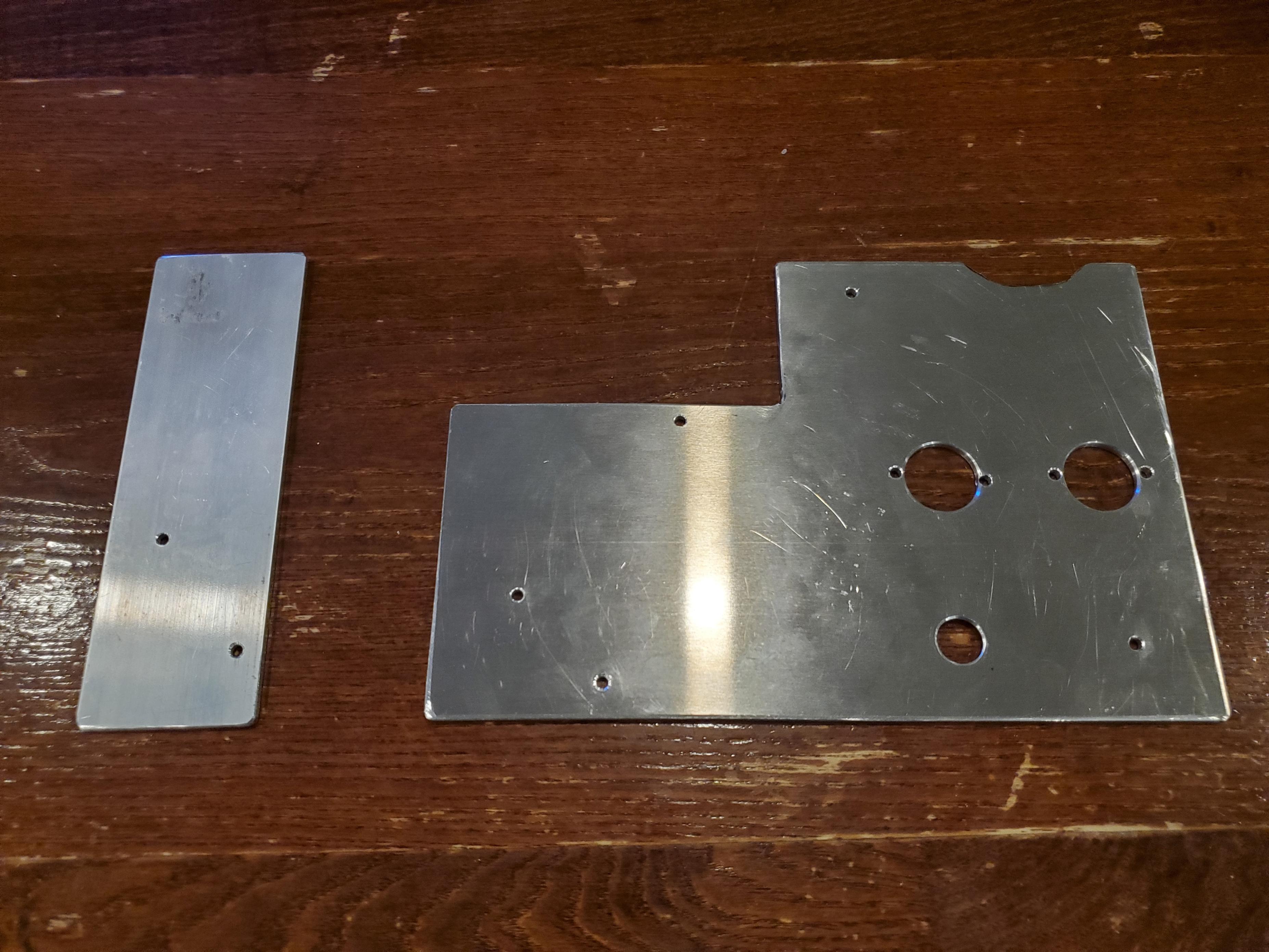

Unfortunately, all the tuning components (variable capacitor, tuning coils, dials, knobs) were missing. I think someone before my tried to rebuild but gave up. Replacement parts are un-obtaninium. So basically this is going to become a conventional amp/speaker combo so a regular line source can drive it.
To keep things safe, I needed to blank out the extra holes. Something like this should work.

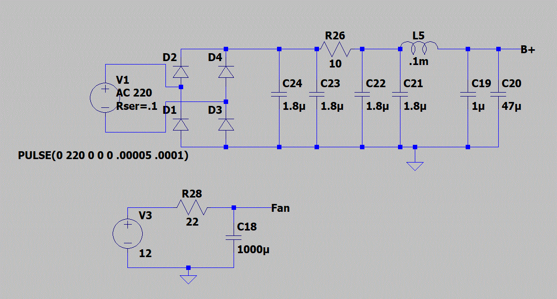

For the B+ I went with one of the cheap 12v to 220v inverters from ebay. It's "rated" at 150 watts, so I'm guessing 40 watts reliably. I usually go with a MOSFET series regulator, but I decided to do a passive filter. The higher frequency makes the filter components smaller and the frequency is probably above audibility.
The power for the amp comes from a 12v switchmode power supply. The 12 comes in and is switched by a relay to keep the current through the ON/OFF switch to a minimum. The 12v is run to a bus block as a central location for the 12v. The heaters will use this for power.
I also figured I'd use a small fan to keep everything cool, so I put in a RC filter in front of it. This serves two purposes - it reduces the voltage to the fan, making it spin slow enough to be inaudible. Also, since modern brushless fans are really just fancy power modulators, it reduces any EMF noise produced by the fan from leaking back into the main 12v supply.
For the B+ I went with a CRCLC filter. PSUD and LtSpice tell me it's theoretically going to have millivolt ripple, so that should be good enough.

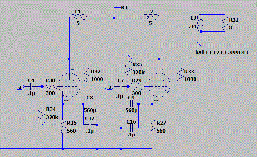

Starting with power section, I went with a very standard autobias grounded cathode push pull arrangement. The output transformer is an Antek power torroid with two 7v secondaries in parallel. That should give a 8000 or so ohm inductance on the primary. The 6GV8s are triode strapped. Looking at the datasheet, with 220v of B+, 40ma of current results in 20v of bias needed. I used a 560 ohm resistor on the cathode because I had a bunch of 5w resistors in stock. It's bypassed with a 63v 560uf Elna cap with a .1uf film cap in parallel. This needs about +/- 20v to drive it and will produce a few watts, which is all I need.

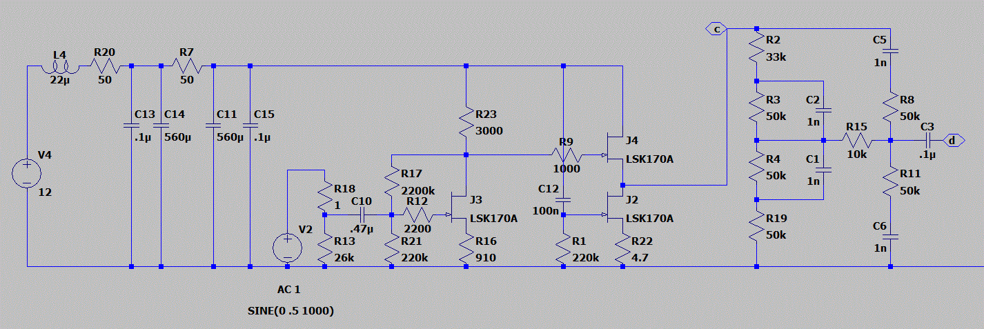

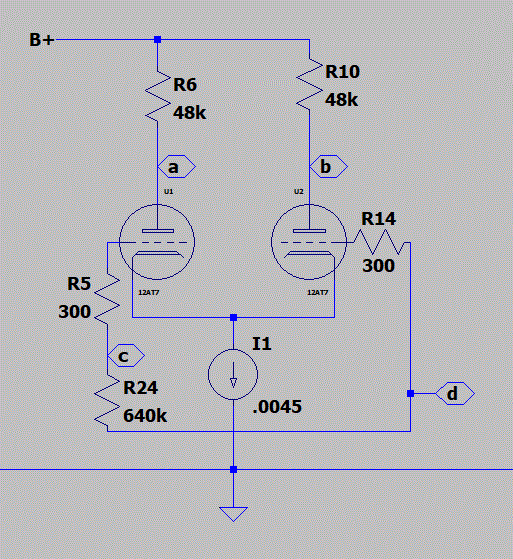

The driver section is going to be more complex. It would be easy enough to go with a voltage gain stage and then a concertina phase splitter, but I've done that before. Instead I decided to try an AC coupled long tail pair. To make a CCS for the tail, I used a LM134 set with a 22 ohm resistor at 4.5ma. But this needs at least 3-4v across it to have enough headroom to work. The triode will normally be biased at about 1v, so this will be a problem unless I can find a way around it (which I can).
One of the things I had to deal with was the extra holes in the chassis. There are four holes up front, so I used one for a power switch and one for volume. To fill up the other two I decided on using tone controls.
The triode of the 6GV8 models fairly well as a 12AT7, not exact, but good enough for testing things in Spice. To get the +/- 20v of drive that I need would be easy, except a tone control loses about 8db of signal and should ideally be driven from a low impedance source. With a tone control in place, there wouldn't be enough drive from a standard +/- 1v line level signal. So, I had to get creative.

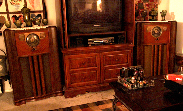

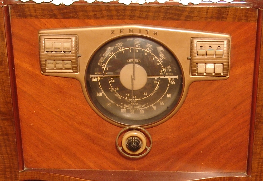

You just "broke my heart " Fenris a beautiful antique wooden radio case being turned into a practice amp .

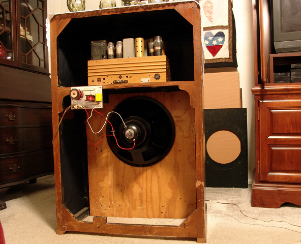

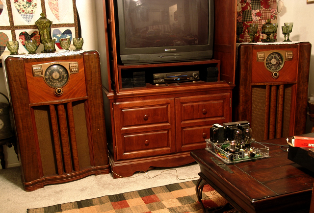

I made a nice pair of stereo speakers out of a matched pair of 1941 vintage Zenith consoles, one actually worked.......but I did save the original field coil speakers, baffle boards, and Wavemagnets (rotating antennas), and all other components that would be needed to return the radios to as found condition, the other radio did not work, but had a tasty pair of 6V6G tubes that played in my 6V6 SSE amp for a while, but got kicked out of their sockets by some grey glass RCA's, so they're back in the old radio.
These cabinets now house a pair of 15 inch Hawthorne Silver Iris coaxial drivers rated at 96 db SPL@1 watt. They are absolutely deadly when fed with a 125 WPC tube amp at full crank...open up the windows and go outside and mow the lawn without hearing the mower kinda deadly!
The CRT TV and the VHS machine tell you that this happened quite some time ago, about 15 years. The radios are still rocking the house, and all the parts are still stored in a safe place, but I don't see returning the radios to originality any time soon. Note the globe tubes (NX-483's) in the Lexan TSE on the table they are from 1929 and still crank out about 2 WPC on a bit more B+ than they are rated for.

The Philco cabinet has four holes on the front. Two were taken up by the power switch and volume. So I have two holes to cover up.
I decided that I should add a tone control. First, it takes up two holes, and second, it might help adjust the sound since the open back will be very sensitive to placement.
A tone control typically reduces the signal by about 8db, so I'm going to need to make up that gain. I didn't want to add another tube for such low gain. Fortunately, I have a 12v supply nearby and a stack of Toshiba 2SK170s that I picked up a decade ago. For those who don't know JFETs, think of them as a small triode. JFET J3 is biased by R17 and R21. In addition, R17 provides some feedback. R23 and R16 set the gain, which with the feedback ends up being 3. Unfortunately, this also allows about 90% of power supply noise to be injected into the signal. J4 is a source follower. J2 functions as a constant current source. Normally the source and gate would be tied to ground, but I wanted to cancel out any power supply noise. C12 and R1 form a RC high pass filter at about 7Hz that feeds 100% of the power supply noise to the gate. R22 is 10% of J2's internal resistance, this gives 90% of opposite current conduction.
The output feeds both the grid of one of triodes in the long tailed pair. This provides both signal and a nice DC offset that lifts the grid up to about 8v DC and provides plenty of headroom for the CCS.
It also feeds the tone stack. The tone stack provide a signal to the other triode in the long tailed pair, just at a lower level, basically feedback. The tone controls work backward though. Overall this is about the right level of gain.
