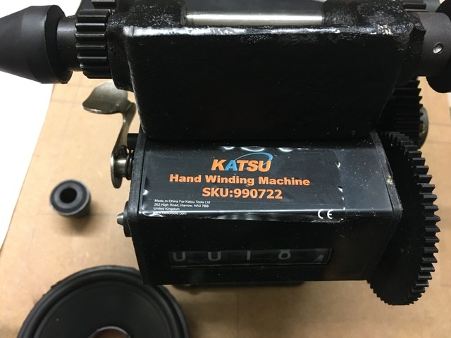

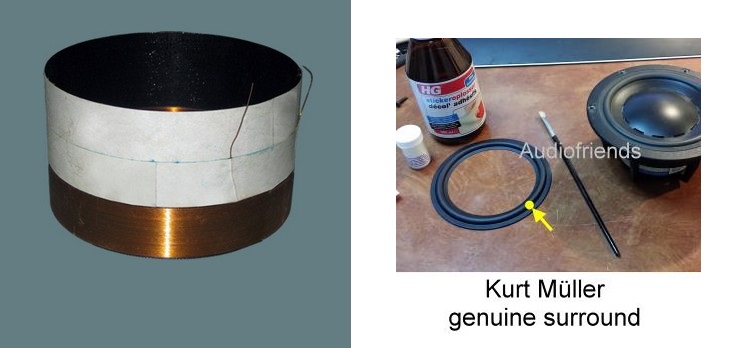

I did however blow a much loved speaker and so bought a winding machine from aliexpress to have a go with.
It’s a bit gritty and bit sloppy but I intend to have a go anyway.
Finding the right wire to replace the existing stuff seems to be the difficult bit.

I found this guy on eBay: Epo-Tek 353ND Professional High Temperature Two Part Epoxy | eBay

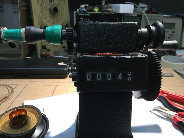

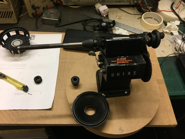

He is selling a single use 3gr blister pack of high temperature epoxy, I’m going to order some tomorrow when I get into the office but for tonight I stripped, cleaned, adjusted and oiled the winding machine.
Its’s not very good, pretty accurate on counts but sloppily and cheaply made. If I end up doing much more of this I shall invest in a better machine rather than bore out and re-bush this one...
It did however enable me to strip the wire from the voice coil and count the number of turns at the same time.
My coil had 50 turns of a wire 0.12mm across. I think this is 0.125mm metric and I have ordered some of that size magnet wire to compare.
The voice coil was loose at the top of the winding and this made it difficult to measure the winding height. I made it to be 6mm by eyeball guesstimate.
50 turns at 0.125mm gives 6.25mm, so I will be using that.
The next step is to clean the Kapton and roughen it for the glue, do I need to have former turned to a precise diameter for this or can I get away with doing it between centres?

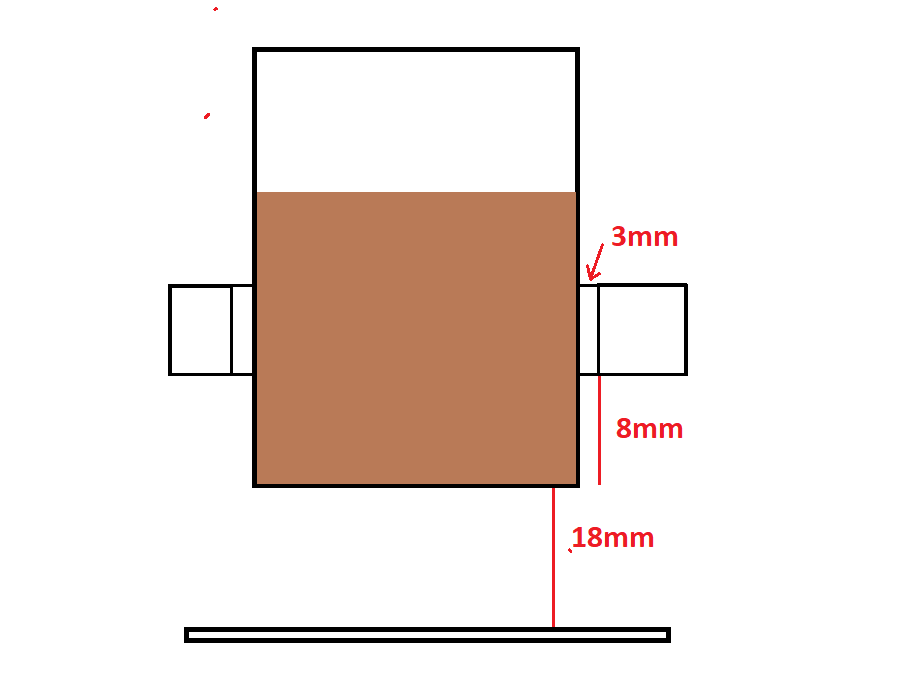

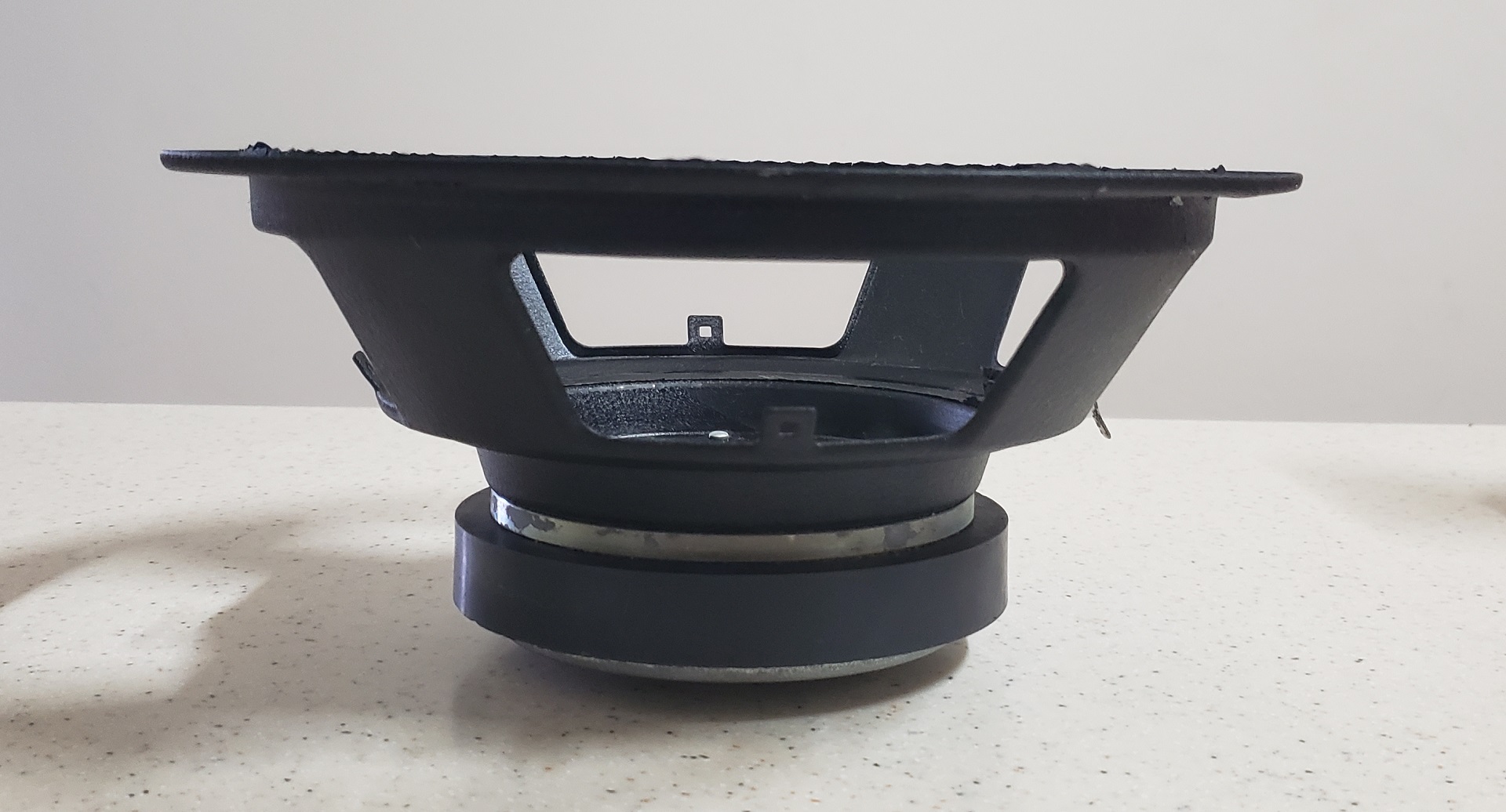

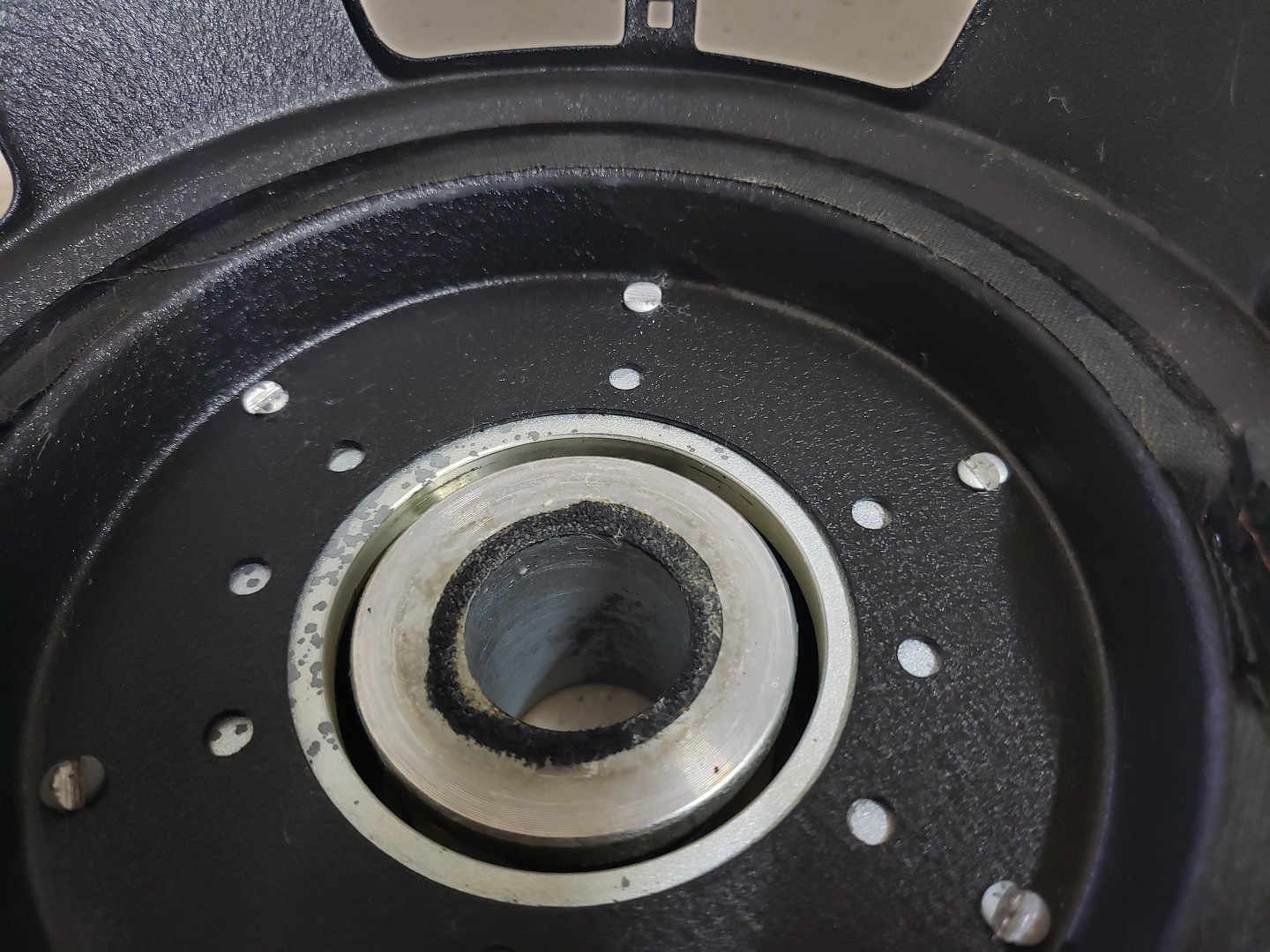

Ok, thanks everyone for your responses so far. I'll try to get to answer all the questions and queries below.
For some physical dimension info, here goes: The distance from the top of the gap to the bottom plate is 33 mm, the coil length is 23 mm and the rated Xmax is 8 mm, which puts the gap at 7mm (23-2*8). As the coil is wound all the way to be bottom of the former, that puts about 18 mm (33-(7+8)) between the bottom of the former and the bottom plate. The distance from the spider to the top of the gap is the same 18 mm or slightly more. This means that while there's a lot of space between the former. the former's going to bottom out before the triple joint hits the top plate, which is what I think led to the demise of this particular driver.
The coil is a 2" coil, and the gap width is about 3mm (it might be slightly under as the edges are slightly bevelled). The former is 42mm (1.65") high. The spider is 14mm (5.5") in diameter. The cone is 50mm (2" high).
Cone + Surround : 28g
Spider: 2g
Coil/Former: 35g
The driver was rated at 100 Watts, 8 ohms.
I'd really like to reuse the cone (which I've managed to successfully separate from the former), but I need a good way to remove the foam surround from it. Seeing that it's a plastic cone, bathing the joint in acetone is probably not the best approach, and then there's the challenge of removing the plastic inverted dustcap if that's actually required for properly aligning the voice coil in the gap.

And the biggest challenge at the moment is finding a replacement voice coil. Quite a few 2" coils available, but there's always one thing (former height, winding depth, the number of turns in the gap, etc.) that stops each one I've come across so far from being the best fit for this driver.
Of course all of this is going to cost way more than the original driver did, but I'm doing it for the experience, not to save costs 🙂

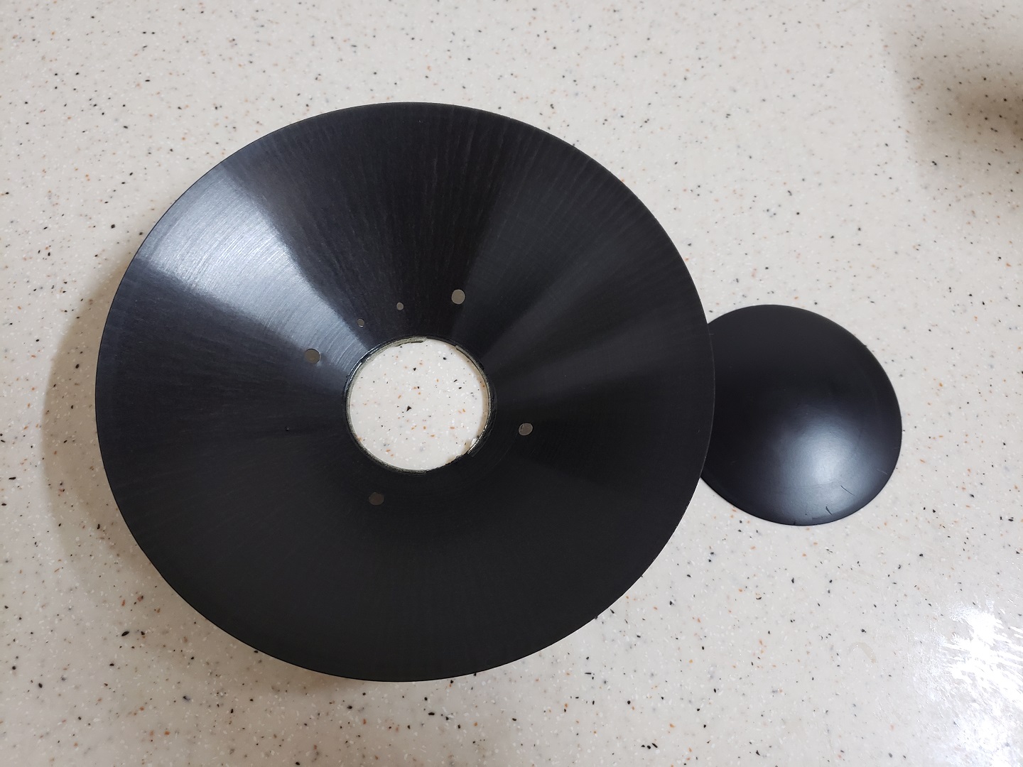

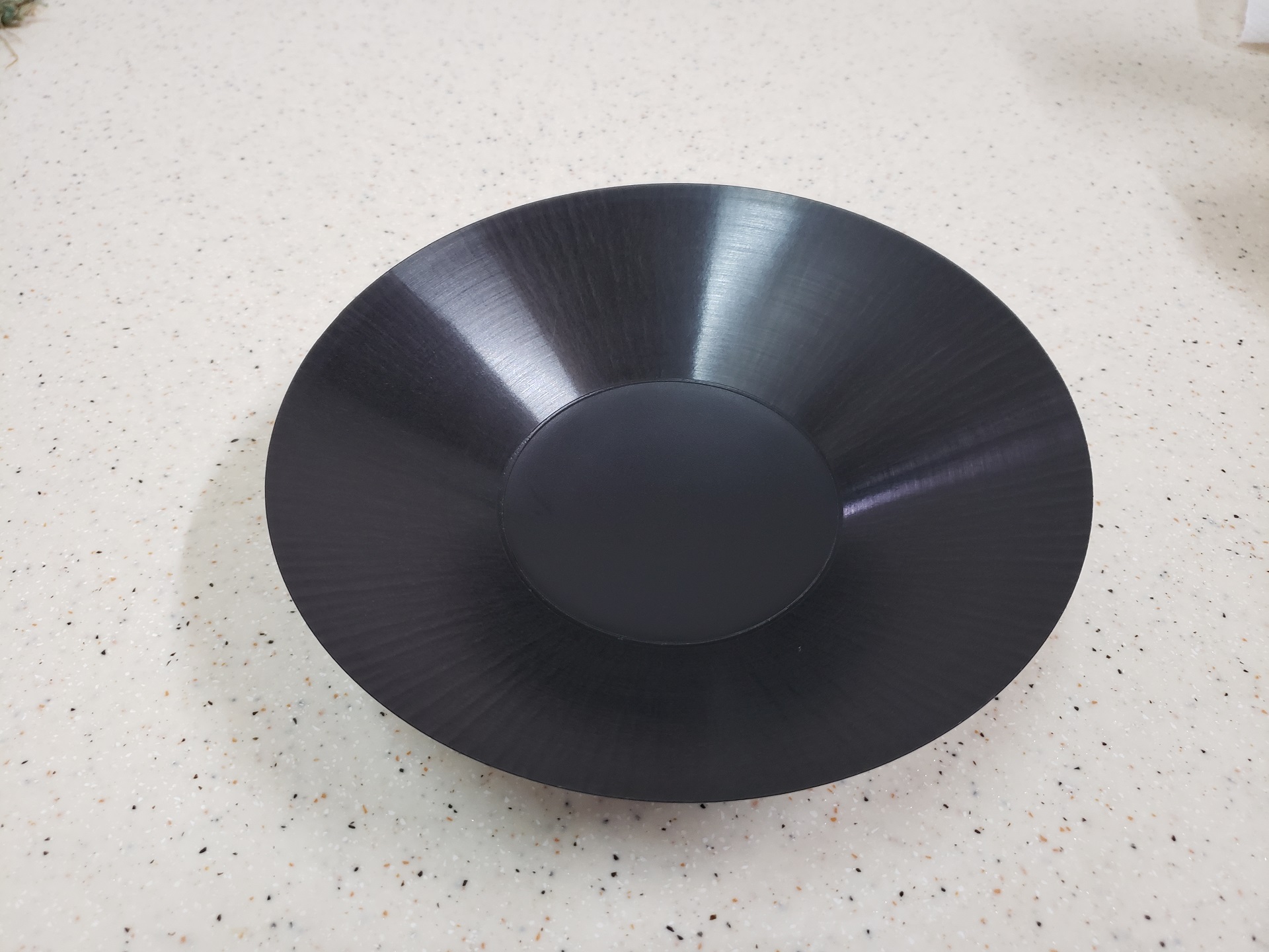

The challenge though is how to remove the original surround from the plastic cone without damaging it?
Well, I managed to find a way. On a lark I just sprayed the where the surround was joined to the cone with WD-40 and left it to sit overnight. The next day, the surround pealed off very easily, and any glue residue that was left was easily wiped off with a napkin soaked in WD-40. Washing the cone with detergent afterwards got rid of all of the WD-40. You can barely see where the surround was joined to the cone, which works for me as I when I rebuild this driver, I want to join the surround behind the cone, not in front of it.
The "glue" that was used to bond the surround to the cone doesn't appear to be a cyanoacrylate type, like what was apparently used to bond the cone to the former. It looks more like a silicone-based glue. And it looks like the same type of glue was used to bond the dust cover to the cone, so I'm going to try the same "trick" tonight to see if I can get the dust cover off, which I think will make it easier to align the coil in the gap.

Success - the WD-40 soak worked.
To finish the cleanup job, I'll have to remove the leftover cyanoacrylate glue at the base of the cone, but that's less critical and I'll probably just sand it off by hand or with a Dremel or something. That joint is going to be hidden behind the dustcap when I rebuild the driver (if I find a suitable voice coil, of course).

The driver is an Infinity 902-5861 10" subwoofer driver that was used in at least two of their commercial home audio subwoofer offerings. A search online brings up quite a few sites that supply replacement foam surrounds for this driver, but not much else.
