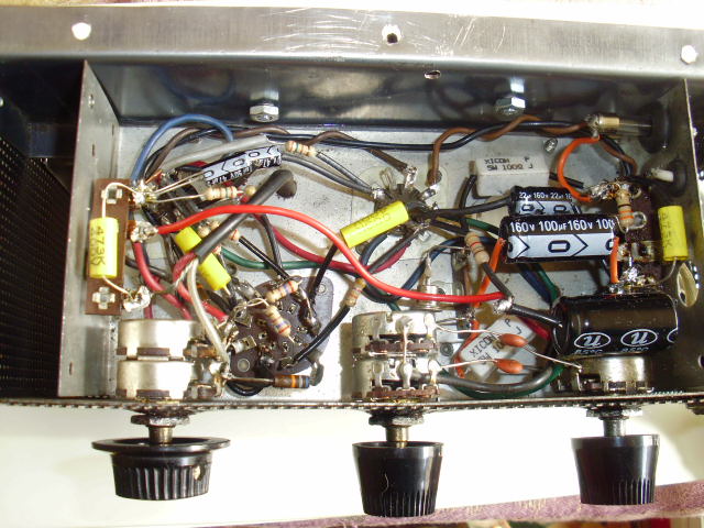

hi guys,
new here, this is my first post,,,, i just rebuilt my first amp,a little zenith 3L03, new caps, resistors, polarized cordset & stdp switch.... i redressed the filament leads, and put in a 3rd stage filter, to help get rid of teh hum,,, it works pretty well, the amp has crisp highs, but not a lot of bass, and it has some distortion, at high volume levels...
the distortion is what i'm trying to reduce now,,,the tubes all test very good ... i modded teh amp a little,,, replaced teh .01 coupling caps with .068, in hope of getting more bass, it helped a little, but seems to have maxed out there...
i replaced teh 150 ohm K resistors with 180's,,, and dropped teh 270K coupling resistors, to 220K,,,tried as low as 120K, to get more negative bias, but it didn't seem to change after 220...
i would appreciate any help i can get to get rid of teh distortion, or at least to understand why its there,,,
i posted teh original schematic,,, and teh chassis..
thanks for reading,
regards,
john

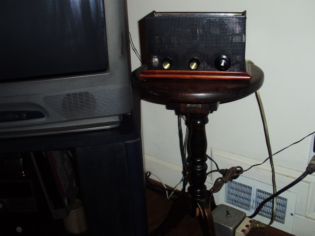

ok,,, heres a pic of the amp and teh iso trans is under the table...

thanks, also for teh link to teh "simple se",,, i have a 6v6 amp in mind, i have the tubes, and a chassis i built, i'm not really interested in pc board construction...
i sure hope this thread gets pointed to teh distortion problem i first asked about!!!!!

I see 2 issues that pertain to your distortion issue. First you state the output transformer has a 3.2 ohm secondary impedance, basically the nominal impedance of most 4 ohm speakers of the day. The 50C5 is intended to use a 2.5k ohm primary and using an 8 ohm instead of 4 will double the primary impedance (5k) causing 2 things to happen. 1) Power output will be reduced from the rated 2.3 watts to 1.9 and (2) the distortion will increase from the rated 10% up to 17%. These are values directly from the datasheet.
The second issue, you stated that there is only a bit over 5 volts on the cathode of the 50C5's. This either means the cathode resistors are the wrong value or your added filter in the B+ supply has reduced the plate voltage a fair amount. Both of these things would again cause loss of output power and increased distortion by changing the nominal operating conditions. For the cathode resistors use two 270 ohm in parallel. If your filter is reducing the B+ to much, I assume its a RC type, try using a much lower value resistor with a larger capacitor to restore B+ back up to 110-120 volts.

A list of the voltages at the plate/grid/cathode referenced to ground of each tube would be helpful as well.

K Grid Grid2 Plate
50C5 ,,,,,,,,,,,,6.6,,,,,,,,, 0 to -2 ,,,,,,,, 94 ,,,,,,,,,,,,,, 109
50C5 ,,,,,,,,,,,,6.6,,,,,,,,, 0 to -1 ,,,,,,,,, 94,,,,,,,,,,,,,,, 109
12AX7,,,,,,,,,,, .6,,,,,,,,,, 3.6 ,,,,,,,,,,,,,,,,,,,,,,,,,,,,,,,,,,,, 48.3
,,,,,,,,,,,,,,,,,,,,,, .6,,,,,,,,, , 4.0 ,,,,,,,,,,,,,,,,,,,,,,,,,,,,,,,,,,, 48.4

I posted the "new" voltage readings,,,they are actually closer than i originally stated,,,
i read K voltage between pins 1 &2, due to an article i saw.. it seemed to throw everything off... the new readings are accurate...
I'd hate to loose the balance control, due to teh room layout,,, maybe replace it with a new one?
Let me know what you think of the tube readings,,, don't want to start changing stuff, until its sorted out..,
