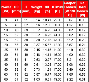

I'm about to order a toroidal transformer for a small project and I wondered how much of a derating is reasonable to keep heat in check.
I usually overspec the xformers I order by aiming for a continuous draw at around 60% of their rating.
In this case, the amp will consume 2.8A @6.3V for the heaters (on AC, so a resistive load) and about 80mA DC (from a 140VAC secondary) at iddle for the B+. For a bridge rectifier with cap input, on average, the ac current is 1.8* the DC current drawn. So, at the very least, I'd need a 40VA transformer (2.8*6.3 + 0.08*1.8*140=37.8).
As a reflex, I'd go for a 63VA xformer, at something like 6.3V/4A, 140V/270mA. But would it be really unreasonable to go for a 50VA (6.3V/3.5A, 140V/200mA)?

You're even more conservative than I... A 3times ratio usually gets me barely warm toroidals. The 3 times ratio comes from the 1.8 ratio in between IAC and IDC for a cap input bridge rectifier (given by manufacturers such as plitron), combined with the 60% load aim. Nelson Pass suggest using twice the VA for a given continuous load on the DC side, which is about a 2.8 ratio IAC/IDC.

Just for info, I attach the specs of the xformer I'm looking at. They're class B rated btw (max 130°C).
