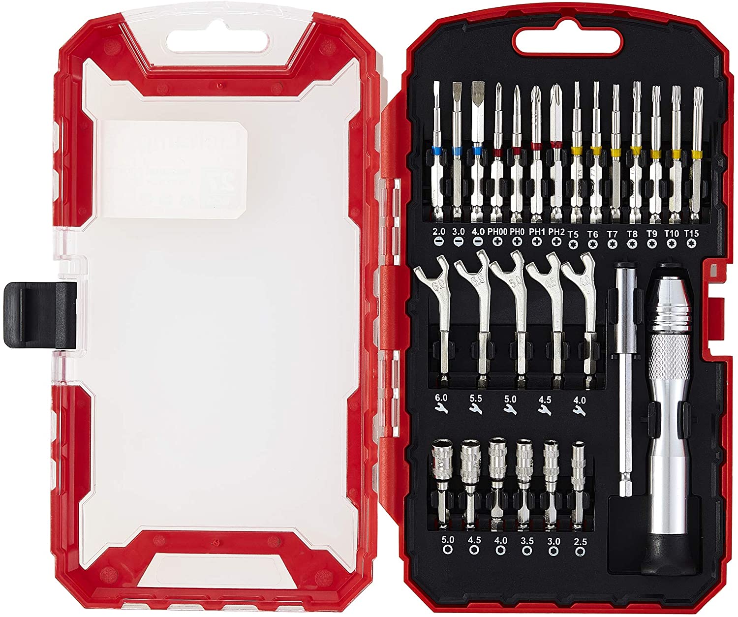

I was hoping to to remove the nuts on the pin to loosen the jaw. I tried with a small plier but it won't do. I don't have (and never seen) a wrench that tiny

You might have some luck using something like an ice pick to bend the contacts slightly so they don't grip as tight. A small nut driver should work to loosen the nuts.

...I don't have (and never seen) a wrench that tiny....
"Ignition wrench set". Amazon easily finds down to 4mm and 5/32", even 2.5mm.

Thanks, I don't know what they are called. I actually have a set but the smallest only goes down to 4.5mm. By eyeballing it it looks to be the same size as my 3mm hex key.

After the oven, an unexpected outcome was I was able to loosen the nuts holding the metal contact. It turns out the tension is perfect. The problem is the center guide hole is too small.
