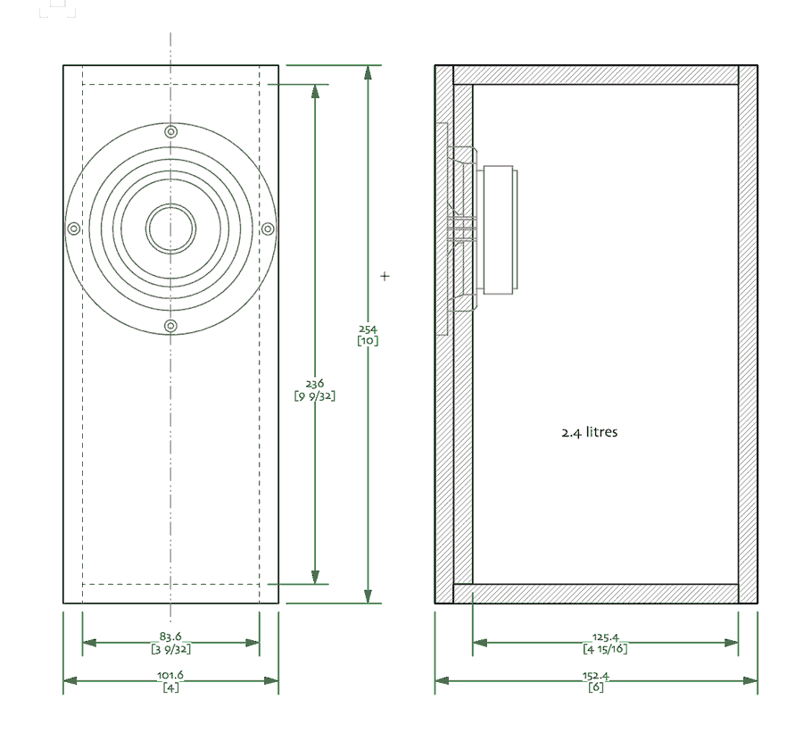

With outer sides in 9mm you could fit any of the FF85wk, Alpair 5.2/3, 3F22…
Drawing the box out yo have 2.4 litres with room for a small vent. The vent will differ depending on the driver you choose. Alpair 5.2/3 barely fits.

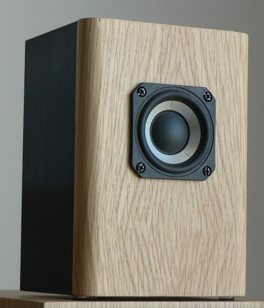

I built out a pair of Montello speakers for my wife's home office computer w/ Fountek FR88EX 3" Full Range speakers. You will not be disappointed. They sound great, fun build too if you have access to some wood working tools or a friend who has or a wood working shop. Do a small burn in with them.
