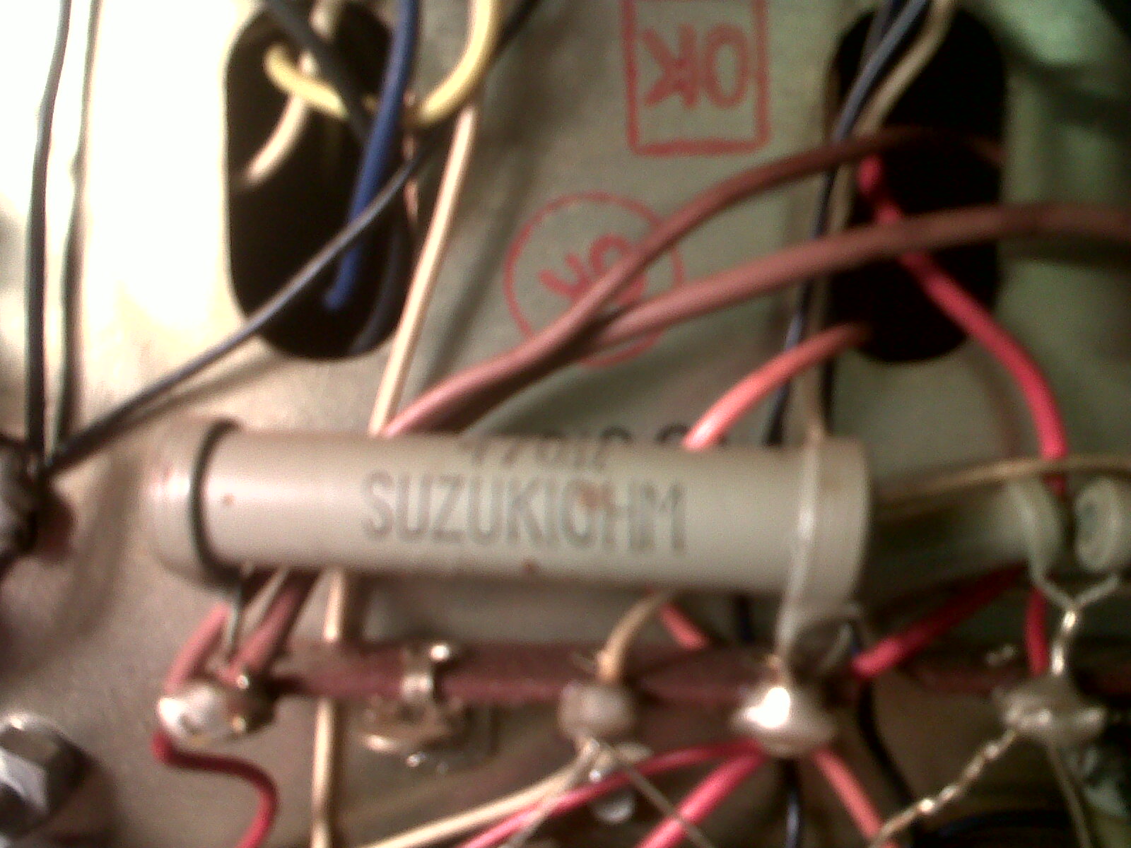

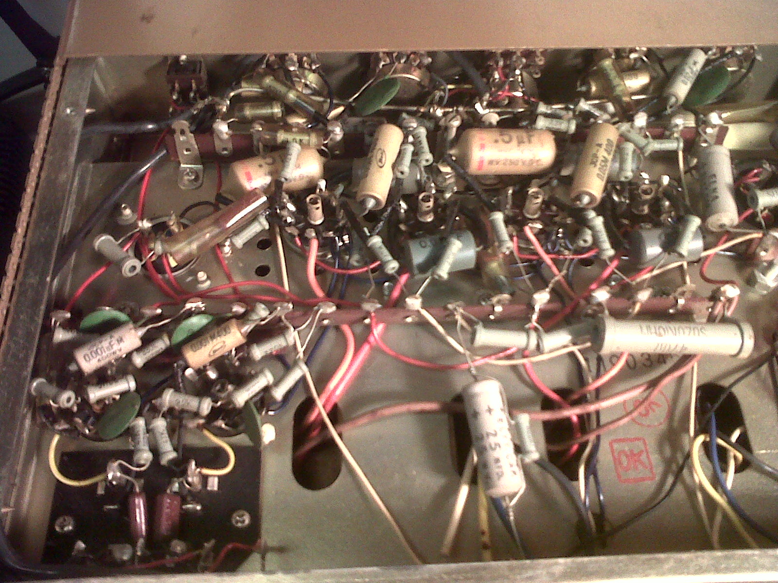

The coupling caps in these amps are good sounding, but incredibly leaky paper things that must be replaced if the amp is to be reliable.

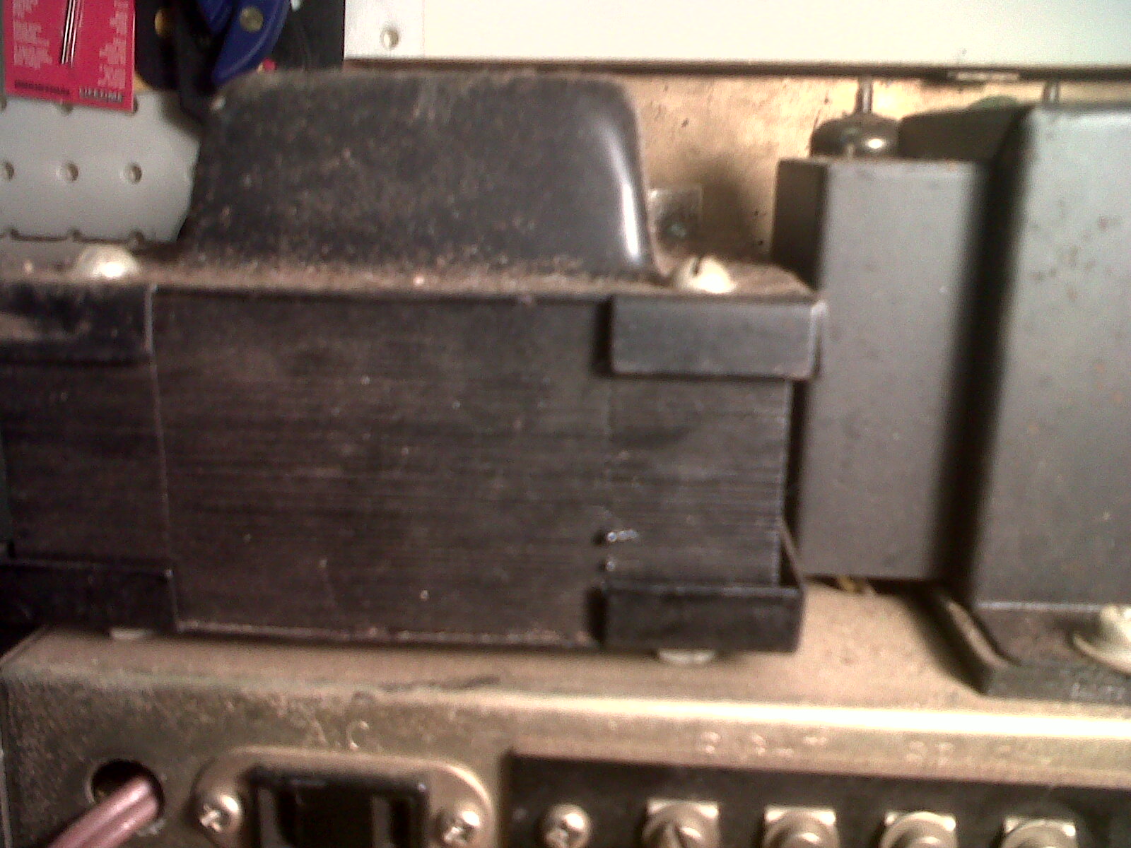

Don't know who made the OPTs in these amps, but they are tiny - and perform way, way better than they should. Rumors abound that the cores are actually something special like permalloy. Can't really confirm, but the lams are very thin and there are a great many of them.

Kevin's remarks lead me to believe that the R/S unit might be related to the Sansui 500. That receiver uses 6BM8 "finals" too and the paper in oil (PIO) coupling caps. employed are notorious for leaking. Those caps. should be replaced by Soviet surplus K40s.
When the unit arrives, definitely take a look and jot the tube complement down. Under no circumstances should the unit be plugged in. A variac is needed to slowly ramp the voltage applied up. The filter caps. need reforming, at a minimum, and rate to require replacement.

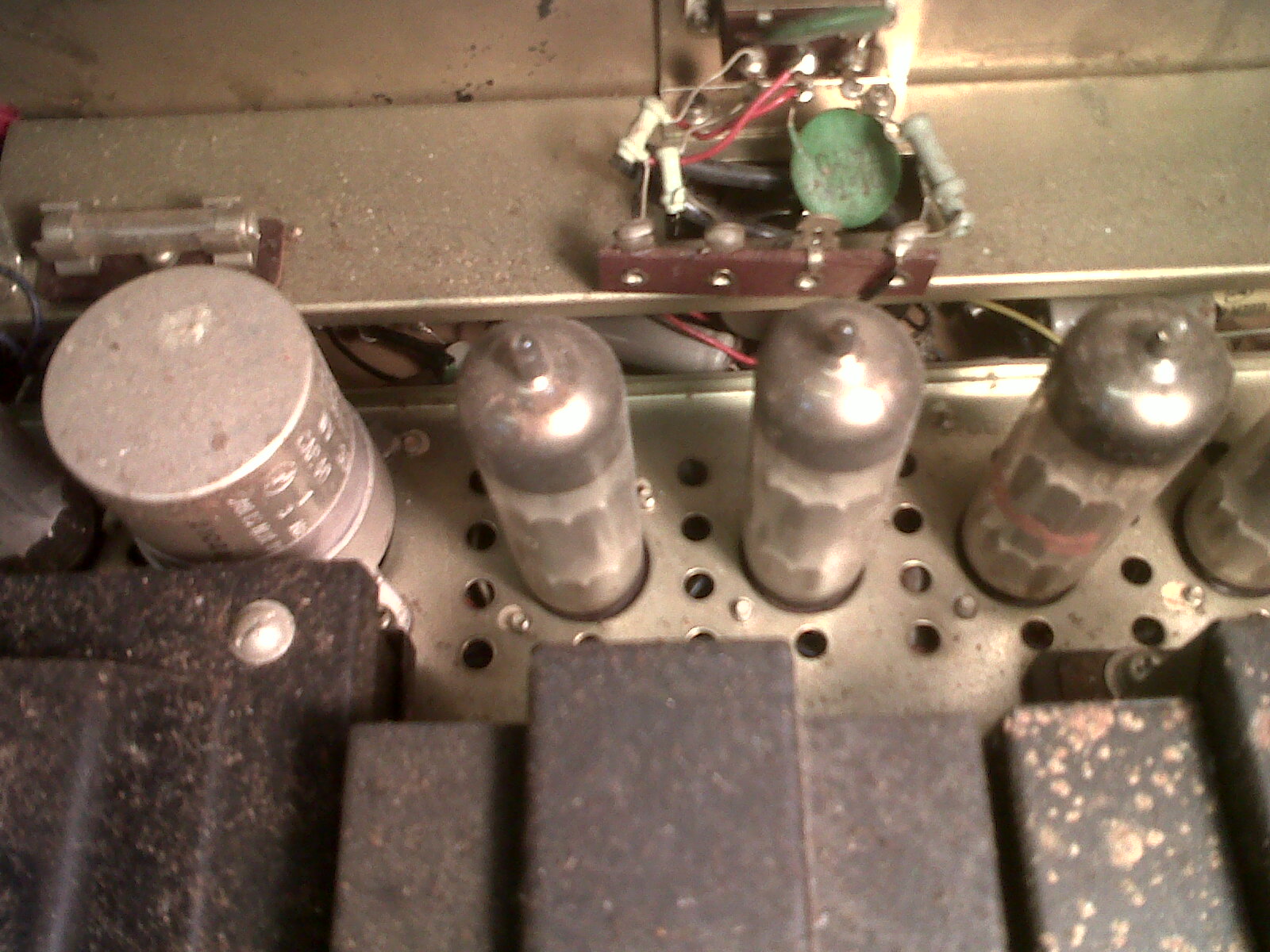

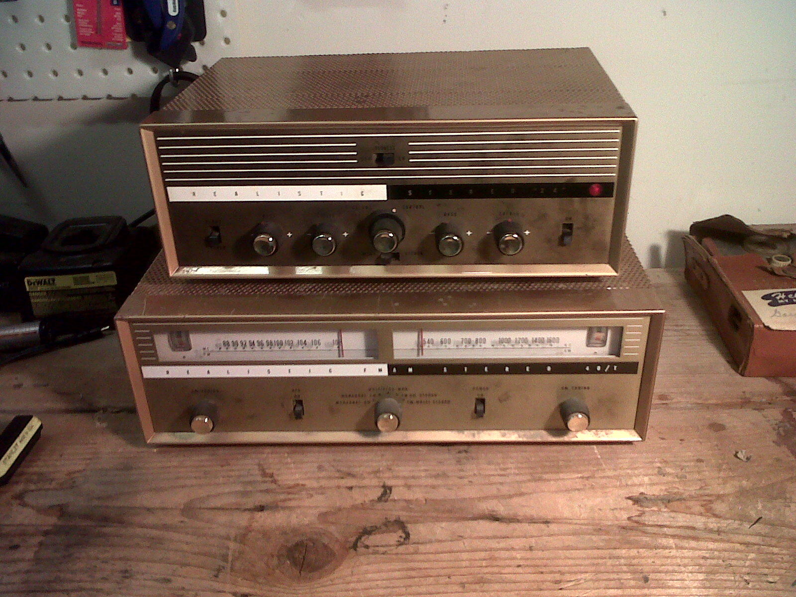

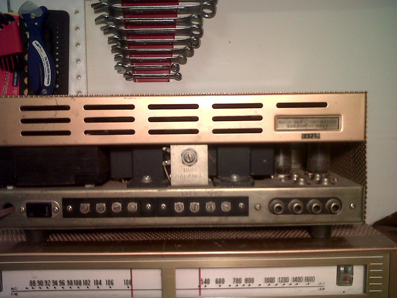

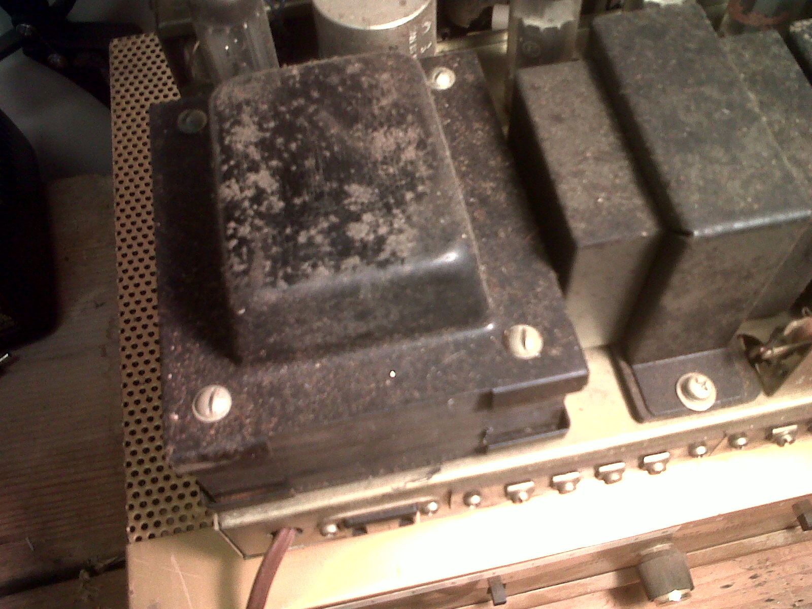

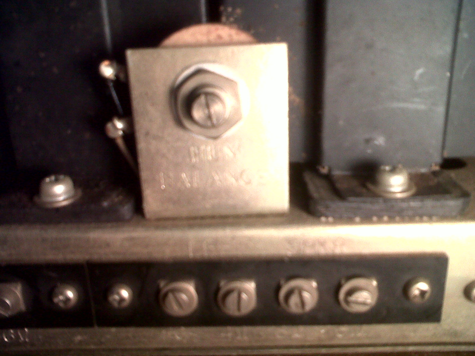

Well, I can't tell what transformers it has; nor much about the design. Of course, I am an industrial engineer, not electrical. It has a bias control on the back, I think - it is labeled "hum balance"...?
Still, it looks solid and quality, overall...thoughts? I am taking it to my tech guy for a good overhaul...the receiver below it is a 40/T I will revamp eventually.

The 6CA4 is the B+ rectifier. The 6BM8 is a small signal triode and a power pentode in a single envelope. The likely 6BM8 topology is common cathode voltage amplifier DC coupled to a "concertina" phase splitter and on to PP "finals". Finally, the 12AX7 triodes are used in the phono section (1 tube/channel).
Do you see anything that looks like SS rectification, which would be used in a DC heater supply for the phono section. In a bottom of the line unit, like this model, expect AC heating in the phono section, which is undesirable, but can be made to function tolerably well. Buy a pair of phono grade Sovtek 12AX7LPS tubes from Jim McShane, as part of the restoration. The 'LPS has a spiral wound, hum bucking heater, that can easily be the difference between a listenable phono section and an unbearable state of affairs.

It's not the bottom of the line Radio Shack unit from that era, but about the middle of the range, and can sound great - in fact it is one of the best sounding stereo amps in the early Realistic line up. I had one in an office system and it was very pleased overall with its performance. It had a very warm liquid midrange, overall smooth vintage sound, and what could be described as slightly flabby bass probably due to the old electrolytics in the supply, and very nice extended highs. It imaged very well. Very synergistic with the Paradigm Atoms I paired it with. (I never heard them sound better frankly)
The transformers are proprietary to Technical Apparatus, Inc., not sure who the OEM for those transformers were - it could have been Hashimoto, or anyone else for that matter. (You'll not find out by looking at them, and do not disassemble unless necessary as they can be fragile from age.) They are of sufficiently good quality to justify doing a restoration on this amplifier. The phono stage is relatively mediocre by today's standards, but will suffice for casual use.
Post a photo of all 3 trafos and get some feedback from this site's "iron" experts (not me). I'm guessing the leftmost trafo in the image already posted is the power trafo, but let's be sure.
It is.. As noted there is little or no reliable information on these transformers, but they are just fine performers as I noted in my previous post. This amp is worth R-e-S-t-O-r-I-n-G..
There is a SAM Photofacts for this amplifier IIRC.
