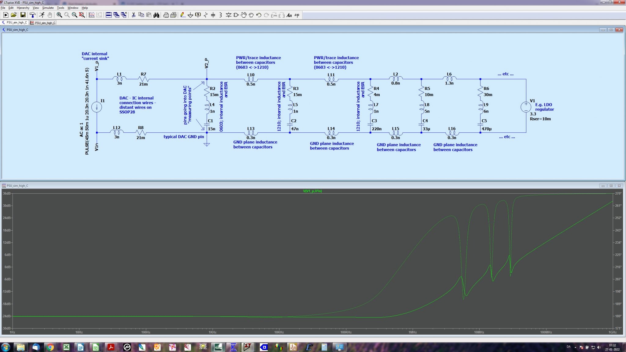

I have for some time now been trying to set up a realistic ADC/DAC PSU decoupling capacitor LTSpice simulation model that will give a quite realistic impression of what a given selection of decoupling capacitors will look like electrically.
I have attached a copy of the model I currently use (based on Saturn PCB Design toolkit estimations for trace inductance, - etc.), however, I am unsure as to how to model the internals of the ADC/DAC itself ... ?
Also, when modeling the DAC/ADC power draw as a variable current source, it looks as if the damping brought about by the decoupling capacitors is quite limited - only - 24 dB at lower frequencies and already at ~ 13.5 MHz the attenuation is 0 dB.
I reckon something is amiss here and it would be great to actually have a simulation model that can be considered realistic. Thus, if you have any experience with - roughly - simulating ADC/DAC decoupling capacitor network I'd appreciate your input.
BTW the attached simulation model's DAC pin specs are based on the distant wires (from pin 1, 14, 15, 28 to internal silicon) of an 28 pin SSOP package.

Just two comments, neither of which answers your question:
1. Regulator outputs are normally quite inductive. That's due to the loop gain of the control loop falling with frequency.
2. Murata has some very extensive lumped models for their capacitors on their website. They don't include the capacitance reduction with non-zero DC voltages of class 2 ceramic capacitors as far as I know, but all the resistive and inductive effects are included. The schematics are complicated and poorly readable, so I guess they are automatically generated from measured s-parameter data.

Hi Marcel ... well, thanks for your feedback although, as you write, it doesn't really solve the "challenge" with simulating this realistically. Even with better models I reckon that this basic simulation model's shift from decoupling to "amplifying" the noise at 13.5 MHz would still be there - and I just doubt (hope?) that this is the way it is (supposed to be) ...
When searching the literature and recommendations for decoupling it seems that there are two main approaches to this:
1. To use one or more capacitors with the same value ideally selected to have the lowest impedance at the fundamental/base frequency of the circuitry PSU "noise", i.e. for a DAC with a sampling frequency of 192 kHz (12.** MHz clock) then a possibly feasible choice could be the ubiquitous 100 nF capacitor.
2. To use more capacitors of different values to decouple the circuitry at different frequencies - optimally to achieve an equal impedance throughout the relevant frequency spectrum. This is what I have tried to simulate in the simulation above with (I reckon) quite realistic values for inter-capacitor trace inductances etc.
The basic issue I suppose is that whereas approach 1. may filter the base frequency (100 nF has an impedance low at ~ 12 MHz) then it is relatively inefficient at higher frequencies - where the PSRR of the typical ICs also drops. Meaning that a good portion of the higher harmonics of the digital signals related to an IC ADC/DAC may only be partially decoupled.
Approach 2 might be more efficient at filtering a wider range of frequencies, however, if the decoupling/amplifying point is at ~ 13.5 MHz I suppose something is not correct with the model.
I could & do build test circuits but it would just be so much simpler to be able to simulate potential solutions without the building phase ... And to this end have a simulation model that realistically models what the damping would be a different frequencies ...
Are there no others here on diyaudio that have considered this to be a challenge/an issue - and have tried to realistically model a solution? Or might I be missing something here ... ?

Apart from the regulator, I think the main weakness in the model is the frequency-independent ESR of the capacitors. That would correspond to a tan(delta) that is proportional to frequency, but capacitor datasheets often show a tan(delta) that is nearly frequency independent. Besides, if the reference and its return are on adjacent IC package pins, you would normally get a coupling factor of about 0.5 between their inductances.
Nevertheless, it is true that capacitors in parallel with wires in between can go into parallel resonance.

Just curious, are you assuming that there would be both a capacitor after the regulator, and also near the dac chip?
Hi & good morning to you both ... Well, I/we actually just came out of a weekend where we've had a hurricane pass over Denmark with wind speeds reaching 40 m/s (aka 144 km/h !). Somewhat humbling to experience such an unabated wind & nature at full (?) force ... Fortunately no major personal harm done but since Denmark is a sea-near country there are many people facing real challenges when the sea level rises (more than) two meters above normal reference level ...
Anyway, returning to the subject ...
@phase: Yes, there would be capacitors both near the LDO & the DAC chip - and here assuming where you are heading with your question ... that may add some inductance to the trace from the LDO to the capacitors, and an additional capacitor (e.g. 4.7uF with an LT3042). However, it doesn't really change things as seen from the DAC perspective as far as I can see, i.e. V2_P & V1_N & V2_P simulation values are very close to being the same. Did you have something particular in mind?
@MarcelvdG: Thanks again, Marcel, for your feedback. A little bit puzzled by parts of it, though ...

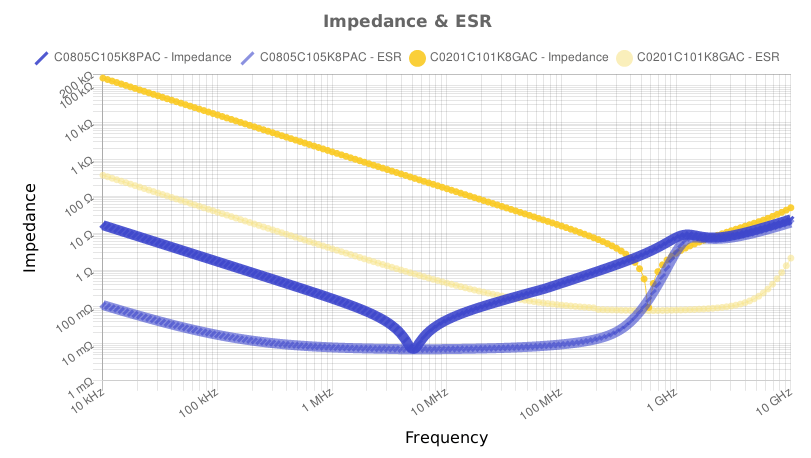

https://ksim3.kemet.com/capacitor-simulation

Referencing a capacitor data sheet (that I would consider relevant in my context) I notice that KEMET only specifies tan(delta) at 1 kHz for sizes greater than 1nF - at least in this datasheet. That would be a less than useful specification unless there is a reliable way to extrapolate this value to higher frequencies ... here I am thinking that it would be feasible to get an idea about how much the influence of tan(delta) actually is in a particular situation .. Thus, would you happen to know e.g. what the tan(delta) for a 100 nF C0G 1210 capacitor is at, say, 25 MHz (or another capacitor you know of)? Also, to this end, would you think that the tan(delta) aspect is included in a simulation tool like this one from KEMET:That would correspond to a tan(delta) that is proportional to frequency, but capacitor datasheets often show a tan(delta) that is nearly frequency independent.

Regarding tan(delta), it depends on what frequency range you look at. In that KEMET tool, you see the ESR drop more or less proportionally with the capacitive reactance (near constant tan(delta)) until it becomes more or less flat (constant ESR). If your resonances are all in the constant ESR frequency range, then my comment doesn't apply.

I will try this and also your suggestion for a resistor to GND from the power supply rails. And now in relation to post #15:
or to the presence of ferrites intended for power rail isolation. I am guessing the issue with ferrites could be related to hysteresis noise/distortion, but have not tried to measure it.
In my simulations ferrites appear to be a double-edged sword. On the one hand they do isolate sub-circuitries from each other, on the other hand they appear to shift the overall response on the "inside" of the ferrite towards less efficient filtering, thus higher noise levels. Sometimes this has made me think that many/most digital circuitry design optimization texts really are aimed for strictly digital circuitries where signal integrity (often) is the most important parameter.
Jesper
Do you have a particular Rubycon SMD in mind?
The one that Diyiggy recommended is one that I tried. Its 805 size, .22uf (which is the largest value Rubycon makes in 805). Because 805 is a little on the larger size for RF bypass is one reason I tried to avoid adding via inductance in series with it. Also, maybe trying to keep bypass transient currents more on the surface can help keep the ground plain a little more clean as other devices see it. Its sort of like what InspectorGadget showed for his opamp bypass strategy, although sometimes I have tried making the via power return path from the surface to the ground plain a little longer than the bypass cap current path. IME some experimentation may be needed to figure out things not in the typical textbooks for strictly digital circuits. As always YMMV and or others may disagree with my personal opinions.
Regarding using the Rubycon SMD caps in the audio path, I usually wouldn't want to do that. However, AKM used them for passive RC filtering of RF noise after the I/V op amps in AK4499 evaluation board. They seem to sound okay used that way -- small values for a little filtering above the audio band.
EDIT: Would also mention that Rohm uses 10uf Rubycon SMD film caps for their BD37201NUX voltage regulator output caps. They have an application note on using ceramics instead, but they are looking for a particular capacitance and particular ESR for regulator stability. Finding a suitable ceramic cap is up to the circuit designer.
Thanks again, Mark, for your feedback 😉
Ah, ok. To my memory the 0805 size is actually the highest inductance of the sizes (likely) relevant for e.g. DAC decoupling. Typically 1.6 nH whereas e.g. 0603 and 1210 both are around 1 nH. 0402 is even lower but at least for me this size is a no-go unless it's imperative from a design point of view.
Hmmm ... yes, I reckon that with many mixed signal designs there is a balance to be arrived at between good coupling of gnd sections (=same reference levels) and somehow isolating sensitive parts from undesired disturbances like digital gnd plane currents.
Different, yet with a similar scope, I am currently experimenting with different layouts for a low noise DAC regulator where I have isolated the two main GND reference areas - and then try to connect them in various places around the PCB with a wire so as to avoid that these GND areas interfere with low frequency GND return currents in the GND plane. A bit surprisingly the differences are not huge - except for one case on the order of probably a few dBs - something which I tend to attribute to the advantages of a GND plane where impedances are really low.
Hmmm .. sounds interesting. Would you happen to have a link to e.g. a post showing this?
I reckon I was imprecise in my wording here: I don't use the rubycons in the signal path but I listen to them "in series" in order to get an impression of their sonic imprint. However, I have read about what might be called the "inverse rule", i.e. if a component sounds e.g. "bright" in series with a signal (in the signal path) then it may sound "dark" if conversely connected in parallel with the signal path. An intriguing thought though I haven't had the time to try this out yet ...
BTW: I also noticed that in MarcelvdG's thread on an RTZ DAC you mentioned Marants' SA-10 service manual. Any chance you have a link to the service manual - or just the schematic? Could be very interesting to see the schematic of their DSD implementation.
Cheers & have a good day,
Jesper
Jesper
Don't recall where I found the SA-10 service manual for free. Just put a copy in my dropbox: https://www.dropbox.com/s/0p1s1sew5inxlmu/SA-10, SA-10S1 Service Manual Ver 5.pdf?dl=0
IIRC, InspectorGadget posted an image of the opamp bypass scheme only once and in some thread I don't recall exactly. From memory, basically the + bypass ground return path was on the surface along an area of fill that passed underneath the opamp to a square patch of small ground vias just past the end of the opamp nears pins 4,5. The negative bypass path was to the same set of ground vias. That scheme allows for a bypass path from positive to negative, not just to ground, it allows for an accessible place to put a scope ground to check for bypass cap ringing, and it puts the bypass ground path back to the ground plane closest to the negative opamp power pin, which is effectively the reference pin, at least for most opamps.
