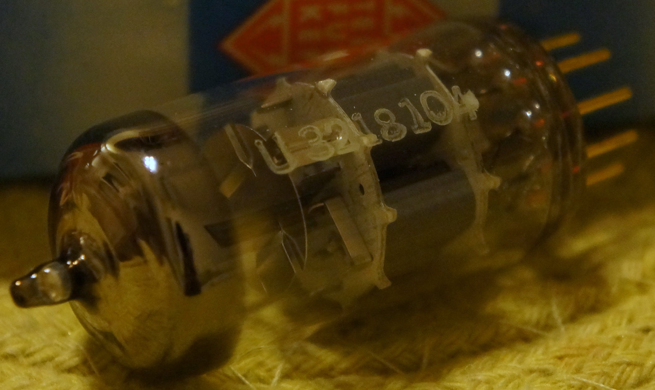

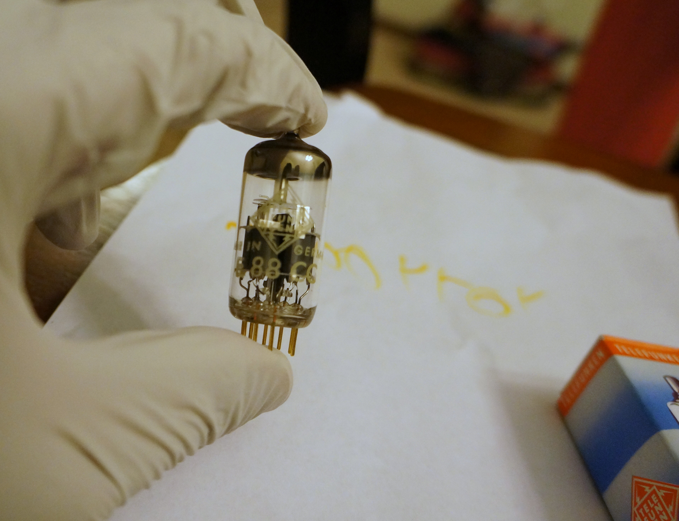

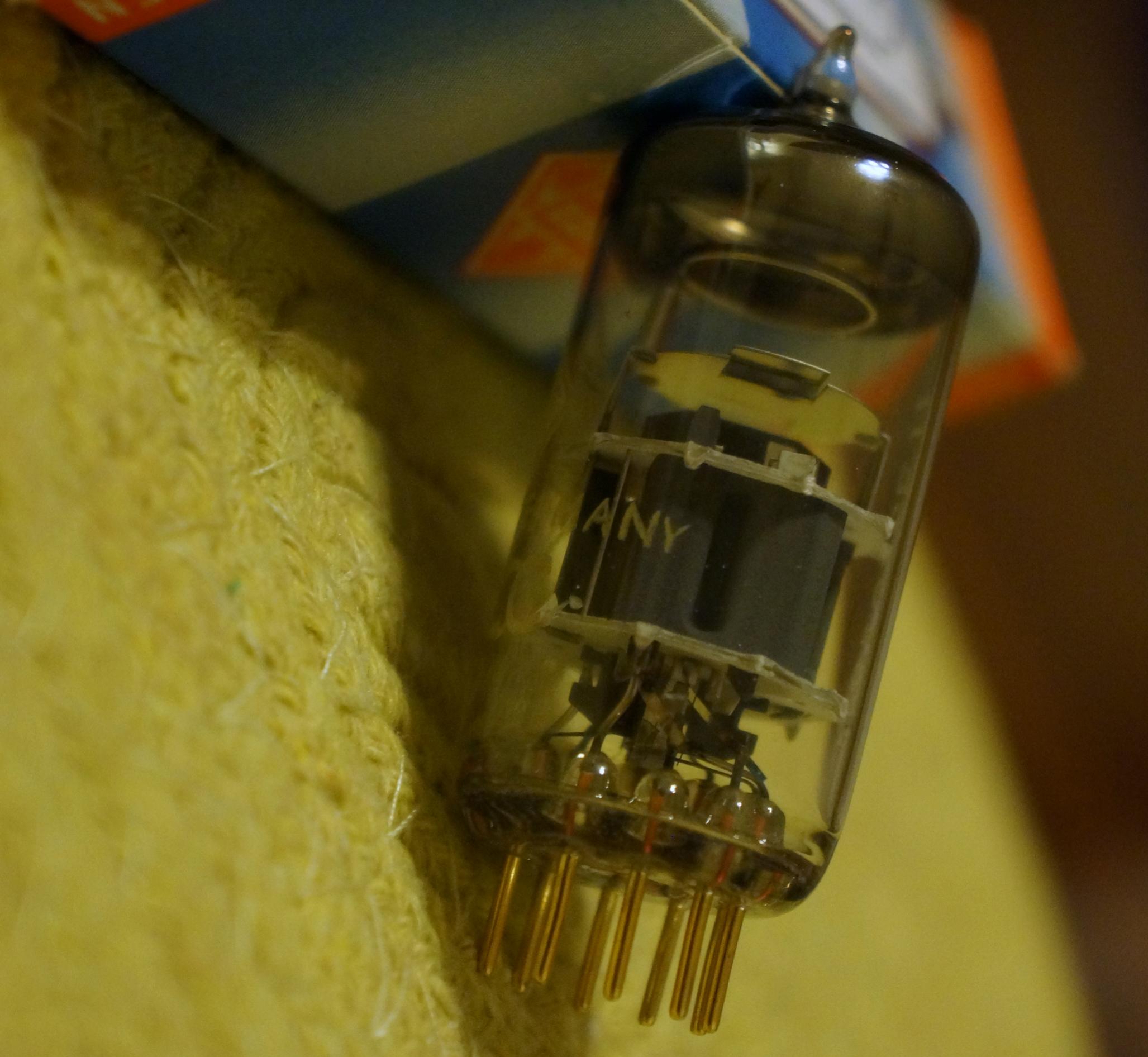

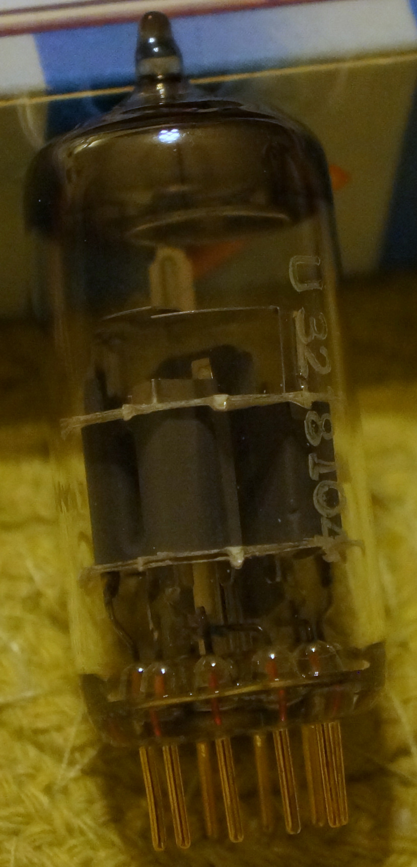

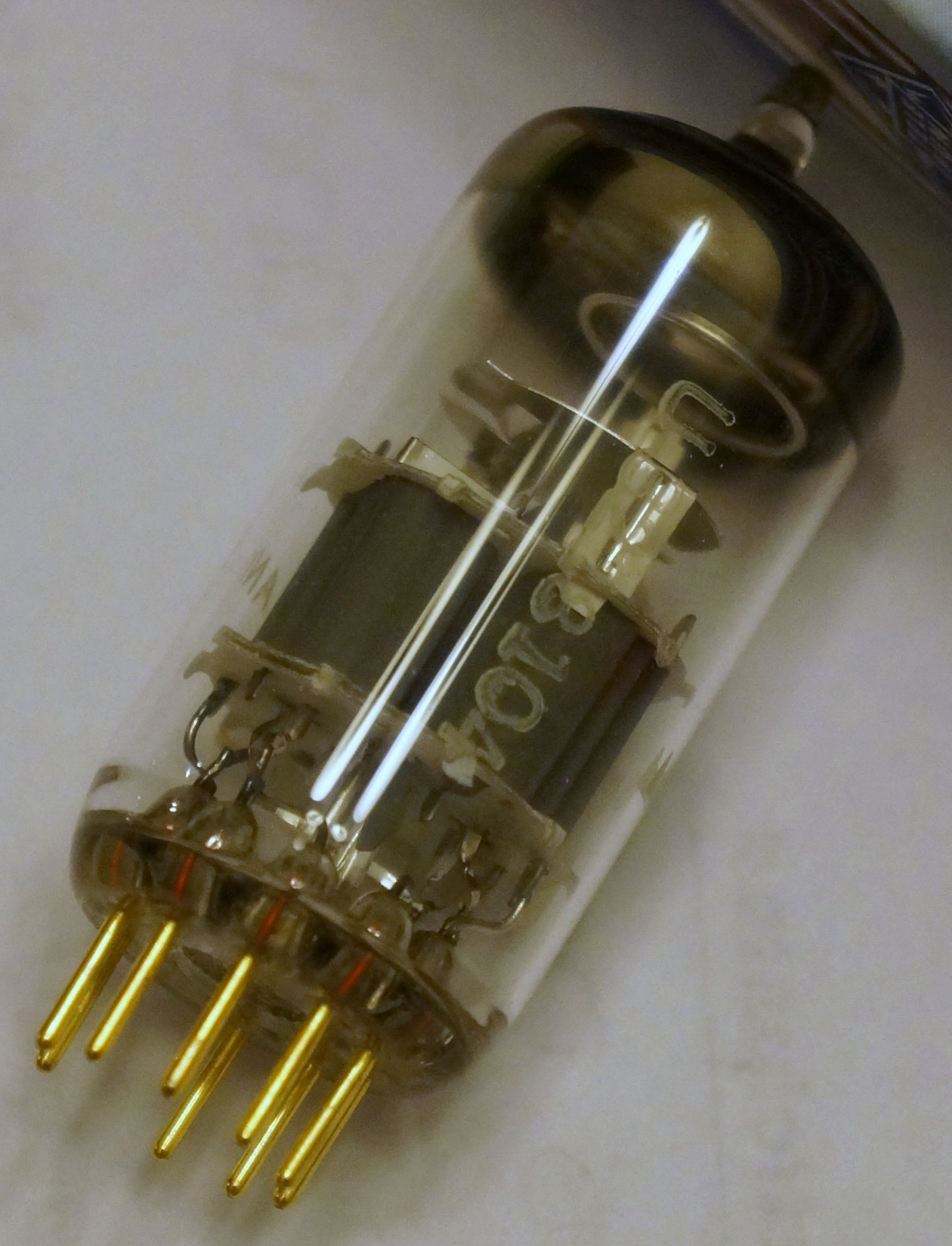

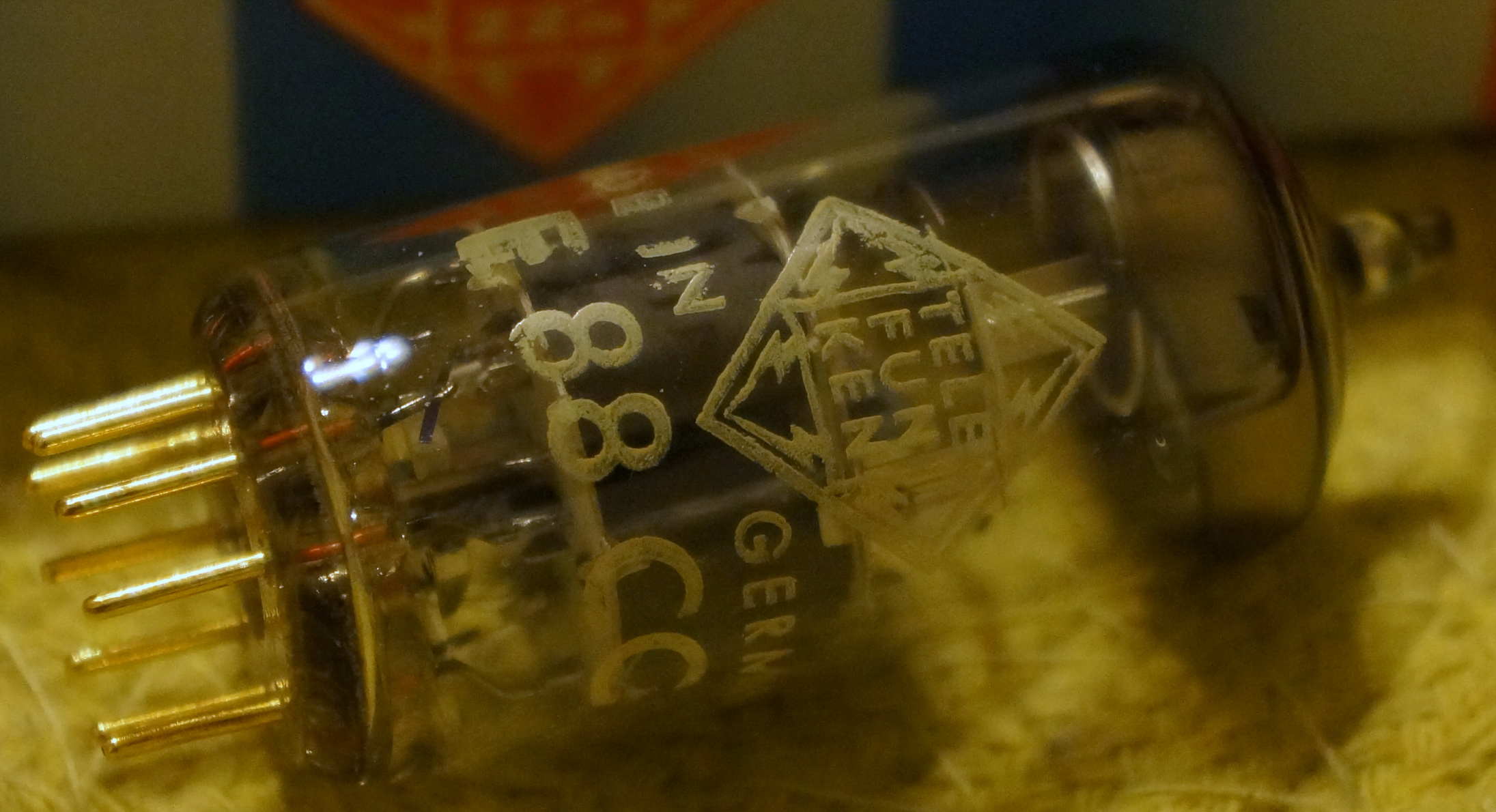

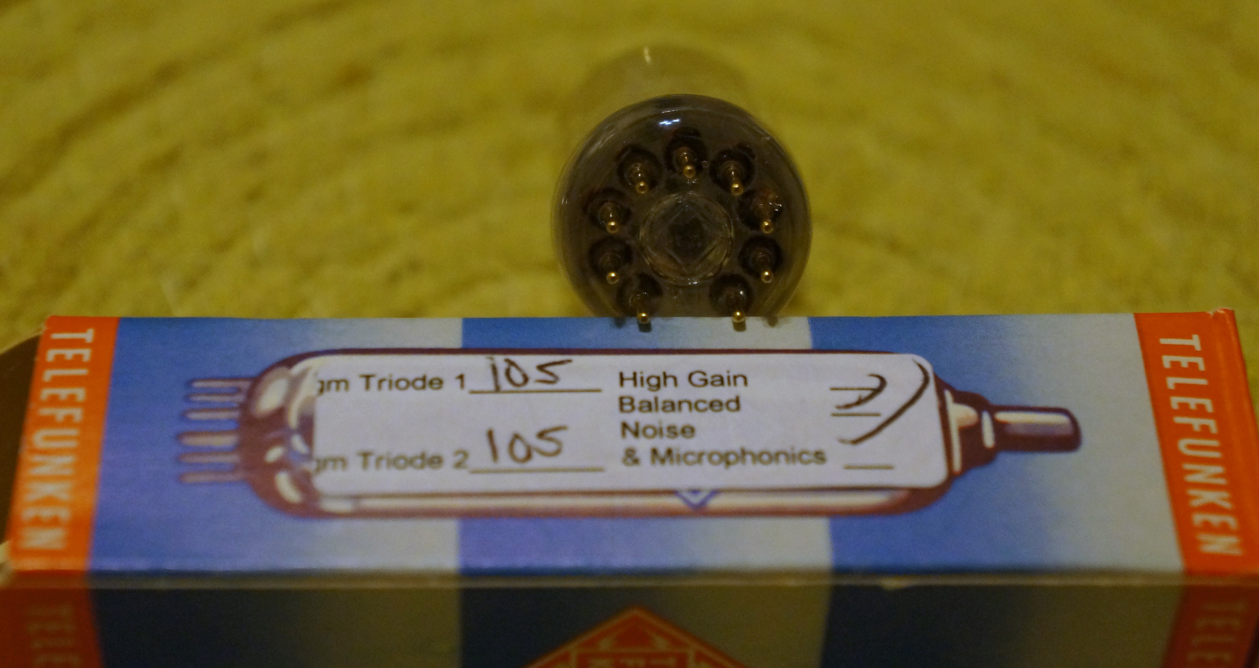

Hi All:

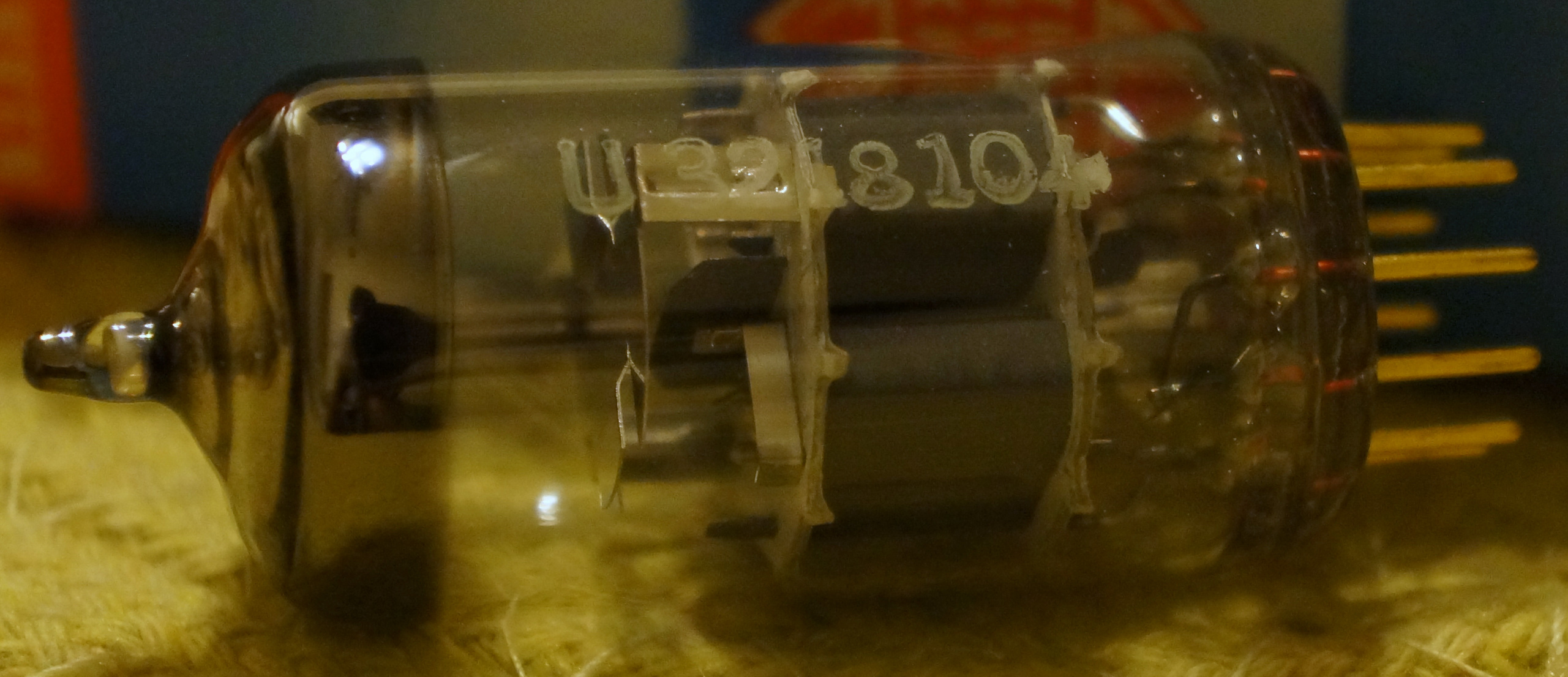

I just bought a Telefunken E88CC from a big online store. It has yellowish/pale white markings instead of usual white that Telefunken use. It has a diamond on the bottom. The box looks new and crisp. The marking paint does not get smeared if I rub the marking with cotton shirt. The date code is U3218104.
Please help me decide if it is a genuine Telefunken E88CC? The solid pale paint is making me suspicious🙄.
Thanks!

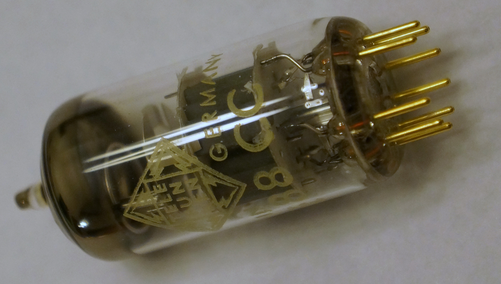

You can find some very nice pictures of the Tele E88CC on:
TFK-E88CC

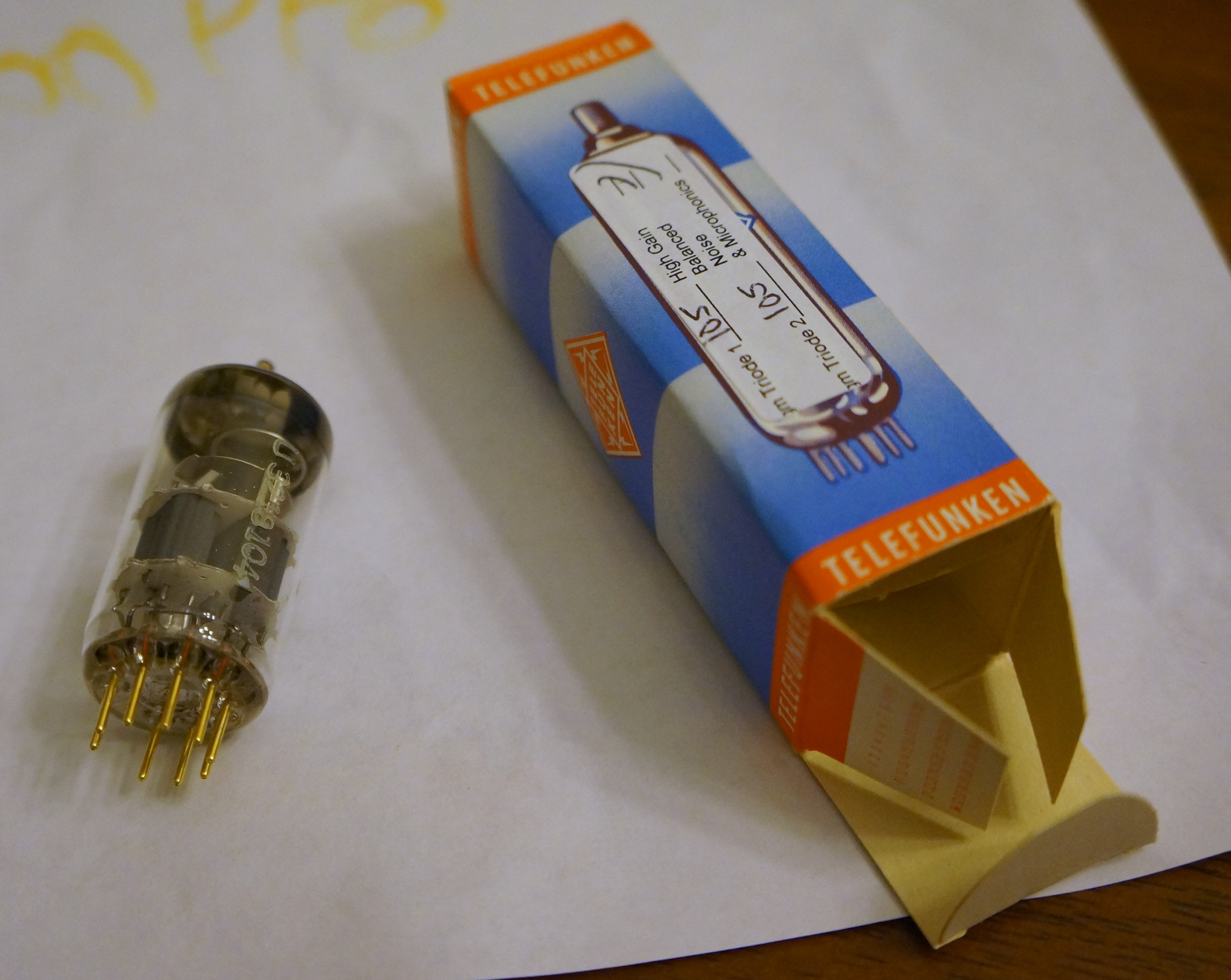

Before posting here, I actually checked your website and many others. This also lead me to believe something fishy about this tube. Although the tube looks like very much like a Telefunken but I have never seen such glowing golden pins in a NOS tube before. Then the off-white (pale) markings on this tube are made by very durable/hard paint and they cannot be disturbed even by cotton rub. While Telefunken marking were infamously fragile. The tube box is also very crisp for something packed 45 years ago, i.e. date code on the tube suggest 1968 production. I just returned the tube!
Nonetheless I still want to hear members' opinion.

The printing on my tubes is chalky, very easy to wipe off. As usual for TFKs.
Did you bother to translate the captions of Jogi´s photos? In of them he tells of a find of some E88CC made by TFK in West Germany, one even with a West German army marking in the form of an eagle. What is interesting is, that these tubes were found in an East German (GDR) radio surveillance van. Some cold war thing where they received all kinds of wireless communication from the west.
Here in Germany you get to see a lot of TFK tubes with that wipe off printing in chalk white, and also a lot of GDR made tubes that have yellow(ish) printing in rugged paint. And now you are showing a tube that seems to have TFK technology and GDR-like printing.

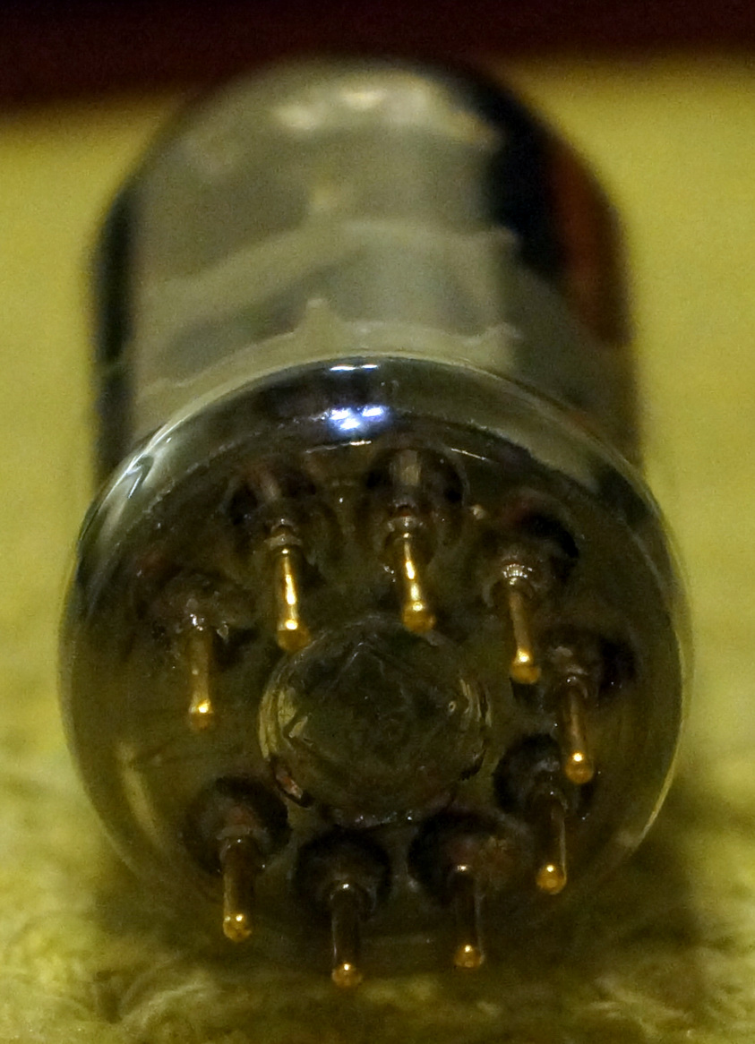

In principle with a true gold plating there is nothing suspicious if the valve has never been out of the box and stored reasonably well. Gold doesn't rust or tarnish in normal conditions. Once it is plugged in one can remove some plating and then it will start to get some oxidation from the underlying metal.
About the printing and the doubt about the originality I agree.
I don't have TFK E88CC's but have some NOS/NIB ECL80's (without diamond) and other used true TFK's whose chalky white printing is really weak and easy to remove just rubbing gently with a finger.

I can't see from your photos is it straight or angle getter arm version? According to code they should be angle getter arm!
Did you try to test them?

It's a genuine Telefunken tube but very likely re-marked and with freshly (gold) re-plated pins. Might be a close (cheaper) variant of the E88CC like the ECC88 or PCC88 or any B9A dual triode with vaguely similar characteristics. The "too crisp" looking box is also suspect. Obviously a "re-worked" tube and you made the good decision in returning it to the seller.
Buy hundreds of used original TFK tubes, clean them, make up date codes, reprint them, replate the pins with real gold, print new boxes, cut and fold them, box the tubes, sell them to someone less experienced than Jac and be a criminal all the way. What a way to make a living.
Did you try to test them?...
The getter support arm is straight and not angled. I have seen Telefunken E88CC with both versions but just like you said the earlier versions should have angled support arm.

No! the tube was not a pull but was sold as NOS. In fact it was the most perfect condition NOS I have ever seen. As if it came to me directly from the Telefunken factory.

The moment I had the tube in my hand I had the bad feeling and I started examining it. Again, it looked newer than the new production tubes. Almost all NOS tubes out there must have been tested at least 5 times in 45 years. But this tube and its box gave new currency smell.

Here are some more pictures. The getter support arm was straight and it has a dent in shape of vertical line on it.

I've got these E88CC 6922 Telefunken more than 20 years ago, before any dirty tube business started.
And the datecode on your originals is the same as on the fake of the OP.
Seems the person who reprinted those tubes found a valid datecode "on the internet".

I've uploaded these photos 14 or 15 years ago to my old geocities site ... I know that photos were used few times on ebay 10 years ago by frauds ...
