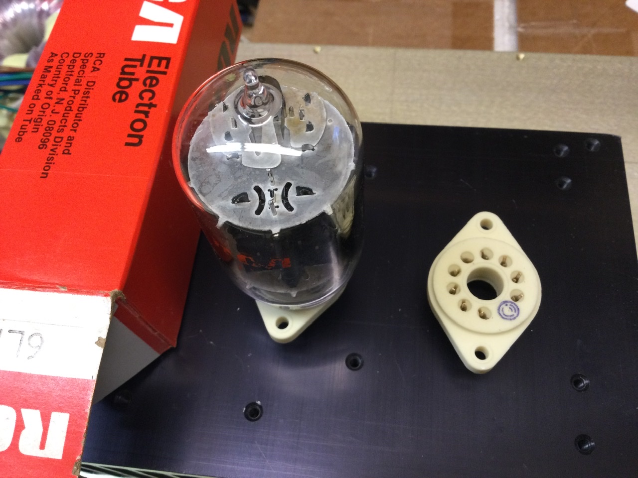

Where do you buy “real novar sockets” these days?
Not Magnoval, or Noval. Real Novar spec’ed sockets.
Problem is that Chinese sources seem to confuse the two (which Magnoval vs. Novar) and NOS Novars have comcpletely dried up. I hope I’’m wrong.
Why the question? There are so many GREAT TV tubes out there, waiting to be used in great audio amps, that NEED the Novar (not Magnoval) sockets.

The B9E base - TekWiki has the following: “The 9-pin B9D (Magnoval) tube base (IEC 67-I-36a) is a larger variant of the B9A (Noval) miniature 9-pin base developed for higher-powered European tubes such as the 8608/EL5070, 8233/E55L, PL509/PL519 TV sweep tubes, etc.
It has nine pins with 1.27 mm (0.046") diameter in a 17.45 mm (0.687") pin circle diameter arc.
The similar B9E (Novar) base used by comparable American tubes has the same pin circle geometry but the tube pins have a diameter of only 1.02 mm (0.038"). Inserting Magnoval tubes into Novar sockets by force will widen the latter's contacts, thereby damaging the socket.
Moreover, many Novar tubes have a glass nipple at bottom of tube which requires a center hole in the socket.”

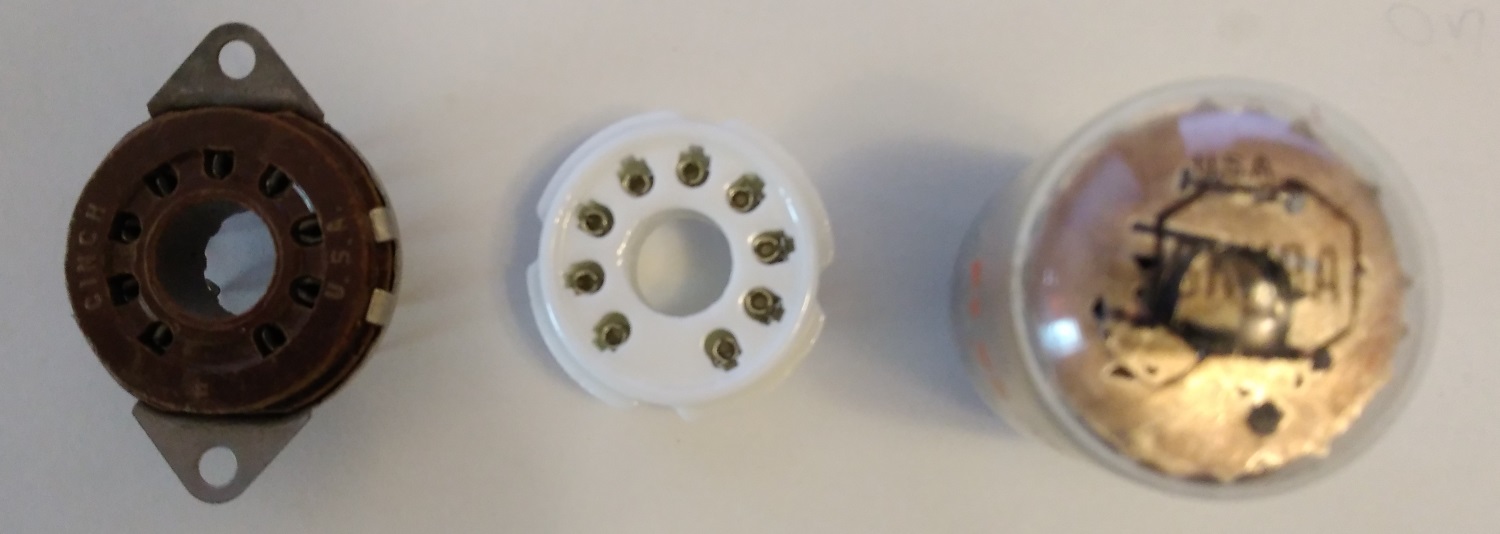

Attached picture shows on the left a NOS ‘CINCH U.S.A.’ 9 Pin Novar. In the center is a new ceramic reproduction I purchased from ESRC. On the right is a 6KY8 that fits equally as snug in both sockets.
Sadly ESRC is no more, but someone is making those Novar reproduction sockets. May I suggest you contact VacuumTubes.Net. I’ve found them to be very helpful and friendly.

Thanks for the news that someone(s) in China is actually making a snug fitting Novar socket. That is what I had expected to find, but so far have not tracked a source down that seemed to sell a real Novar socket.
I will keep looking for Novar sockets for future use, but my immediate need had been met - I found a baggie in my storage room with several of those Cinch Novar sockets that you have in your photo.
For information, I tried a 7868 in one of the ceramic Russian Magnoval sockets, such as Tube Socket, Novar :: 9-pin Noval Sockets :: Sockets - Tubes :: Interconnects :: Electronic Parts :: Banzai Music GmbH
IMHO it is too loose a fit to rely on. Of course I have not tried the actual sockets Banzai sells, but they look exactly like my Magnoval sockets. So, it would be interesting to hear from users who successfully used those sockets with B9E Novar base tubes.

I thought you knew Francois --the big difference between Magnoval and Novar isn't the pin spacings but the different takes on the HOLE diameters .
The UK Magnoval B9D base was originally classed as a "miscellaneous " base in other words when it was designed there wasn't a particular tube to use it with but with the rise in the 60,s in the UK of more modern CRT TV,s the old IO8 tubes previously used were unsustainable and more modern all glass varieties like the PL 500 range were introduced which made use of the B9D base .
In the USA while nearly the same design was used BUT the big -big difference was that the USA Novar base HOLES were narrower as the USA tubes had narrower pins .
Therefore under NO circumstances push a UK Magnoval tube into a USA Novar base --you can force it in BUT thats your Novar base ruined as the holes will now be too wide a diameter to ever hold a USA Novar tube securely.
