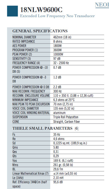

You can take them seriously if you read them correctly 😉.
The 18Sound 18NLW9600C spec sheet states a 70 mm max peak to peak excursion, not "One Way".
The speaker will be damaged if one attempts to exceed 70 mm peak to peak.
For whatever reason, likely to make Xlim sound bigger, it is often presented as a peak to peak figure, when it should be one way, as is Xmax.
The 18NLW9600C has 14mm Xmax, which is 28 mm peak to peak, +/- 14mm, (the distance you will see a white dot on the cone move at Xmax) about half of the Xlim figure.
Where one gets in to trouble is with speakers where Xlim is only slightly longer than Xmax, one popped bass string can cause an abrupt end to the voice coil banging on the back plate, or a ripped spider or surround.
