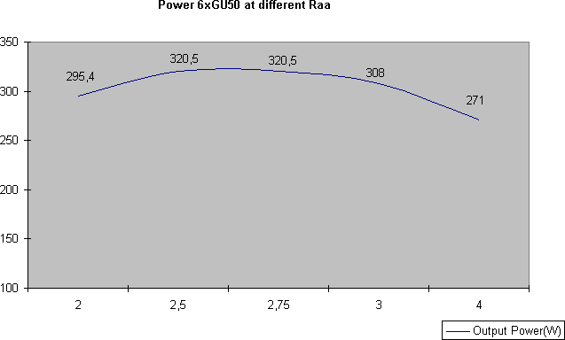

I am currently re-assembling a monster bass amplifier using 6 x GU50 as power tubes under the project name Continuo - from 'Basso Continuo' and the fact, that even if this is the 3rd issue it is undergoing continuous improvements èn route.
The anode voltage is a lot lower than the max. value (1000-1200V) but I found, that running six tubes at a cosy and comfortable 560V – idling, really – produced some 265W as opposed to the theoretical 300W RMS i.e. 0.6dB lower output power.
Re-assembling? Yes – the first design was done on an aluminium chassis, but the transformers were so heavy they buckled the chassis and finally the OPT ripped the fastening bolts through the top during a road trip causing twelve kinds of mayhem on its way. The new design is done in 1.2mm reinforced steel with thick brass rod supports and mounted in a commercially available really rugged 19” case and is not likely to fall apart like the first model did. The total weight of the amp is some 75 pounds but it is worth every ounce. Don’t tell our roadie I said so.
You may ask: When GU50’s are so cheap why not 8 x GU50 in PPP instead of 6?
Elementary, dear Watson: 6 tubes will fit nicely across a 19” rack chassis whereas 8 will not. And with good speakers (I use 6 x FANE Crescendo 10" + a horn) you will have all the dB's you need.
I am attaching the schematics for the power stage and PSU of the amp. Connoisseurs will notice some resemblance to the Ampeg SVT – guilty as charged. I call it inspiration. The output transformer was bought as NOS on eBay for app. $300. It is the original transformer for the Fender 300W amp employing 6 x 6550 with 6L6 driving an intermediate transformer. I bought this from Rissom (look him up on eBay) and he may still have some left.
Else a similar transformer is available from Hammond (1.65K primary, 4 + 4 ohms secondary) at a reasonable price - as ‘reasonable’ goes. This is not a cheapo project. If that is what you are looking for buy a Chinese CrappoDeLuxe with Coughing Dragon tubes in it.
As you will notice there is a reference to a preamplifier on the attached circuit diagram. All data, schematics, pictures and comments plus some other designs using GU50’s will soon be available on my website, http://www.bergqvist.net
Comments and suggestions are welcome.

I openbed the schematic and looked a bit, is it drawing error, looks like R26 has wrong value?
Also it looks like waste of V2a, since 34V RMS is more than enough for EM84, even without voltage doubling rectifier.

The TELEFUNKEN datasheet of the FL152, p. 9, last column, tells us that we can expect about 120 watts from a pair of those tubes, running at a plate voltage of 800 volts, at a 8 kOhms load.. This tube also is a - more sophisticated - succedessor of the TELEFUNKEN LS50 WWII tube.
You do understand the parameters? Well, let's translate it for you:

So with 750-800V on anodes you can get like 360-420W from 6 tubes, with output transformer with primary like 2.5-3K P-P.
So we are in the same ballpark: thats the power (a little less than you predicted) what I have measured - no clipping - at 850V Ub (AB2 condition) with different Raa.
Yep. plenty of clean power.
