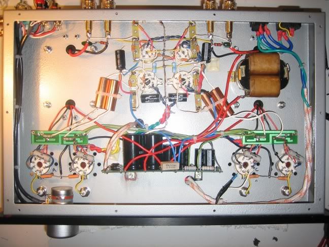

i'm coming up on my third month of trying to get the hum in my first tube kit down to a listenable level. the amp in question is an ella from diyhifisupply. i had a thread on their AA board, which can be found here.
i finally broke down and rebuilt the thing from the ground up, to no avail. i still have hum. confoundingly, it measures only 3.6mv and 4.8 mv in the L/R channels, respectively. i know that's pretty low, but i can still hear it from the listening position 2+ meters away. my speakers are only 90dB efficient.

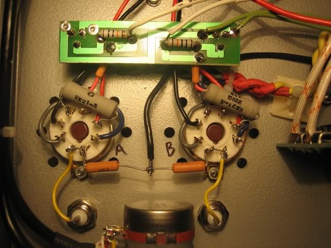

EC and SY: I'll get a hi-rez shot of my amp up tonight. Here is a link to a picture of someone else's if people are need to get an idea of the layout. Mine is laid out in almost identical fashion.
martinab2: The initial problem posted on the AA thread was a real lawnmower hum caused by a loose ground connection - it has since been resolved. The issue presently at hand measures small, but is still too loud to be acceptable IMO.
testlab: Heater voltages on the stock ELLA are 6.3 VAC. If I were to run 100 ohm resistors from the filaments to ground, would that be for all valves or just the output section? driver section?
ray: I have yet to acquire an o-scope, so I can't say for sure what frequency I'm dealing with. There is plenty of noise coming from my tweeter as well as the woofer. Could 60/120hz hum find its way up there?
shifty: The ELLA uses a ground bus down the center of the chassis (see attached pic). When I've been testing it, the amp hasn't been connected near any other gear, so I feel it's safe to say the problem is within the amp itself.

One of the worst offenders is input connectors, such as RCA jacks, that ground to the chassis. I've gotten some wicked nasty hums from that. Now, it may not seem such a big deal having a couple of ohms across a chassis, but it is. Take those few mV of PS hum, add 200X or so open loop gain, and BZZZZZZZ!!!!. Make certain that your input jacks are grounded at one point only: I always return them to the same place on the circuit board where the input stage cathode (emitter, source) ground return is located.
Was the area around them scraped clean of paint prior to mounting the input jacks? There also appears to be a very large path between the ground reference for the input tubes and the input jacks. You might consider putting the ground tabs back on the input jacks, making that point your chassis ground reference and lifting the one you currently have.
The chassis around the input jacks should still have a coat of paint and primer, but it's possible that bare metal might be contacting one of them within the mounting hole itself. I've checked once, but I'll double check again tomorrow. I'll switch the chassis grounding point as well.

Sorry tokyofist, I was fooled by the use (very scary IMO) of RCA jacks as bias sample points. On closer look it appears the designer chose a point on the input sub-plate, beneath the paired Solens in the diyhifisupply pic, as the signal ground-to-chassis point. I don't see it in your amp though. Where does your signal ground connect to the chassis?
tokyofist said:
The ground bus connects to the chassis at one of the mounting screws for the power supply PCB. Look in the top view picture.
Well, that'll be your problem, then. When you said you had hum with buzz coming out of the tweeters I thought it had to be power supply ripple getting where it shouldn't. Lift the chassis connection from the power supply PCB and make a new chassis connection from the end of your 0V bus bar that's furthest from the power supply. At the same time, make sure there aren't any other connections to chassis.
Another thing to attend to is the heater wiring. I can't see any connection from the 6.3V to chassis, unless there's a transformer centre tap that I can't see. Connect a 47R resistor from each side of the 6.3V directly to chassis at the first valve where the 6.3V leaves the transformer. If you're feeling posh, add 100nF in parallel with each 47R.
Make sure you use a serrated washer between your earth tag and chassis and that you do the screw up tight. I use M6 (that's 1/4" to you) and do it up with a spanner. You're looking for a low-resistance bond that stays that way for years. Scrape the chassis clean of paint or anodizing before attempting to make a chassis bond. Use this method for the mains safety earth and any other connections to the chassis.
You are all gods among men. I first swapped the chassis grounding point to a location near the inputs. This had no effect, however. I then added a resistor and cap in parallel from each 6.3V winding to ground. Bingo :smash: :smash: :smash:! No more noise, even with my ear at the speaker.
