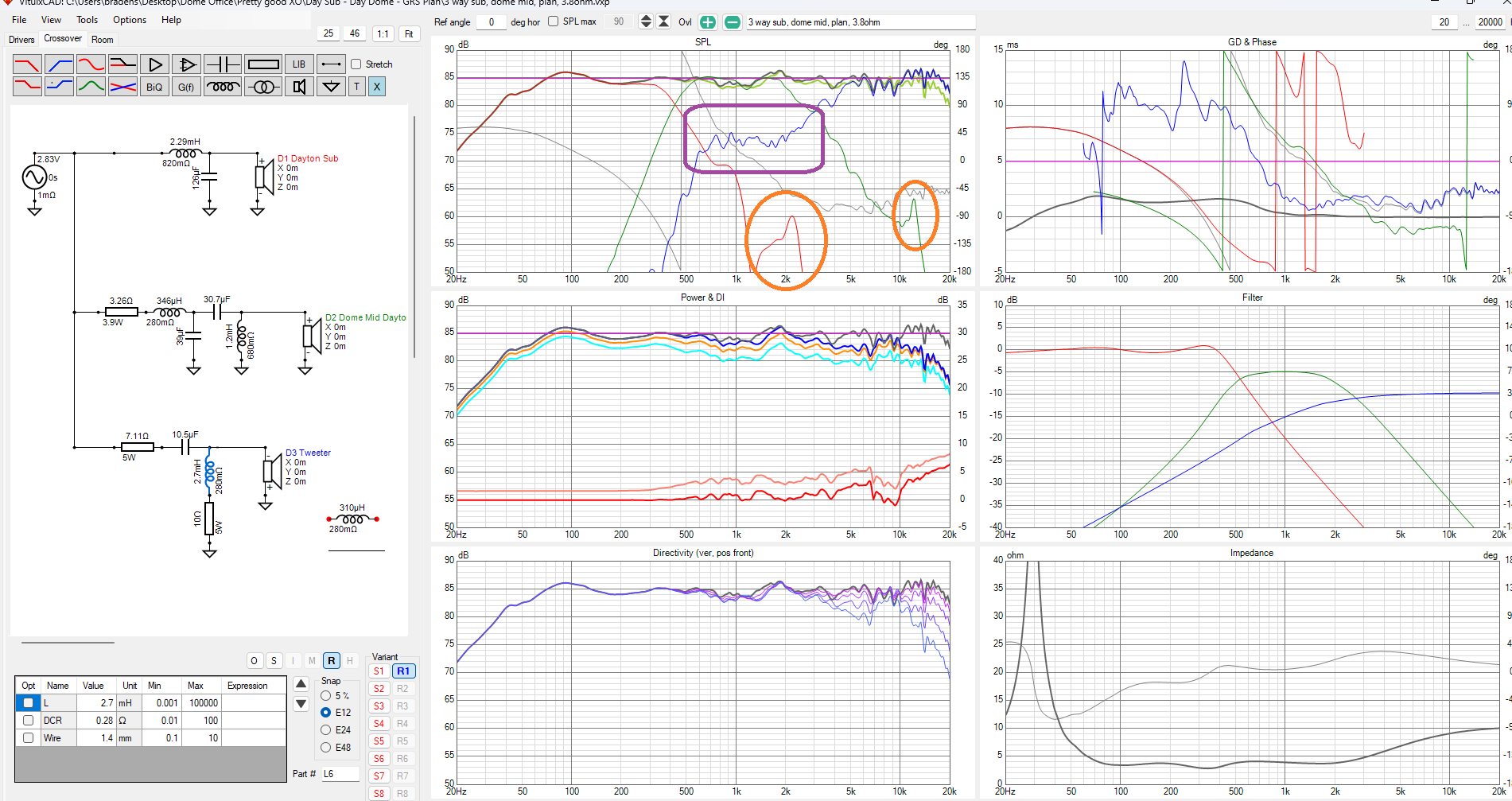

Well then this begs another question:
How far padded down does a cone breakup not matter anymore? 15db down? 30? 50?
Ive had XOs up and people lost their minds that I was allowing any amount of cone breakup to cross into the tweeter.
Same thing with tweeter distortion dipping down into the mid. How far padded down does that distortion the tweeter is giving off below 2khz need to be padded for it to become a non issue?

Not at all. What if I changed "and it didn't bother us as much as that" to read "and breakup didn't bother us as much as that" 😉Is that some sort of a dig at me?
The underlying message was that sometimes things are blown out of proportion on the interwebz.
Breakup is not related to impedance, it is related to cone size. You can't tell breakup from a response plot, but you can guess it from cone size and you can see it in polar measurements.
This is correct thinking. Try 20dB, give or take.How far padded down does a cone breakup not matter anymore? 15db down? 30? 50?

Here is a screenshot example of what I was talking on earlier. The two orange circles highlight cone breakups. They are 20-25 db down so I'm not sure that will be audible. But how far down do they need to be padded so it doesn't matter anymore?
The purple square shows where the planar mid/tweeter leaks into the mid range. I expect this to be audible as it is only 10 db down from where the main mid is playing.
Fyi: this is all theoretical traced data though I did put in theoretical spacing between the drivers

Most definitely center-to-center spacing between midrange and tweeter units will affect the vertical radiation pattern. In addition, some crossover topologies are much more sensitive to this parameter than others. As one goes above or below the design axis, additional differences in the distances from the drivers to the listening point will be introduced. At frequencies such as 3kHz, where the wavelength of sound is about 11.4 cm, all it takes is a difference in distance of 5.7cm to get strong cancellation effects coming into play (if the drivers have outputs that are similar in amplitude).I am not sure I follow about the center to center spacing. I have seen where the distance between drivers can cause big issues with the vertical off axis.
I would expect that 20dB would be the minimum amount of attenuation of major resonances that one should aim for. This is particularly important for high-Q resonances, as these can ring for quite a few cycles after the excitation signal is removed.Here is a screenshot example of what I was talking on earlier. The two orange circles highlight cone breakups. They are 20–25 dB down so I'm not sure that will be audible. But how far down do they need to be padded so it doesn't matter anymore?
I am not sure of any publications that have reported on the audibility of such high-Q resonances hidden under the main response signal. Maybe someone can chime in and mention such publications if they know of any that may be out there?
Being only 10dB down, that wide plateau in the tweeter's response is certainly a bit of a worry. I am not sure how it will sound, but it will certainly detract from achieving a point-source sound radiation system at midrange frequencies in the region where the overlap is occurring. This could result in: a) making the sound source appear to be larger, and b) adding some unusual spatial effects to recordings.The purple square shows where the planar mid/tweeter leaks into the mid range. I expect this to be audible as it is only 10 dB down from where the main mid is playing.
I'd hazard a guess that the crossover network needs to be revisited and modified to achieve a much more conventional blending of the midrange and tweeter outputs. That is a much safer option.

Witwald,
This is much clearer now. Thank you for explaining further.

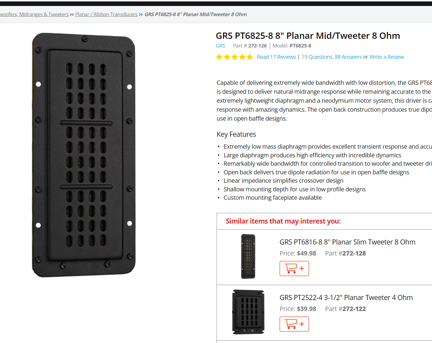

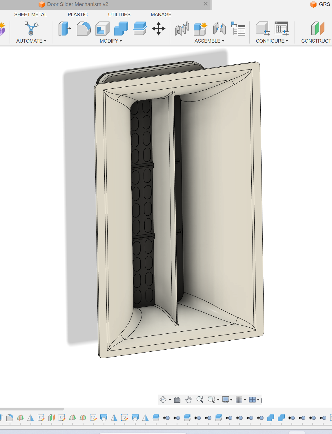

I did notice the different order crossovers interplay with the distances. This is why I like to play around with traced data before I ever buy anything. Takes me a month or so.
That crossover I showed actually uses a planar midrange/tweeter. That mid range should be playing quite clean. I am going to buy those and mess around with them. I think I can physically horn them and enclose the back to make them behave a bit better. I also need to figure out where they play clean and where they don't. Too much of an experiment to order anything else with it. Here is V1 of the planar mid horn. I will post up with data when I have it.
They have a smaller 4.5 tweeter version that looks really neat. I was thinking of using that with a dome mid and then pairing it with a sub for a desktop near field 3 way. I haven't quite figured it all out yet to be honest.
