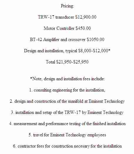

The Eminent Technology TRW-17 is definitely an interesting and unique product; but, as this is a DIY site, it may be reasonable to ask: "What does the TRW-17 actually do, and what could one do for US$ 24k+-2k within the range claimed by Eminent Technology?"
It might take writing a book to answer those questions while analyzing the linked write-up in Post #1, any volunteers? And it may well be that in the range below 10Hz the blower flow modulator is a hard to beat technology.

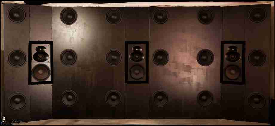

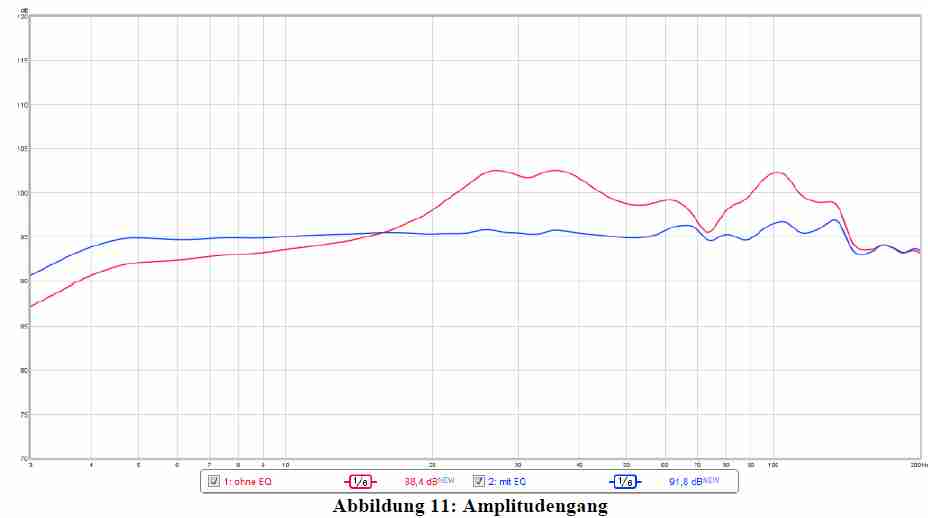

Besides numbers of multiples of some of the subs listed and documented on data-bass.com, one more example of what can be done with conventional dynamic driver technology is the SBA Fonebones links to in Post #33 here: http://www.diyaudio.com/forums/subwoofers/254251-best-subwoofer-possible-price-no-object-4.html I know, the .pdf is written in some funny language ( 🙂 ), but the graphs and pictures tell the story well enough. That kind of SBA with highly absorbent material behind the listeners might compare favorably to the TRW-17.

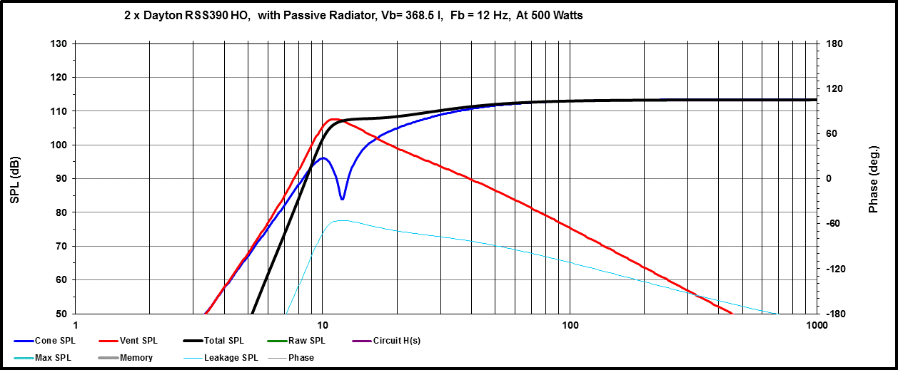

Yes, indeed you can build and EQ a 2x15" high excursion driver + 2x18" high excursion PR system that has similar frequency response and SPL capability. In fact I have the drivers for this just sitting up in my attic waiting. (no joke)
For instance, I can get the response shown in the attachment using two 15" drivers having about 12mm Xmax. The enclosure volume must be very large (350 liters!), and this has prevented me from building it (a lack of where to put and how to move such a thing).
-Charlie
Charlie,
You just mentioned you have an attic waiting to house an enclosure (or serve as one), why not use it, rather than just store speakers there 🙂?
I have a crawl space that could be utilized as a giant enclosure, but I find <25 Hz much over 105 dB unpleasant, so my small 2x12" sub with flat response (at the listening position) to 20 Hz is OK by me.
