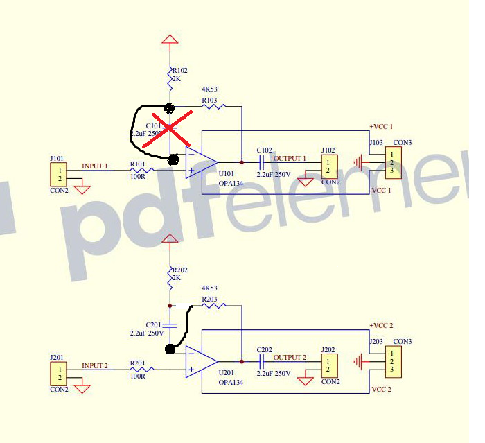

Hello Everyone
I just finished building a TL071 line pre-amp for my cd player. But the output (Pin #6) of the op-amp measured before the coupling capacitor (2.2uF) has a voltage offset of 0.1v for one channel and 0.7v for the other channel. DC Voltage measurement for both channels after the coupling capacitors are 0v.
Would anyone please tell me what caused this problem and is there any way I can fix it?
Thank you
TL071 have worse case input offset of 10mV, so a gain of 10 makes the output offset 0.1V worst case. If the preamp circuit has gain (perhaps before the volume pot), then that could easily explain 0.1V offset. 0.7V offset sounds wrong though - are these opamps socketed?

Hi Mooly
Attached please find the schematic of the TL071 Pre-amp.
I measured the following voltages on each pin of the TL071 OP Amp.............
It is as the others have commented...

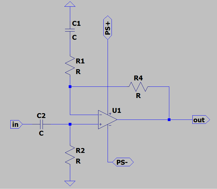

Here are two ways to fix it. The second way which retains the feedback cap would be best because it keeps the gain at DC equal to 1. Both of the caps could usefully be a bit bigger in value and be of much lower voltage. Try a 10 or 20uF electrolytic.
The input (which you say is from a pot) must have a DC path to ground. As long as you no series coupling cap that you have not shown then it should be fine.
Schematic is here:
Oops, that's not going to work! Two problems:
1. There is no DC feedback through the caps in series with the negative inputs.
2. There is no DC reference unless the input is shorted or connected to an external DC path to ground.
An op-amp does not bias itself. You have to arrange the input networks so that the input difference is zero DC when the output is where you want it, and that can be (almost) anywhere you like between the rail voltages.

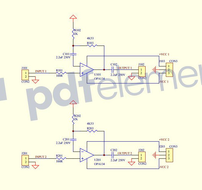

Hello Everyone
First of all, I want to say thank you for all your information and comments about the circuit. The reason why I want to build this circuit is because I had built it (one channel) before when I was a student long time ago as an experiment, and when I finished, I hooked it up with a cd player and it sounded normally.
Anyway, I searched on the internet over the weekend tried to look for some information to fix the offset problem, but I find the attached pre-amp circuit and it looks great to me. Once again, please review the schematic and your comments are highly appreciated.
