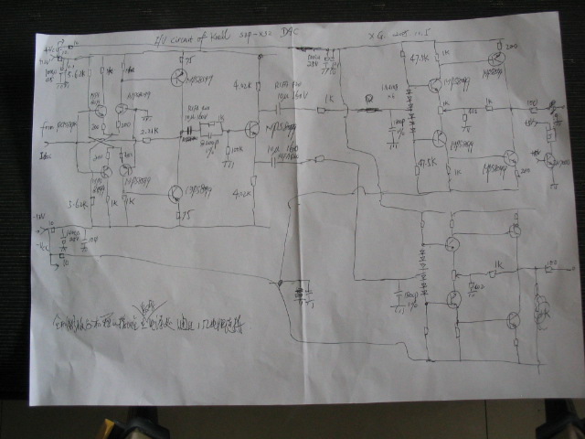

re-draw the I/V sch of Krell SBP-32X DAC

I traced all digital power supply,and I found that it is so simple and standard,so I didn't traced all details of analogue power supply.
the DAC is in my friend hands. if you want to know all about the PS,I will ask him to help.
thanks for your hard work....the sch is just my sketch which I draw while I traced...I had no more time to re-check it.
hi,Mr. janneman
before I draw the SCH,I guess that the analogue circuit is discrete IV +positve discrete OPA +negative discrete OPA.but you now can see that,the discrete OPA all are positve,and arrange a BJT as splitter phase stage.the BJT splitter phase stage is very simple and effective,but have much offset,so they used two 10U coupling cap.
for the input coulpling 10U cap of splitter phase stage....I didn't try PCM58,but I have tried my TDA1541 NOS DAC,the coulpling cap is necessary,because the offset of temperature...In the ML DAC which show in ML website,you can see the heat couple of the PCM1702(PCM1704?) and the NTC(PTC?) resistor.maybe the ML DAC tell me why.
X.G.

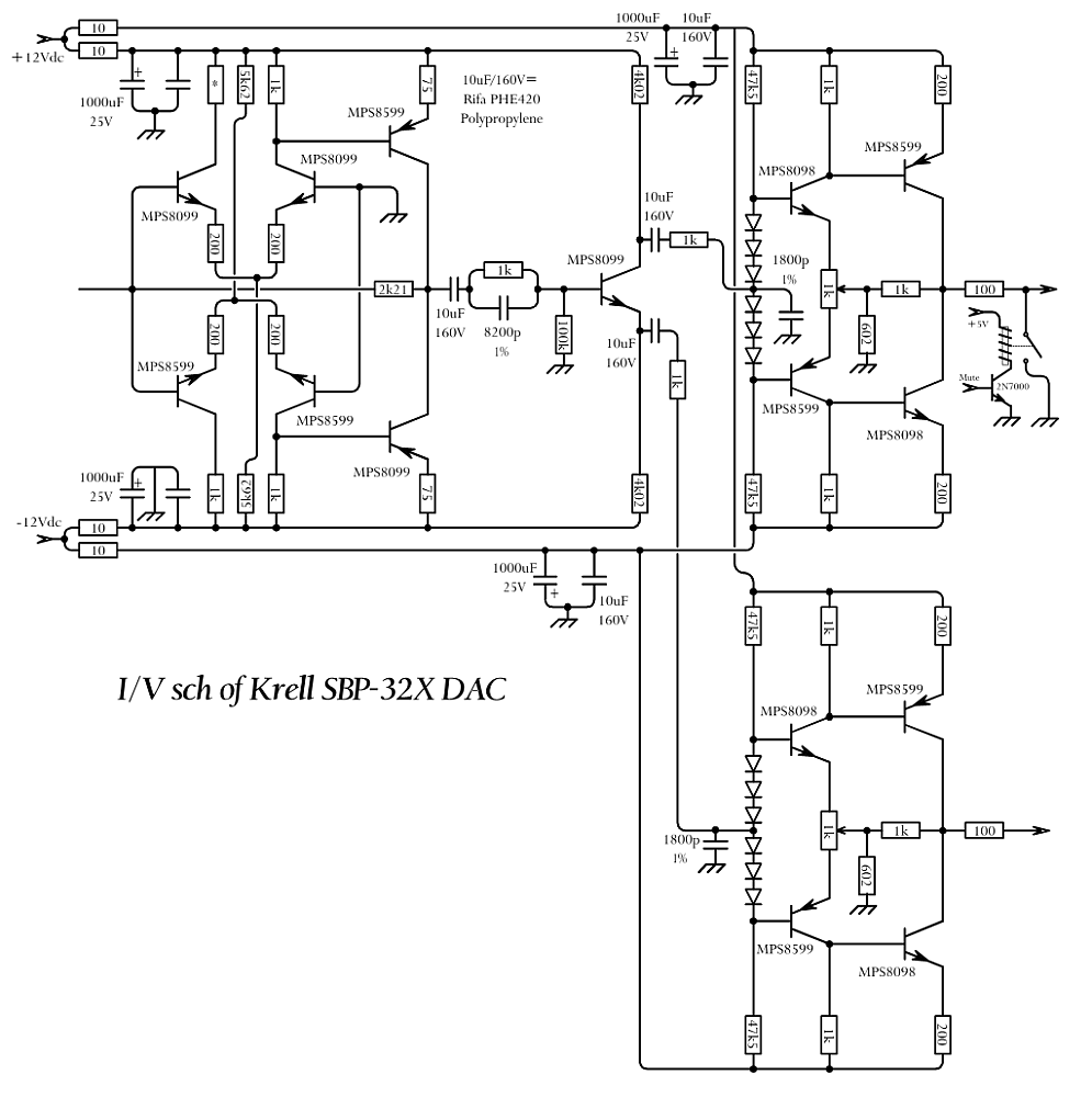

X.G. said:
soudstage, danamic and the brightness of piano,the krell is better
the smooth and vocal,my DAC is better😉
Sounds like you're comparing higher bit DAC with lower bit one. I would prefer the higher one, Krell I suppose in this case, and workout the vocal quality through caps replacement or speaker design 😉
X.G. said:
hi,Mr. janneman
X.G.
Yes I see that, but all the voltages on those coupling caps are all very close to zero. A simple servo would take care of any residual temp drift. Now with the coupling caps, the temp drift is no longer seen at the output but it is of course still there, it moves the operating point of the stages around.
But then again, many people prefer coupling caps over servo's, so maybe that's the reason behind as well.
Jan Didden

Seems interesting....have anyone tried to build this I/V ?
What is the original DAC inside the KRELL ?
To X.G. : Have You had more time to recheck the drawing ?
To tvi: where do you get the drawing in your attachment...is it based on the hand-drawed scetch posted by X.G. ?
Lyra
