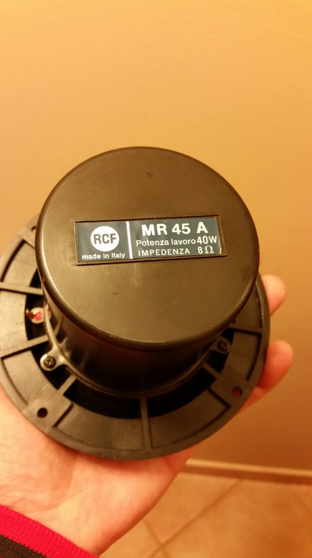

Does anyone know the Thiele & Small Parameters of these old mid range? On the net do not find any news of them ..... thank you

As you have the driver, why not just measure them ?
... I do not have specific tools ..! For measure
MR45A is a dome midrange with closed back, you don't need TS parameters to design a crossover. However, you do need to measure the frequency response and impedance vs frequency to design a crossover. ARTA software is free, borrow microphone and do the measurements, or ask someone to do that.

... I wanted to know the parameters of it to create a crossover ..... just this!

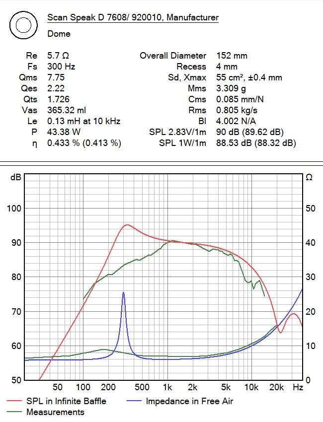

You could measure basic TS parameters using some wires with alligator clips. Fs and Qts would have sufficed to get the picture. Depicted in the schematic of post #2 with ARTA labs LIMP module software. There is also explained how to measure Re, the DC resistance of the dirver voice coil.

In the context of simulation programs TSP are always required, not just for woofers.
If it's a cone midrange, yes, probably (but not always). But this is a DOME midrange.
In most cases, the frequency response in the pistonic range can be calculated pretty precisely then. That's about 2 kHz for a 40 mm dome. Above 2 kHz things get more complicated though.
No, it can't. You can't calculate the membrane breakup, the angle response and everything else I've already wrote several times above. Honestly, I'm sick and tired in repeating myself over and over again just because some don't even try learning the meaning of the parameters and what you can do with them and what not.
You're still saying 'I can calculate it'? Okay, then calculate me a crossover with this midrange:

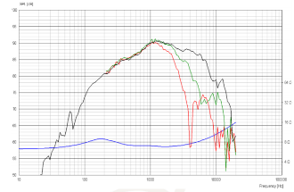

Well, if parameters are completely wrong then the simulation is wrong as well. Are you trying to fool me? Nevertheless, in the range from 1 kHz to 6 kHz the simulation is very close to the measurement. Close enough to do a basic crossover design in a simulation program. 🙂
No, I just wanted to demonstrate how useless these parameters are (for a dome driver). Not only will they have huge tolerances even at top manufacturers, they rarely available and volume resonances aren't anywhere noticeable, they are extremely misleading. So you came to the conclusion the 1-6kHz range is close enough to do a crossover design. Now look at the datasheet, would you really use the mid driver in that frequency range?
Do you see now how 'useful' the parameters were?
