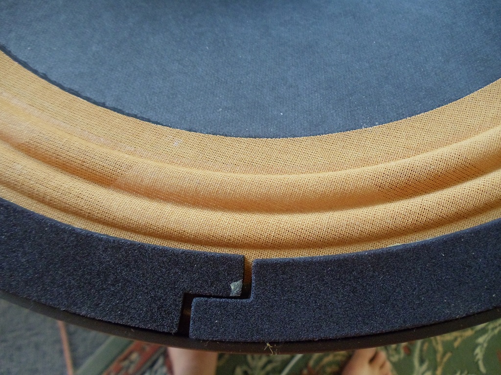

Hello guys. So i'm running 4 EV T18 boxes with RCF L18S800 drivers. Recently someone from the club i rented them clipped and fried all 4 of them so they payed for the rapair. One driver had allready been repaired a long time ago (they are 17 years old) so the guy couldn't repair it again, he had to order a recone kit for that one. He reconed it and it looks beautifull and works fantastic now.
The other 3 drivers did not need a recone, he just ordered a new coil from RCF. And a new upper suspension (cloth surround) because the old one started falling apart from age. The guy that i gave these drivers to for a repair is doing this job for 25 years and is the best in city.
Now these 3 drivers that he repaired are working well, but he didn't put any glue/doping material on the new cloth surround. So it looks yellow and you can see it's completly dry, there is nothing on it. I forgot taking a picture but it looks the same as this: http://www.diyaudio.com/forums/blog...surrounds-recone-subwoofer-surround_small.jpg
So as you can see, the air can now go trough the cloth material and it's very soft. You can feel , when you are touching the driver, how it's softer then the reconed one. When you give it some low frequencies you can tell it's moving more then the reconed one just by looking at it. When playing music they seem to sound similar, but when you give them a sinewave between 45 - 60hz. The reconed one is about 10dB louder. I listened to it and measured it. The guy in the store told me he never puts doping on the sorround because it just slows the cone down and isn't necessary. He repaired hundreds of S800 (and he is not lying, he is really known as one of the best in this job). He told me that the reconed one needs some braking in and they are going to sound the same later. But it still seems to me i should dope the cloth sorround since i have never seen an RCF 18 withouth doping on the cloth sorround.
What do you think about this?

If these are bass bins, then I would definitely put some doping on the surrounds. If air can go through the surrounds and/or the dustcap then the effective parameters are altered somewhat. Otoh, if the performance is ok, then it may not matter.
It makes little sense that the recone is 10dB louder at 45-60hz, except that there must be a difference in the cone mass and/or the VC is different (more turns in the gap).
There are very light compounds that can be put on the surround, so that is not an issue as far as changing the compliance of the surround enough to be concerned about.
Glue should never be used on a surround unless the goal is to stiffen it, and even then glue is not exactly what is called for anyhow. (imo)
If the new surrounds are less stiff than the old, then at LF the TS parameters are changed. Probably it will not handle quite as much power, as it is likely to have less excursion control at LF, especially *below* Fs or F3 (in the box). So bottoming out the driver becomes a concern in live sound situations, unless there is a HP applied to keep the subsonics out.
It will also have an effect on what the cone will do at higher freqs as the termination of the cone at the outer edged is changed. Could be better or worse - likely different somewhat.
All merely my opinions...

There are many types and grades of sealers in the speaker industry. Unfortunately only a few make it to consumers, like the one cited above. It dries clear. So you could color the cloth itself. That's what I would do. Could be as simple as grabbing the guts of a permanent marker with a surgical glove and wiping one or more coats to make it black.

I have bought recone kits from OEM's that include untreated cones, and you need to treat them once installed. So it does not surprise me that the repair guy got them untreated. Most recently this happened for a Beyma 10XC driver I did. This kit included a bottle of doping compound and instructions for its applicaton.
The photo you originally linked to from my blog showed a sub that I reconed using an aftermarket kit. I had to buy the doping material seperately. The supplier knew exactly what I was after when I called him.
Here is the bottom line:
- For a bass driver, you need to dope the surround.
- There is no choice, as the Q in the box is completely and utterly destroyed. What does this mean? That driver in a ported enclosure showed the SAME impedance as the driver in free air. The enclosure resonance did nothing at all.
- Without doping the surrounds the loading from the enclosure will just not be working, and your speakers will die a very early death.
So you are worried that doping the surrounds might stiffen them up a bit?
- OK, worst case it will. But...
- That is a lot better than doing nothing, as you will very rapidly destroy the drivers as they will be "unloaded" at low frequencies.
If I were in your shoes, I would have a very direct talk to the repair guy. If he does not understand the implication of not completing the job, then you need to talk to someone else. Alternatively just buy some and do it yourself. If you can colour in a picture then you can apply doping compound, you simply paint it on until the cloth is "wetted". I bought my last lot from "Queensland Speaker Repair" though I am sure you have plenty of people closer to you who can supply the required material.
Is the above coming across as being very direct? I hope so - as I was utterly stunned at how completely the lack of doping destroyed the performance of the driver. And how immediately applying doping put things right.

I sent an email to RCF italy. They repied quick and told me yes. The original cloth surround is yellow. So he did not lie to me about it being an original cloth surround. But they also told me it needs to be treated but RCF themselves don't sell the treatment. So now what i'm about to do is get a bottle of the damn glue and treat the cones.
I remember that on the old surrounds, if you scratched the treatment / surface od the surround, you could see the yellow material below. Witch means the treatment used for the surround is originally dyed black. Damn if i could just get that black treatment!
Look at this picture: http://i30.photobucket.com/albums/c316/athlon-64/IMG_2452_zpsa0992ce1.jpg
That's one of my S800's pictured this summer. Not take a good look at the surround slightly left from the red terminal. See the small yellow dots? Those are places at witch the treatment didn't go trought well so they remained yellow. So the conclusion is, they sell original yellow surrounds. But they are supossed to be treated!

Are you jumping at shadows? One thing to check is whether the cloth surround has clear doping on it.
Is the surround obviously "clean cloth" or is it covered in clear "stuff". Clear doping material dries kind of like PVA glue. (that white woodworking clue that dries clear)

EDIT: No it has got no clear doping. I checked 15 times. It's naked and air can go trough it. You can feel with yours finger it's completly dry.
