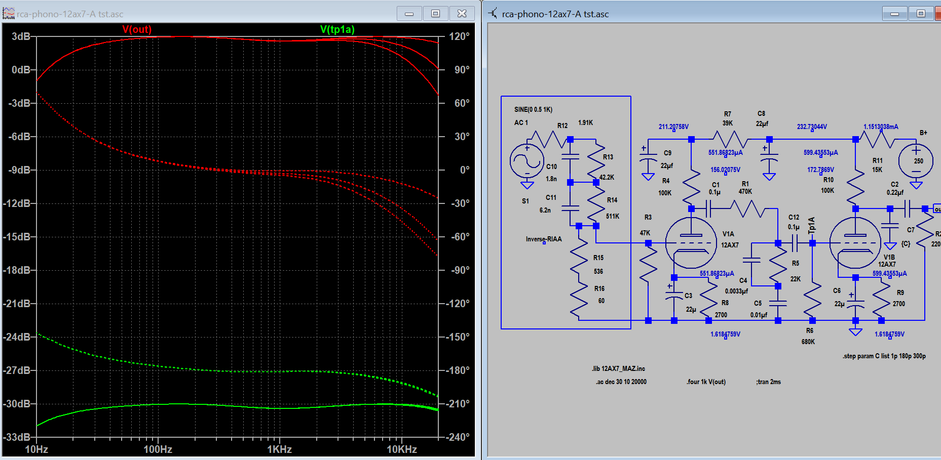

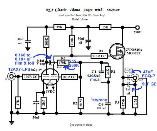

I have built the RCA tube manual RIAA phono preamp. Sounds great.
I am just wondering about the purpose of that last little 180pf cap on the anode of the second triode. The say to reduce it as you make the interconnect cable longer. Hopefully it isn't critical to the RIAA eq curve implentation.
C6 and C7 would be setting the RIAA curve.
C8 would start cutting off above about 23Khz or higher depending on load.
Likely to keep RF or other higher frequency gremlins out.

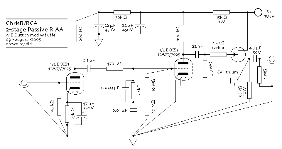

Eli has an improved version, hopefully he will stumble across this thread.
One of the problems with this design is it's designed to drive rather high impedances and is very sensitive to external capacitance on the output.
You could add a cathode follower at the output to address.

Had a feeling that was what it might be for. Does it form a filter with the plate load and Rp of the valve. That comes out to about 23 kHz with them in parallel.

Actually I have built a few of them now and when I build them as a standalone unit, yes I do add a cathode follower. The circuit sounds good either way.
Would like to see Eli's version. Link to a schematic?
It said "include capacitance of output cable", if the cable capacitance already added up to 180pf, I don't think you will need it, else the upper end will suffer.
In no instance am I using a cable. I am either feeding it direct to the next stage in an integrated preamp, or feeding it to a cathode follower when it's used in a standalone phono preamp. It probably isn't that necessary anyway, if, as discussed above, it's just to remove any high frequencies above the audible range. I haven't struck any stability problems with this circuit.

Found Eli's tweak here: valve phono stage on a budget

I see. He used a SS cathode follower. I used a triode. Yes, I think it performs well.
Thanks. I see, the C8 180pf cap is left off for both these circuits. I suspect, adding the 100R grid stoppers for stability is all it really needs.

I was wondering how critical the choice of tube has to be so that the RIAA equalisation is not disrupted? I have a box of 7B6 tubes, that are Loctal 6SQ7/6AV6, and the triode in the 6AV6 is close to one half of a 12AX7/ECC83.
Plate resistance 7B6 is 91k compared with 62.5K for the ECC83, otherwise the characteristics look similar. Both have 100 ampification factor. Curves are a close match.
I am conscious of the fact that phono amplifiers have a synergy between passives and tube characteristcs. Is it worth considering 6SQ7/7B6?
Remember that rp (plate resistance) of a triode varies at different operating points.
A 12AX7 run with 0.5mA Ip (plate current) and Vpk (plate to cathode voltage) of 200V probably has rp of 90k ohms or so (guesstimate, I didn't draw loadlines).
However, that same 12AX7 run with 1mA Ip and Vpk of 125V will have much lower rp, probably around 70k ohms (guesstimate).
Are you comparing 7B6 and 12AX7 at identical operating points?
Unless the rp forms part of the RIAA filter network, it will make no difference. Here the RIAA network is passive, cap coupled from the first triode, and working into the high impedance of the second. I am wondering if the rp will have any, or much, effect at all.
