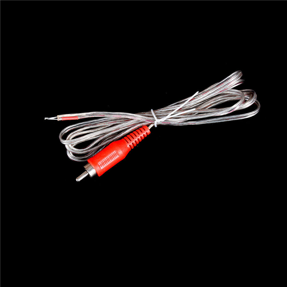

Hi Guys.
I have an interesting combination of vintage speakers.
A pair of Minimus 5 Realistic Speakers (which have RCA out for parallel speaker connection).
I also have a pair of wall mounting Realistic speakers which can be hooked up as rear speakers for a mock surround.
They've been set up to include individual volume control so they can be tweaked for optimal sound set up.
Can speaker wire be terminated to RCA type connection at one end?
cheers
Cliff

Yes, indeed it once was commonplace on some of the less expensive gear to use RCA Jacks for the speaker outputs.
I'm thinking, modern RCA plugs are geared to accommodate interconnects and other discreet applications.
Are there dedicated RCA plug designs to accept speaker cable?
Not that I know of. There's nothing too difficult about soldering regular speaker wire to a basic RCA plug. For anything using RCA sockets for the speakers, 18-22awg is going to be perfectly adequate. If you're not happy with that, replace with a more suitable connector. Or make an adapter to something more convenient, which is what I usually do for gear with the 2-pin DIN speaker terminals.
Actually a quick search reveals there are RCA plugs available with screw terminals already built in from several sources (amazon, ebay, etc). So that would solve your problem very easily if you're not keen to solder anything up.
