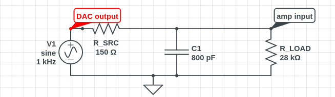

I have as source a CD player, phono preamp and Raspberry Pi. They are connected to a Teac UD-503 DAC with their respective connections (coax, RCA in, USB). The DAC serves as pre-amp/source selection. It drives the power amplifier, a Millett Engineer Amp, using unbalanced RCA interconnects.
Due to my limited space and speaker placement, I had to use long RCA interconnect cables between DAC and amplifier. I made my own interconnects using Sommer Cable club MK22, cable length about 4m (say 14 ft). I measured the interconnect capacitance at about 750-800 pF.
The DAC output impedance (from doc) is 150 ohms, the power amplifier has a Broskie "Front panel" signal selector and attenuator. From doc : "The FrontPanel stereo attenuator presents a nominal load resistance of 28k to the signal source".
The whole setup works well and has very low hum. Can someone here tell me if my setup makes sense, or if my cabling kills the high range of the spectrum too much ? Any formula to apply to calculate the atenuation considering values above ?

http://sim.okawa-denshi.jp/en/CRtool.php
Low pass filter 150 ohm / 800pF => Fc = 1.3 MHz ..... Think you should be ok 😉

Wrong calculated: It's a high pass filter not a low pass filter, R is 28K Broskie & C is 800pF cable capacitance, the cutt-off frequency is 7.105Hz

@merlin el mago Unless you connect the cable in a very unorthodox manner, the cable capacitance is in parallel with the DAC output. Baldin's calculation is spot on. One could nitpick and state that the calculation should really be done with the parallel value of 150 ohm and 28 kohm, but the difference will be negligible anyway.
The only thing that's missing are possible non-linear effects if the DAC output should run out of current, but those shouldn't be an issue either.

I should have drafted the circuit as I understand it. Here it is.
So yes it is a low-pass filter and the cut-off frequency is 1.3 MHz. Meaning I have no issue with my bandwith and the only potential issue is hum, which is ok. Thanks all for the help !
I'm sorry guys my bad. The capacitance it's in parallel to the load not in series.@Baldin.
