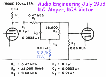

In the 1960 issue of the RCA tube manual (RCA 20) there is a passive RIAA phono stage (fig 20-16,page 216) using two 12AX7 stages. The RIAA passive filter is between the 1st and 2nd triode sections. I would like to add (per Allen Wright) a third filter stage for a 75uS (20KHz) roll off after the second tube stage. Figuring this stage is output coupled with a .22uF cap and 1M resistor and feeds into a sel switch and then a 250K volume control, what should the filter stage values be? What is the formula for figuring out these values?

You would measure or calculate the circuit output impedance (before the coupling capacitor), and then add the 1M and 250k both in parallel to it, to get the total resistance R to use for the time constant. Then use C = 1 / (2Pi x R x 50kHz).
That said, this is not a good idea, regardless of how many do it. The fact that the HF response of the passive circuit goes below unity is an advantage of the passive circuit over a typical active RIAA circuit.
It's also based on misconception built around a very specific cutter. (Neumann?)
The RIAA standard does not call for it and there is no particular reason to implement it.
If that's such a good idea, maybe the hf roll off in microphones and cartridges should be compensated for, too. I'm sure that would work out well.

....{50KHz} roll off....
You mean *boost*, to "correct" for some assumed roll-off way beyond the audio band.
My own assumption from years around the industry is that the Old Men (and the few still in the business) knew what they were doing, and they mastered to play well on the agreed playback curve. There surely was "some" limit to the cutting boost (BTW this varies across the width of the side). If that shaved 15KC or 20KC, minor extra EQ (on top of massive EQ to shake the heavy cutter) would get that top octave "right" on the playback curve everybody finally settled on.
However IF you must have the 50KHz boost, one resistor, see attached.
This is not the Tube Manual but the technical essay. The values given are SO close to perfect that I see little point teasing more digits onto them.
PRR, thanks for schematic, but maybe I should build "as is" before adding the boost.
