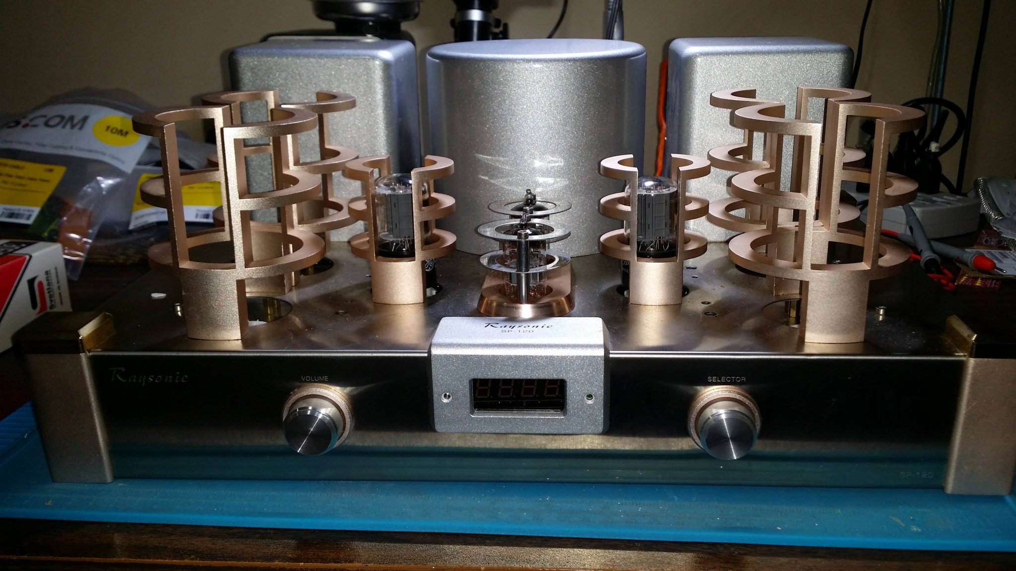

I recently acquired an early SP120 integrated (not the Mk II), and I wonder if anyone could help me with some issues...
It functions seemingly perfectly, equipped with basic tubes (Raysonic branded -russian- 12AX7 and 6SN7GT-s) and Electro Harmonix KT120-s.

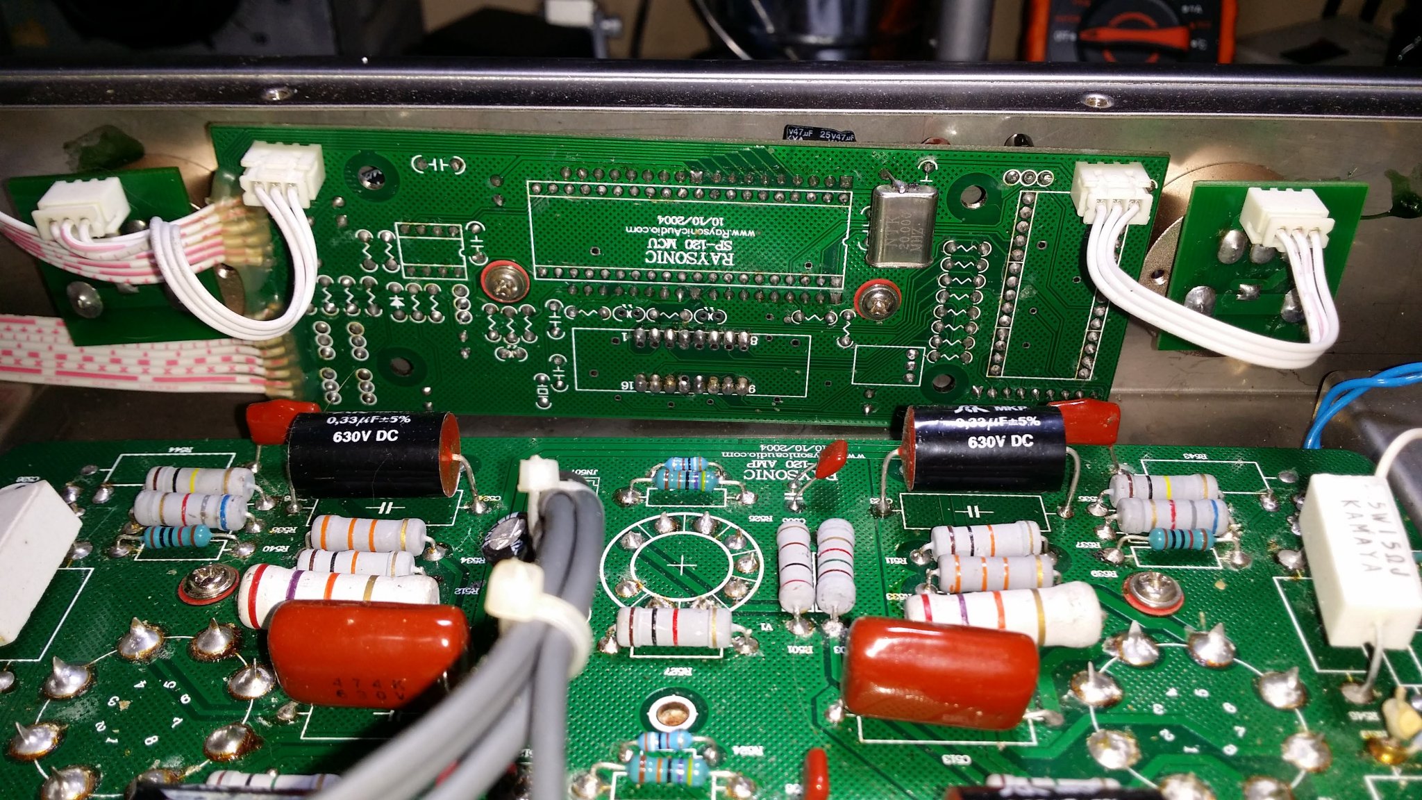

I can see two sockets for ICs but they are empty, does anybody know about what IC are there, if any?
maybe there is no need for an IC?

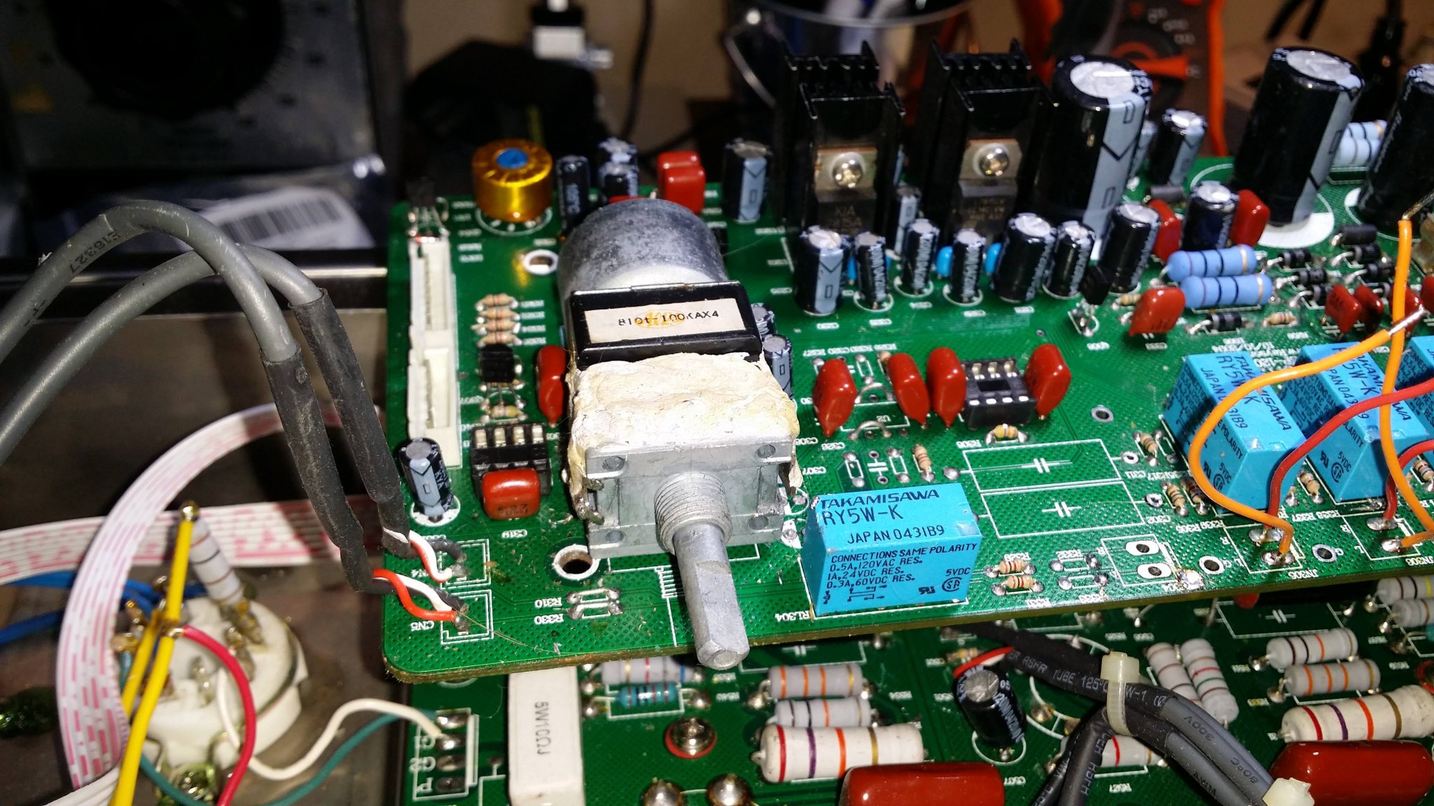

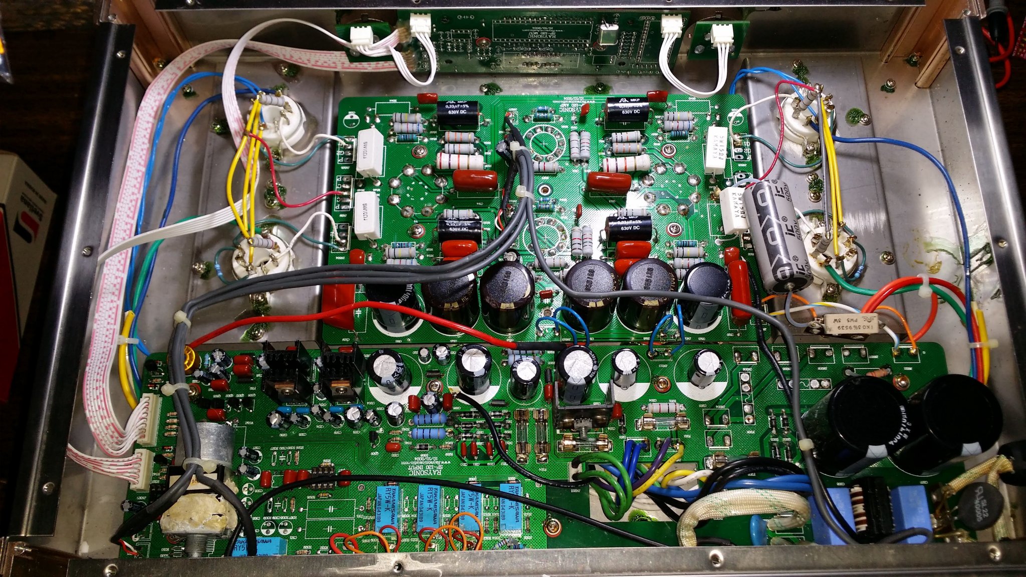

I have a working, but modifird SP-120.
They are actually amazing amps with a few treeks and able to destroy some big names.
I had mine apart to replace all the valve bases with Ceramic/Gold plated Audio note parts.
I took a few photos that might help you. Where do you live? If you are close then help is close.
If not what is your email and I will get the large files to you so you can blow them up.
