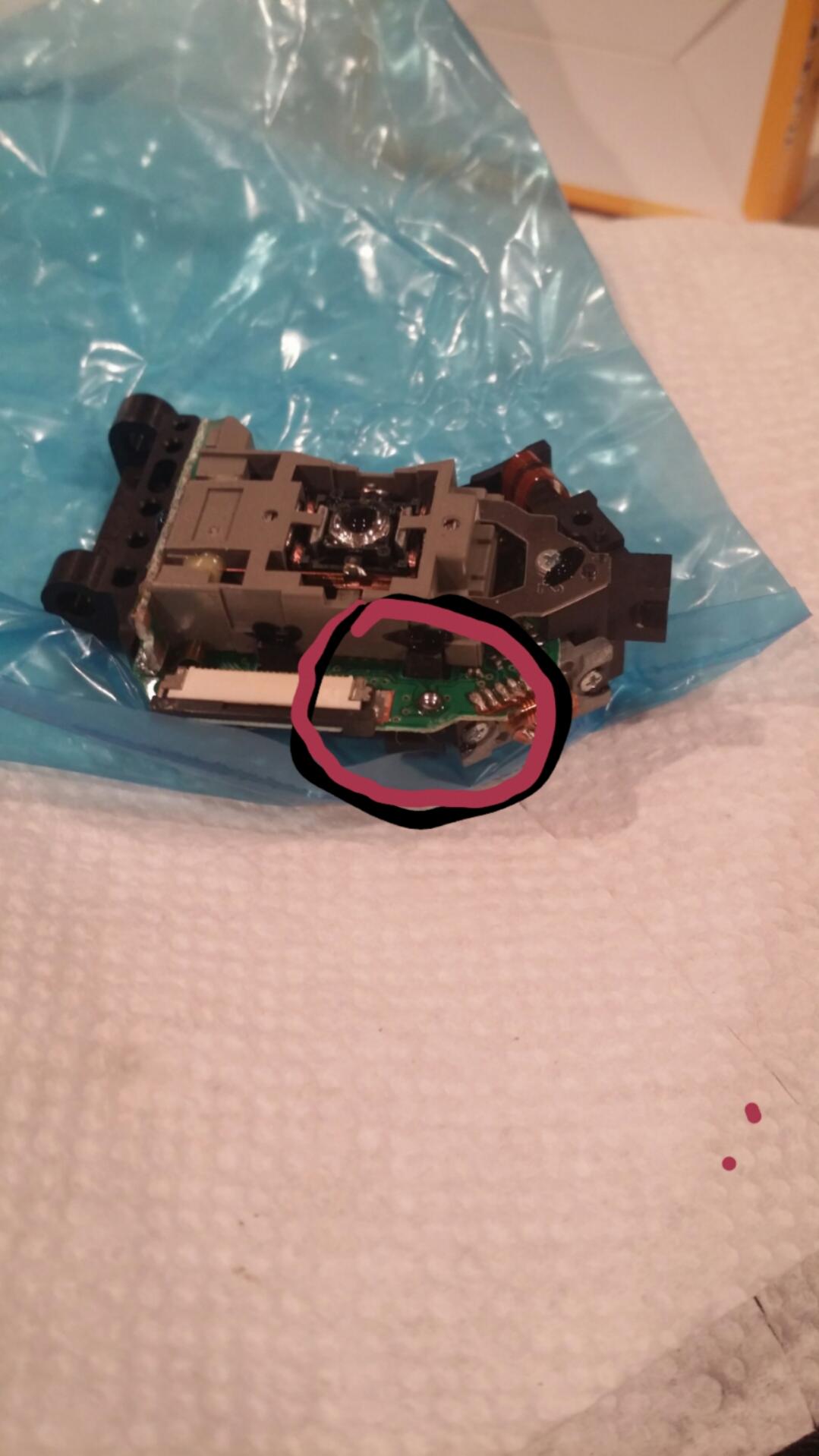

I can't seem to find where to buy the complete drive...do they have a suitable replacement unit or does it have to employ the rl-s881?
Is the blob in question circled in my pic? Thanks
Can't honestly tell from the picture... it looks more like an SMD capacitor in that shot.
I thought it was a KSS type pickup (post #4) an so I would actually have to examine one of these to see exactly what it used. Not all pickups do have a shorting blob, and generally those with on-board electronics are the ones that don't... and this looks to be of that type judging by the large flexiprint connector.
It's a krell evo 505...with a raysonic drive. The old laser would skip and have difficulty finding discs.before I took the old one out..I powered it up...the laser would flash red twice.after I put the new one in...the drawer wont close and the laser does not flash at all
If the drawer won't close then it sounds as though something untoward has happened. The laser (if it were shorted by a blob) would not affect the drawer operation.
To remove all doubt it might be worth just quickly putting the old pickup back, but whatever has happened, its not the laser diode as such causing the drawer problem.
Thanks for your help.maybe it's a dud Chinese laser .is there a replacement drive I can use from another manufacturer?
