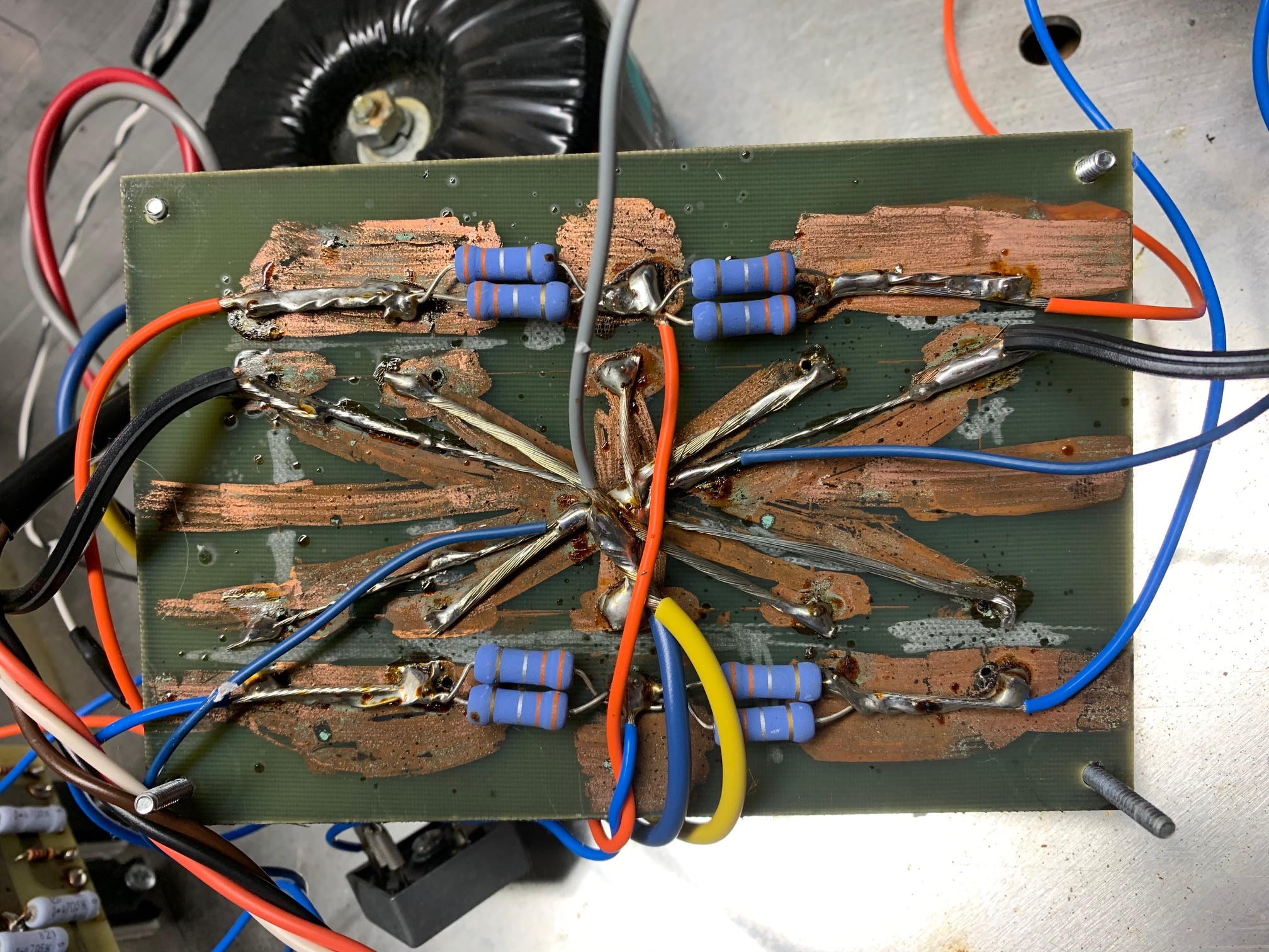

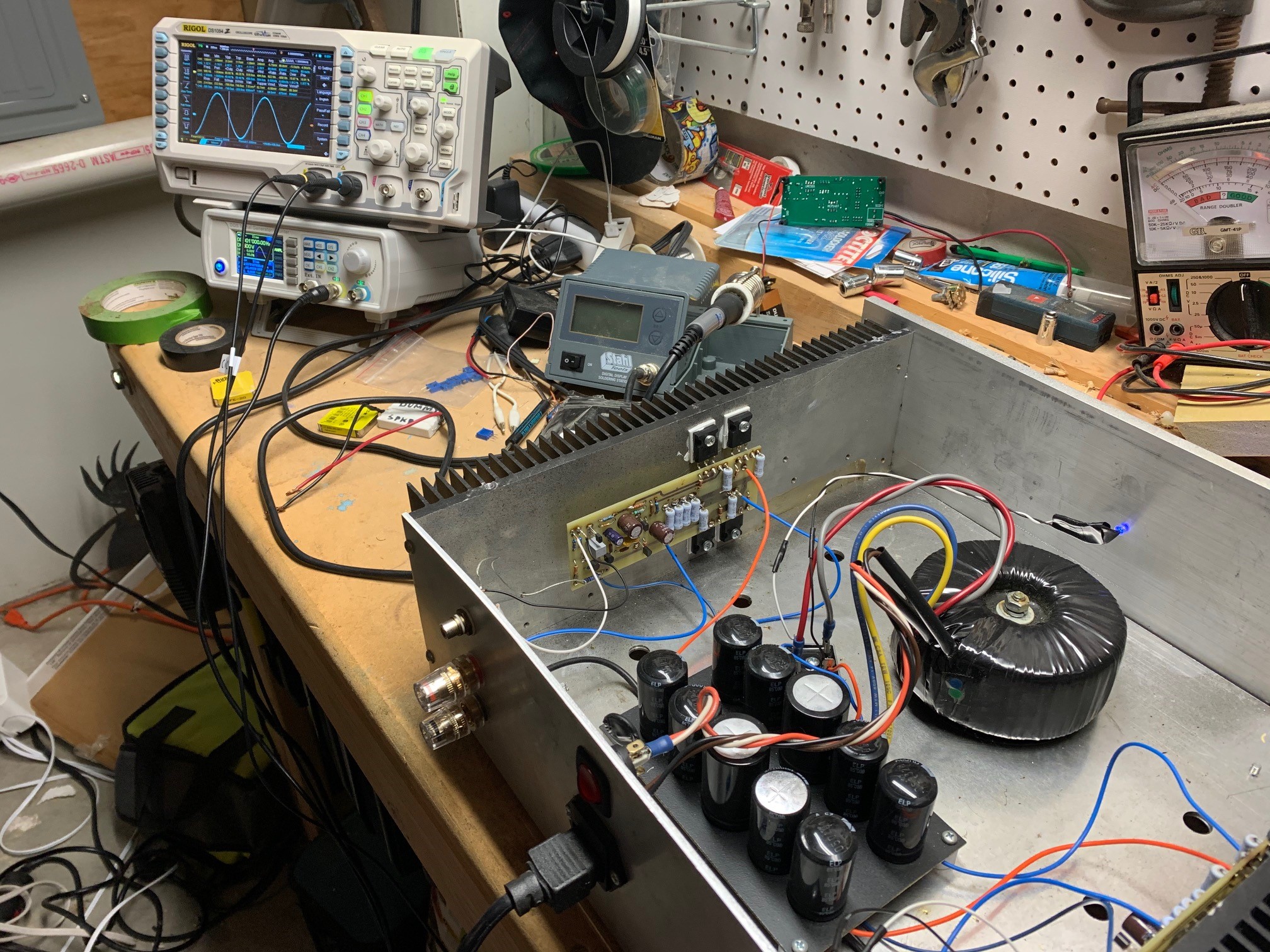

I first signed up for DIYAudio when I was trying to fix hum in 2 Rawson Aleph J mini amps built by Rawson. After lots of reading, learning, and coaching I got those amps fixed up. Then I did Rawson repair for a friend on his amps. That lead to some F5 rebuilding, and then fresh builds of other amps here.

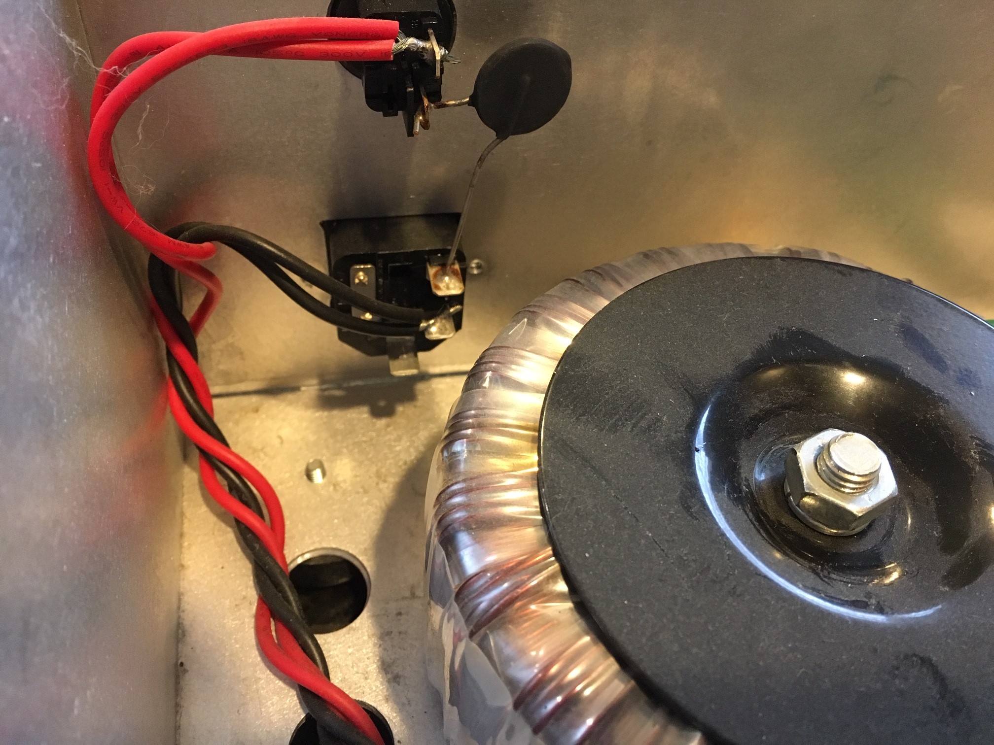

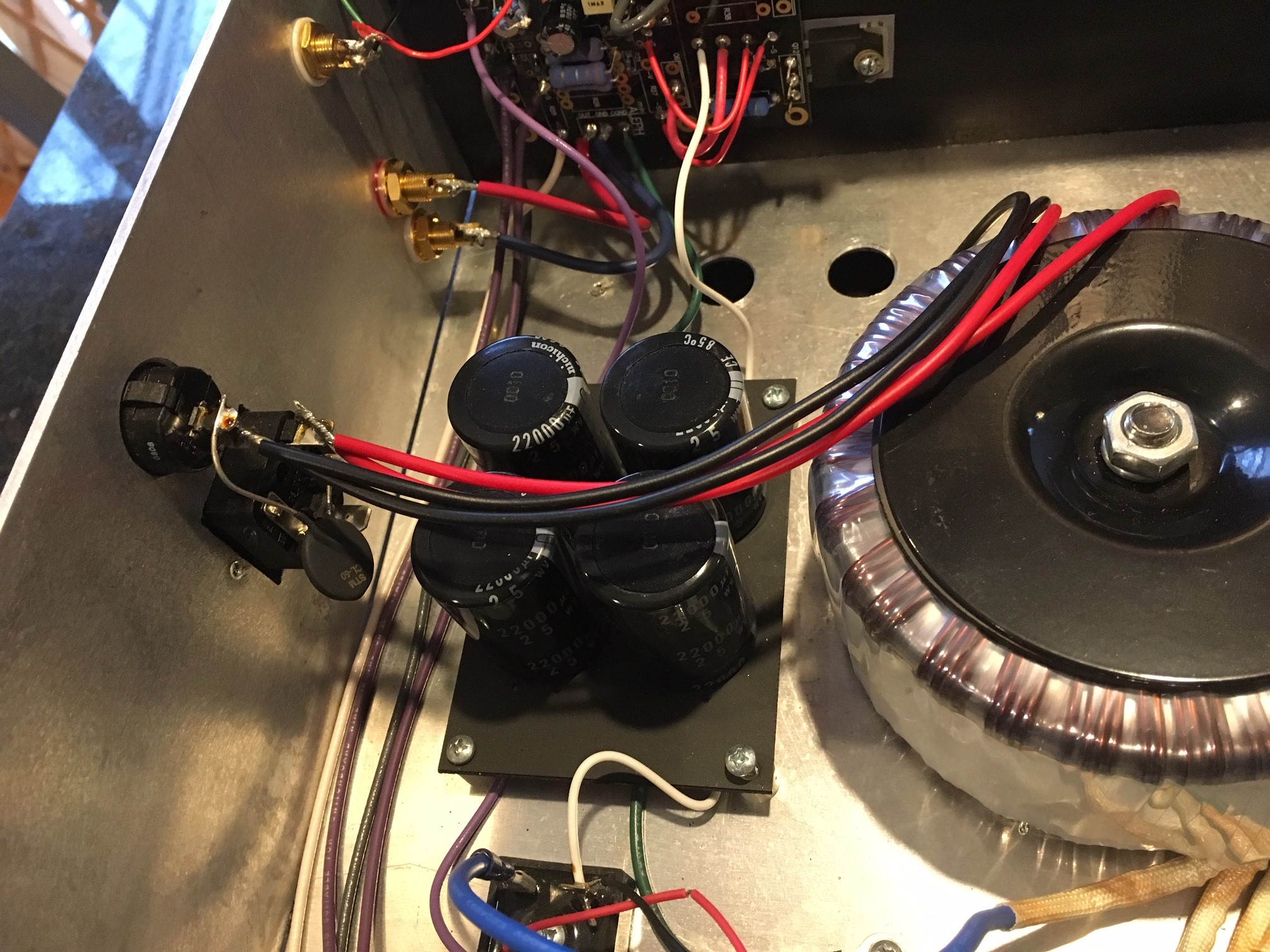

Here is an amp I'll be repairing -
The good:
• Aleph J circuit
• Gain, Bias, Offset measurements are operating to spec, great sound from amp
• Genuine Toshiba JFETs
• IRFP240 Mosfets
• Plitron 300VA 18+18V Transformer
• Dual Rail / Decoupled Stereo Configuration
The not-so-good:
• Grounding: No safety ground on AC Mains, no thermistor
• Poor quality PSU PCB build

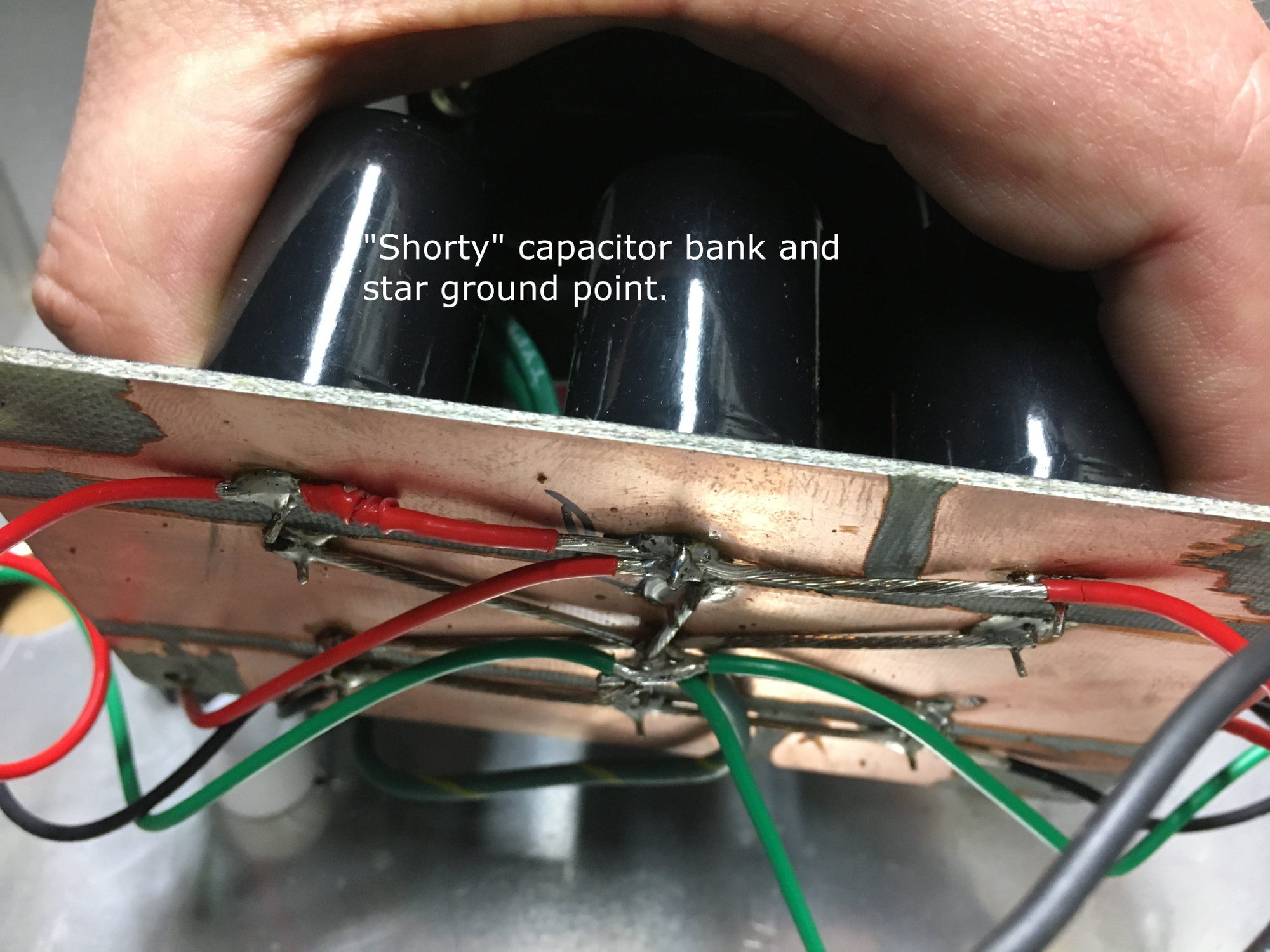

• Single Rectifier Bridge / Center Tapped Transformer
• Loose Power Transformer
• Bulging PSU caps (about to fail)
• 2nd stage PSU caps rated at 25V (~5% from operating voltage)
• Transformer is buzzing/humming
• No bleeder resistors

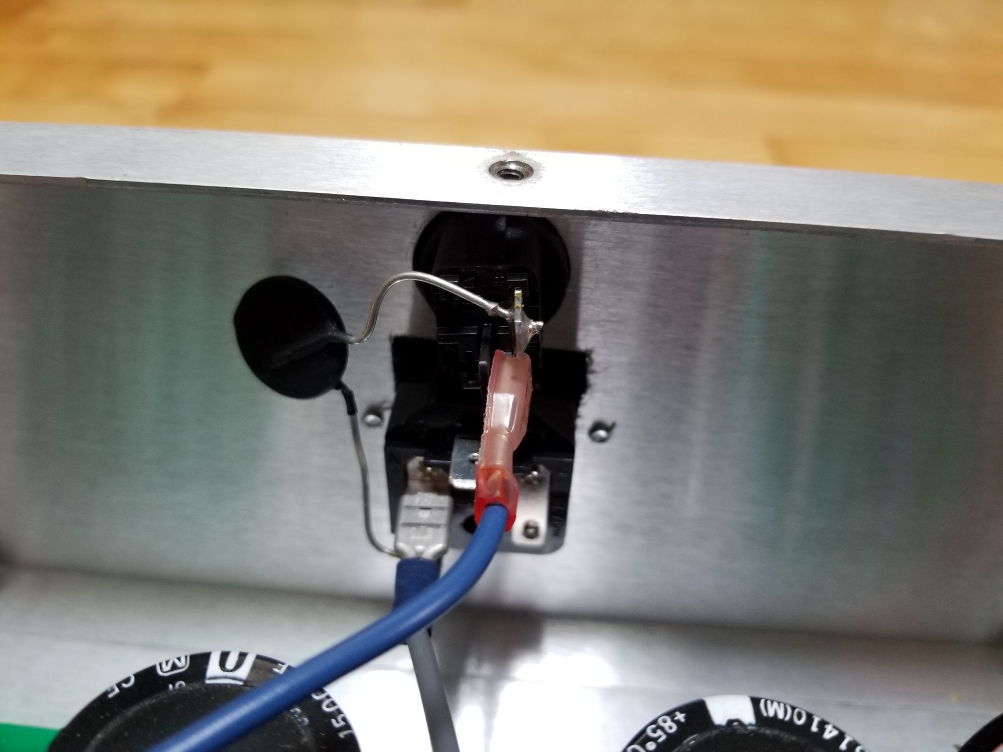

• No A/C mains capacitor
• Wiring: orange for +, blue for -, blue for gnd, black lamp cord for speaker -. Blue and orange look great on Gulf livery Porsches, but not in PSU wiring...
• Single thermistor in the AC mains
What will get fixed:
• Add proper grounding
• New Dual Rail Decoupled Stereo PSU board - Jeff Young board
• Use 35V rated capacitors
• Go from center tap config to dual bridge using Schottky rectifiers
• Add power supply snubber circuit
• Add AC Mains Thermistors & 0.0033 A/C Line Cap
• Transformer - suggest swapping to Antek 3218 transformer
• Update aging electrolytic capacitors to Elna Silmic II’s
• Optional - add XLR's
• Proper wire coloring

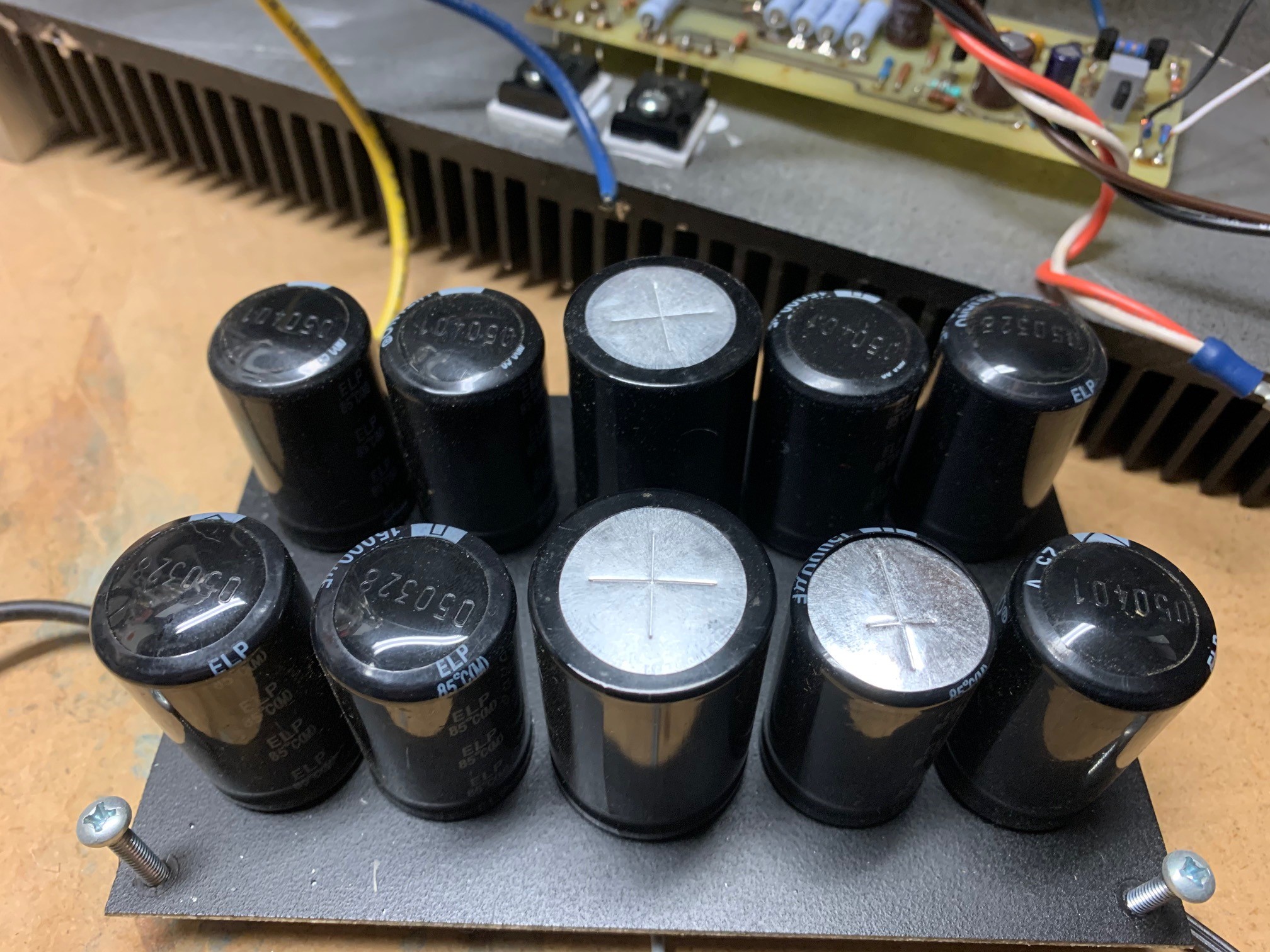

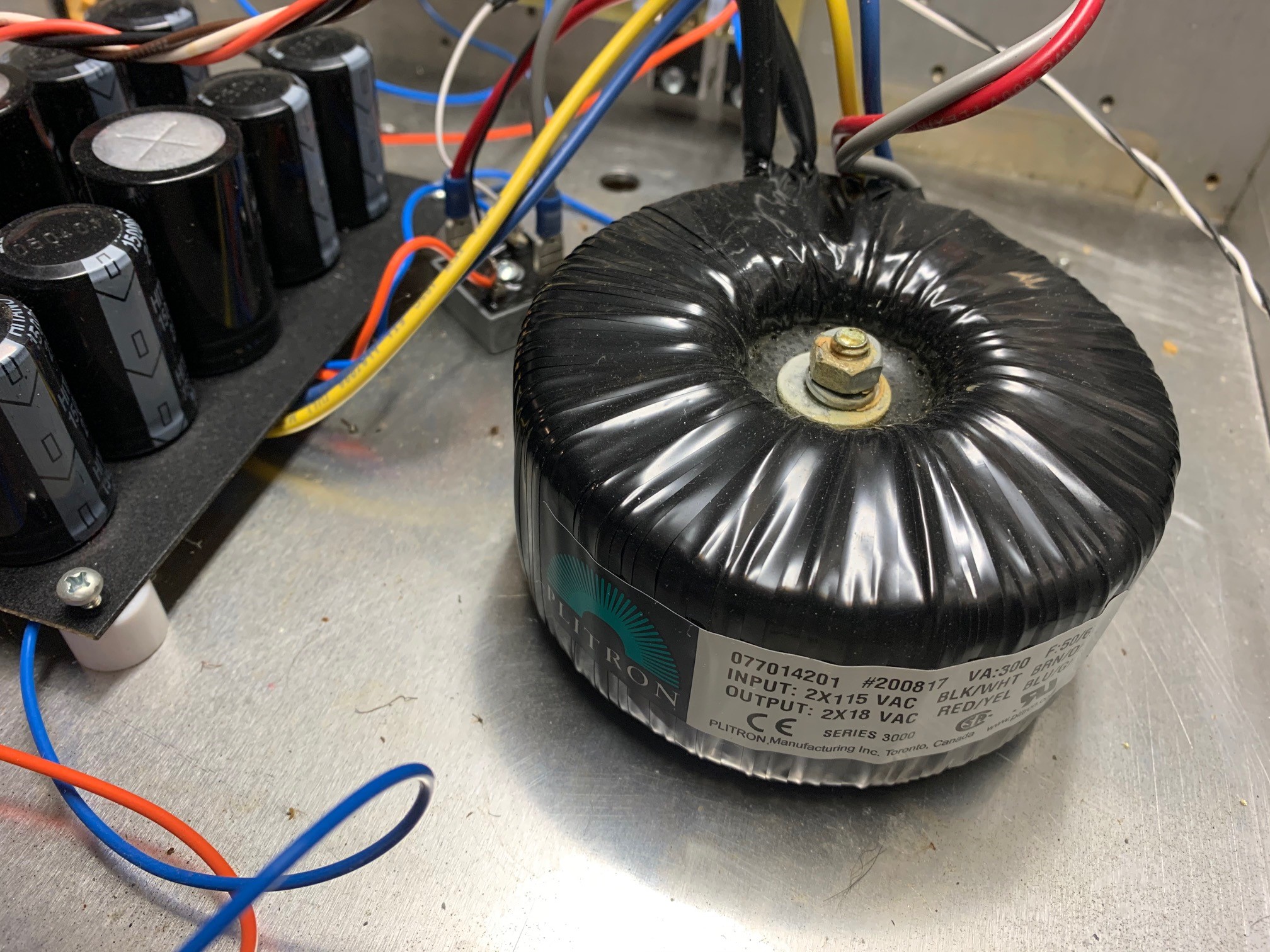

Wow...that PSU is quite something. I have not seen bulging caps like that before.
I wonder if the Plitron will quiet down once you fix everything else. Hopefully
you won't actually have to replace it.
I think you're now a certified Rawson rehabilitation specialist. 🙂 Have fun with
the rebuild.
the rebuild.
I've seen them plenty of times - the cap isn't bulging, rather the plastic
shrink has continued to shrink in high temp environments and make the
top bulge. Usually the cap is still fine, but it does indicate high temps
and freaks people out.

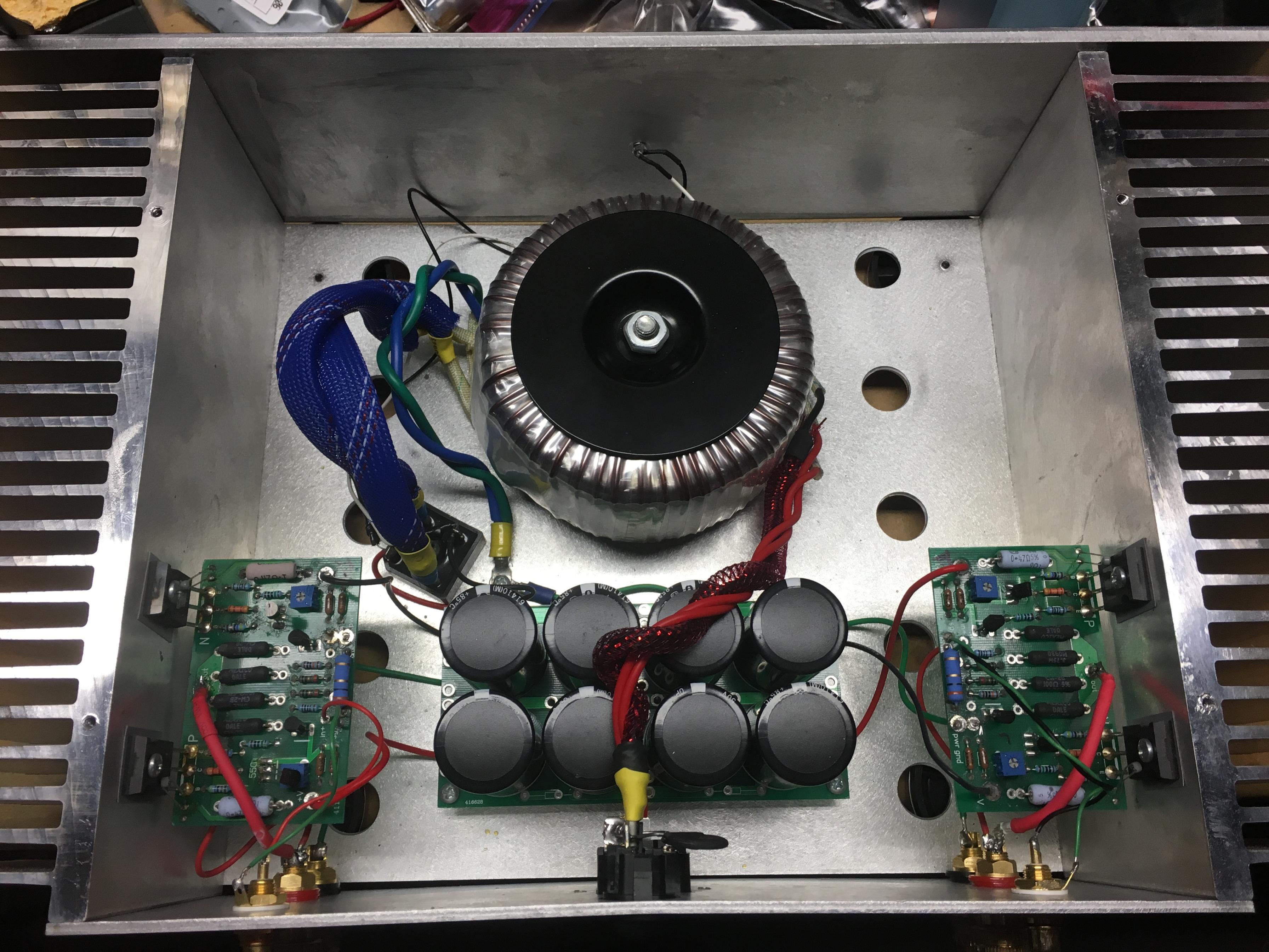

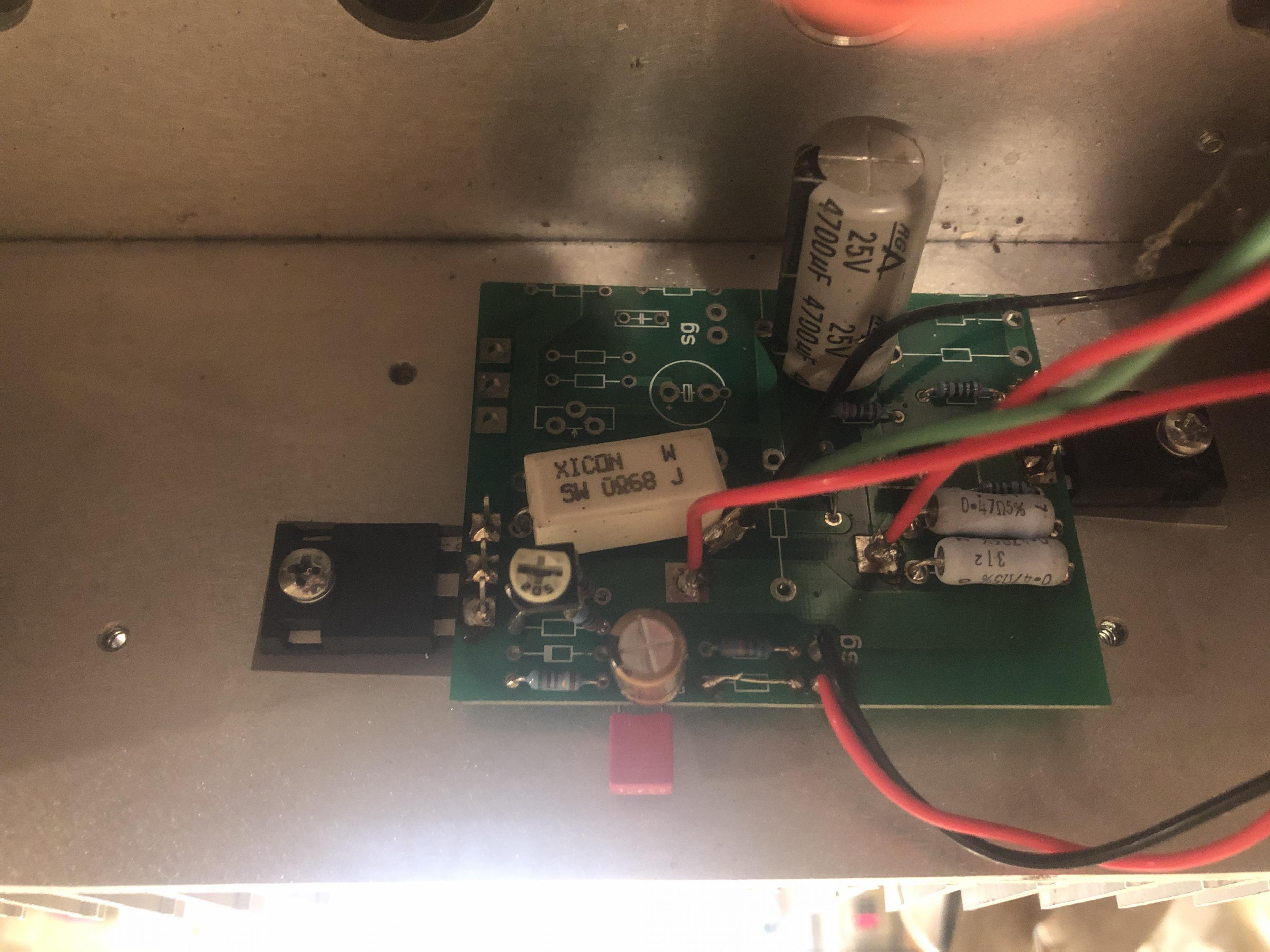

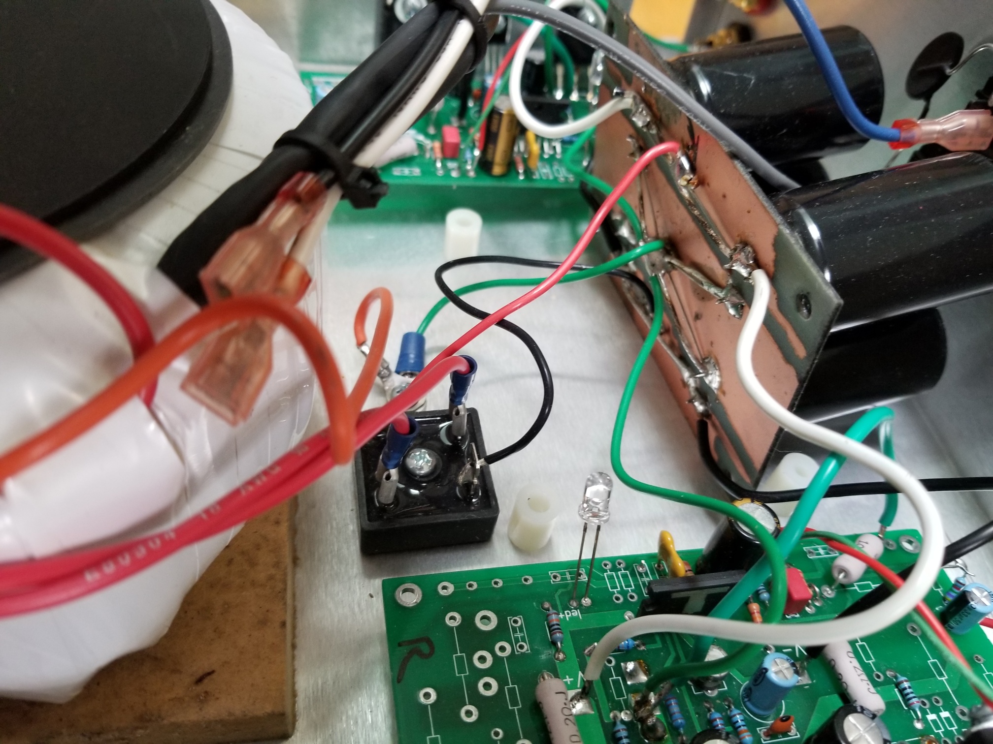

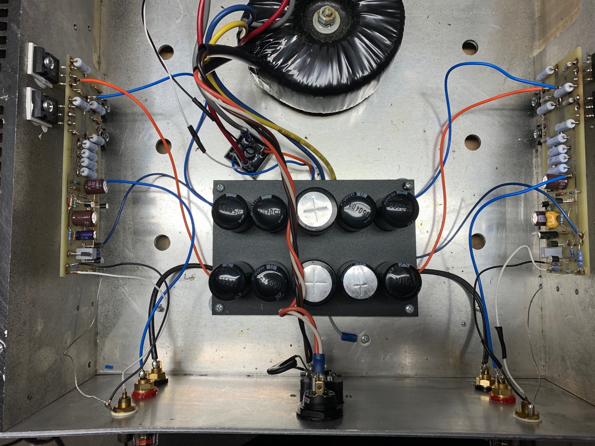

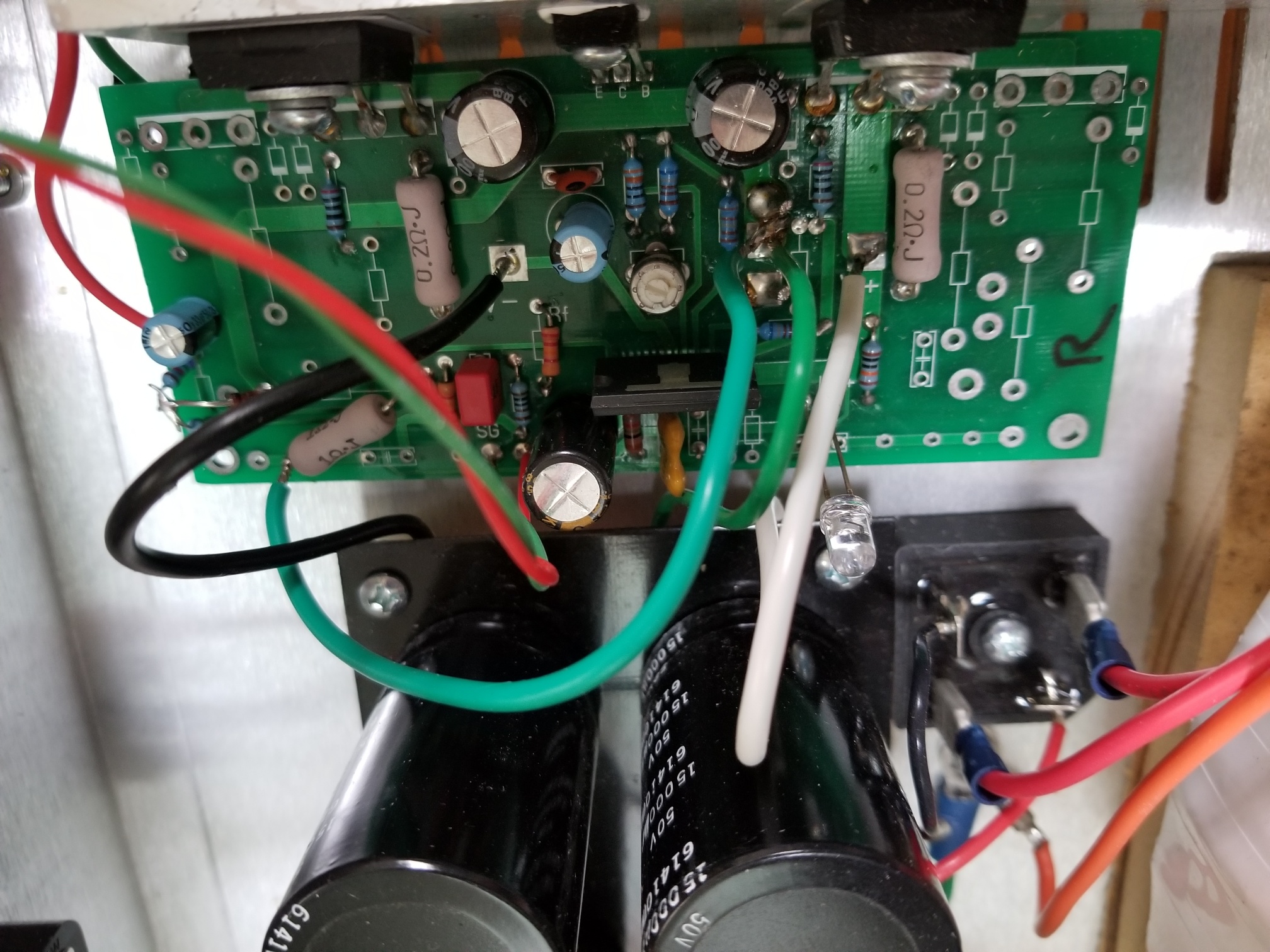

Here are pics of the next one. I don't have it yet. I'll get it after the AJ is done. Any idea what that circuit is?

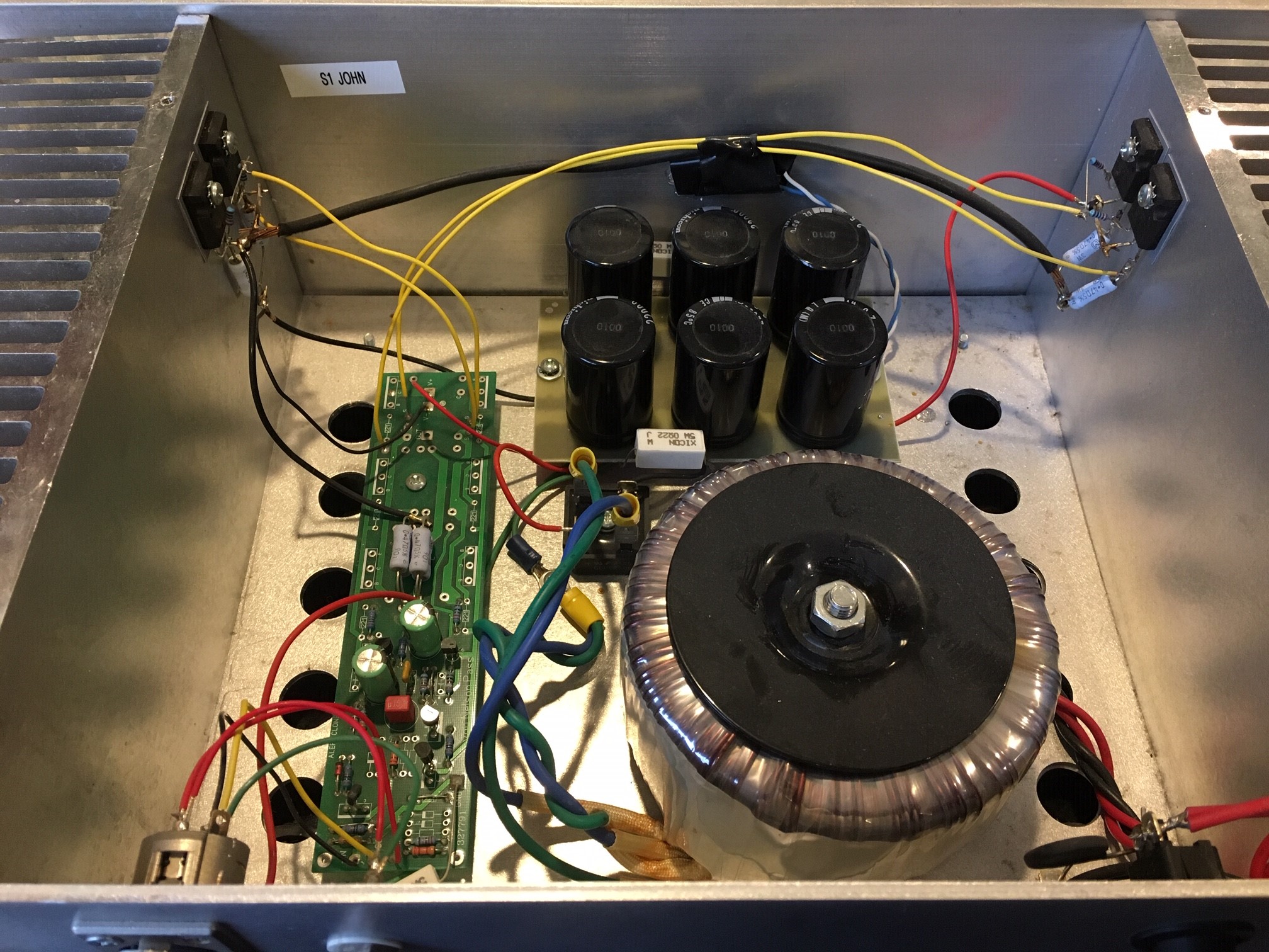

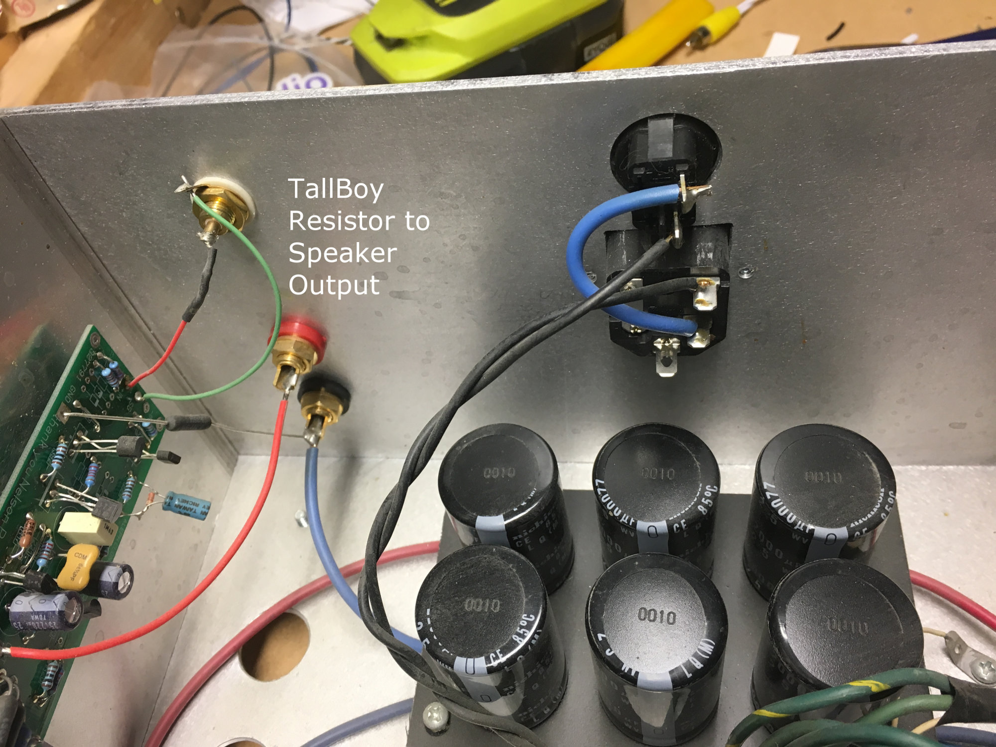

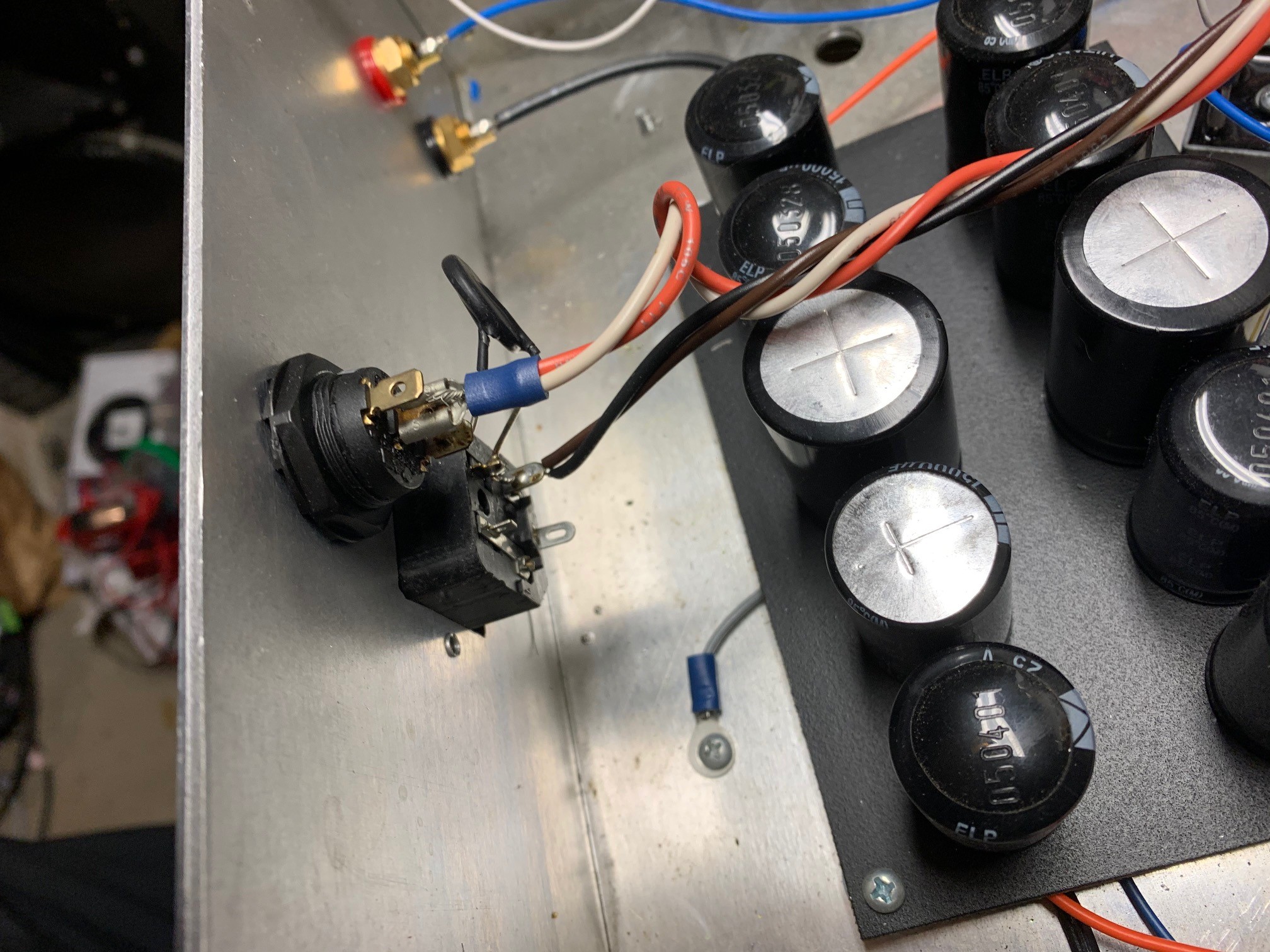

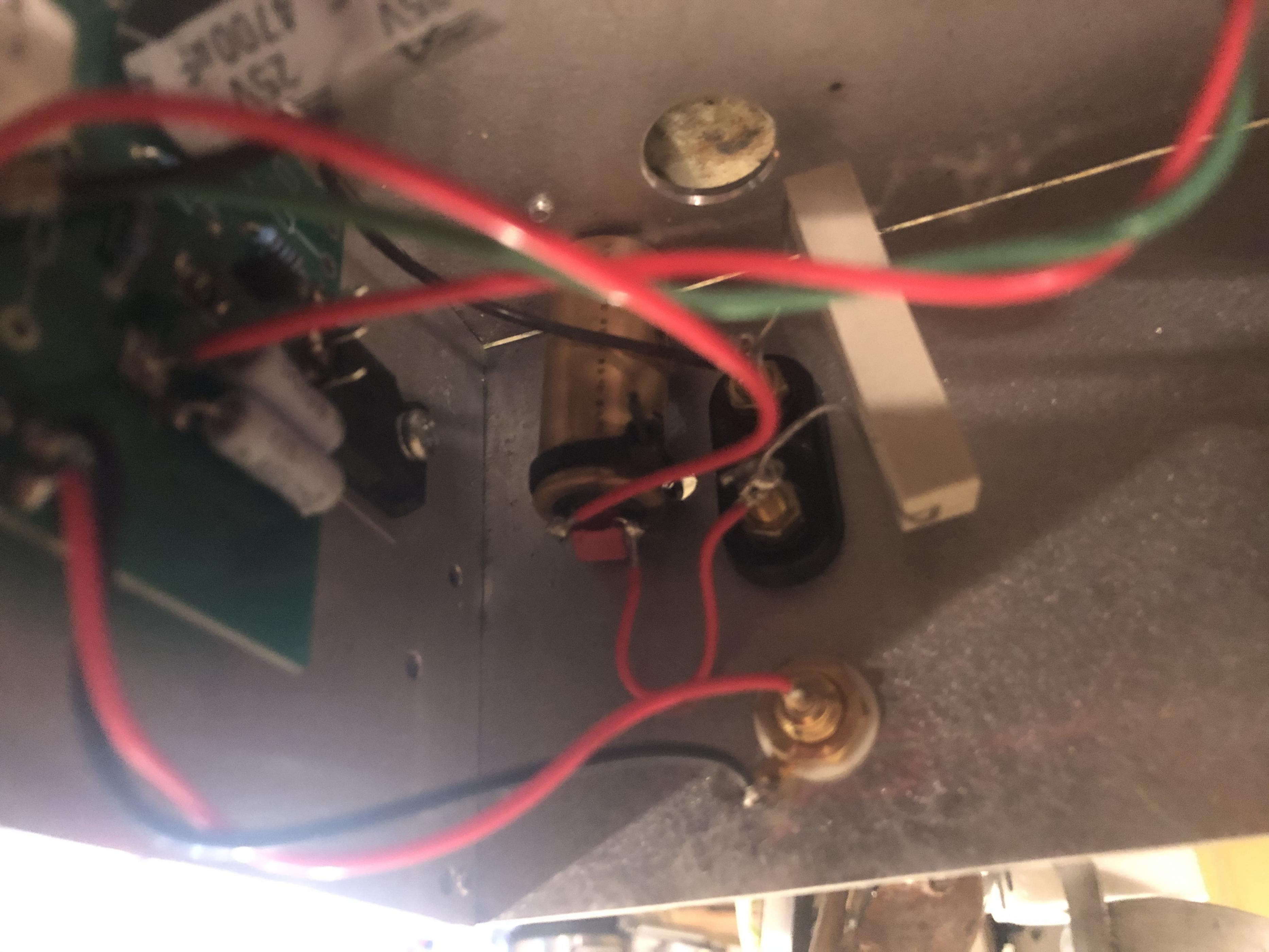

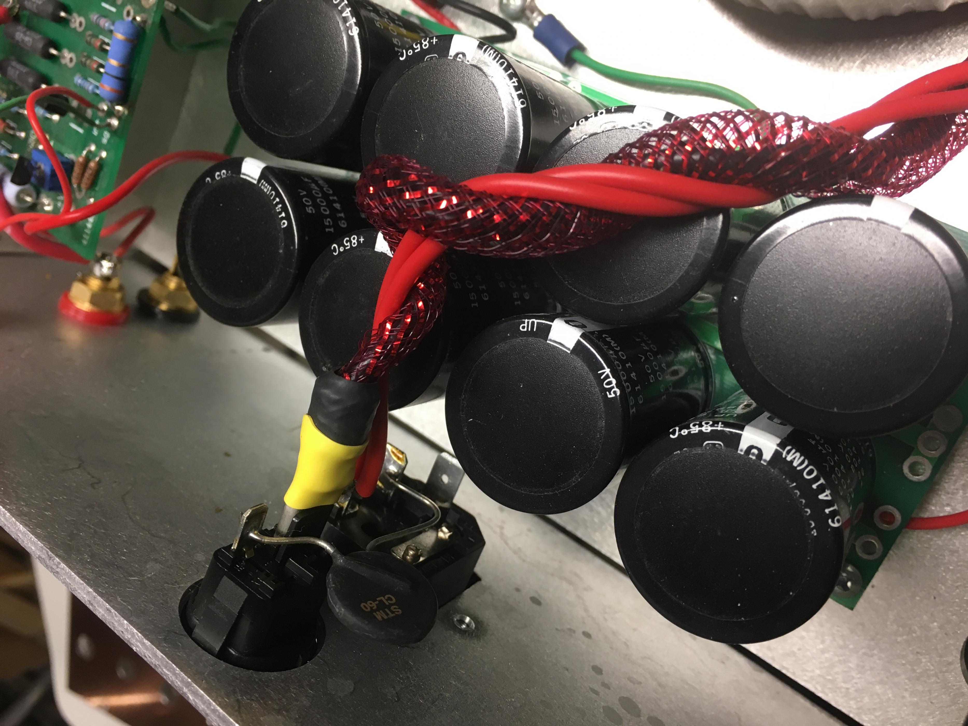

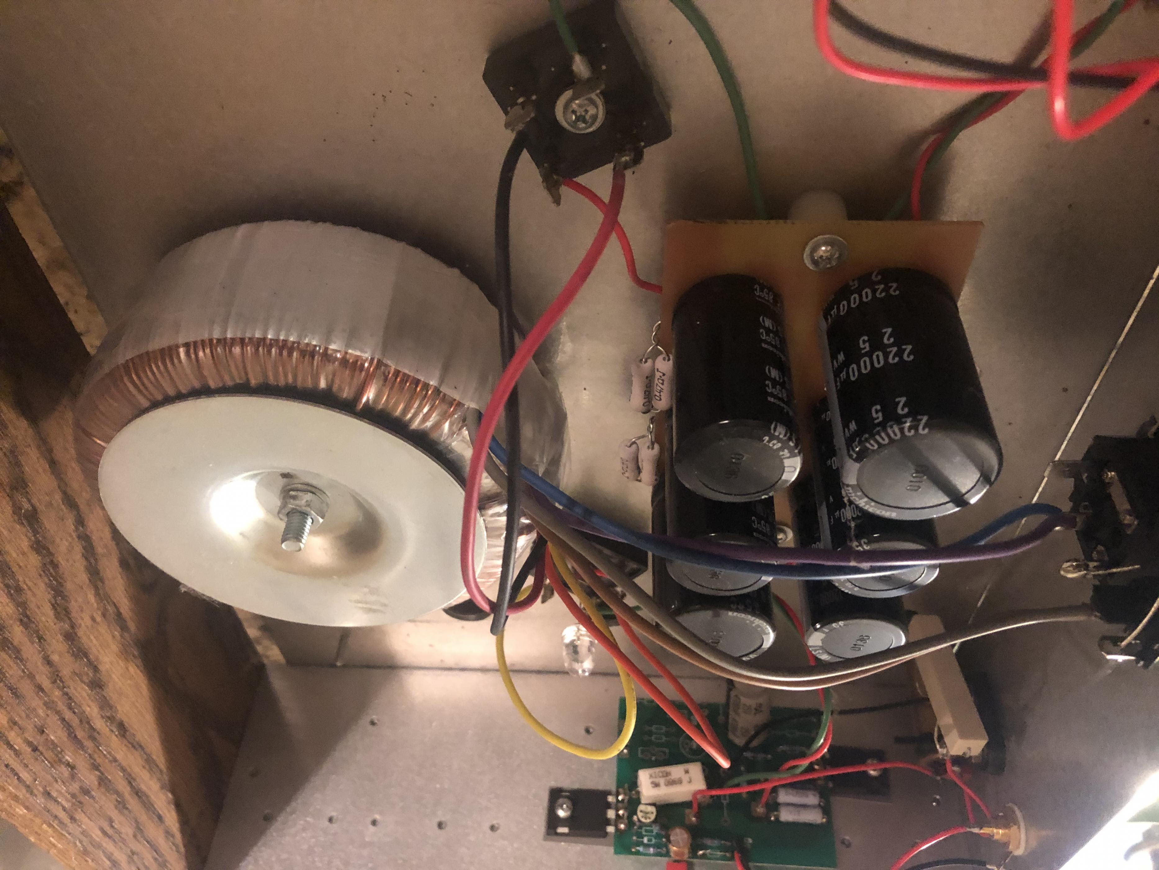

Here are some pix of the first ones I worked on. Before pix.
sorta late , so fuzzy to check - see any of first Fx amps - one of them having fat resistor across output
can't see - is there LU hidden somewhere?
funny - pcb looks as for some other amp initially, cut abruptly
I think it’s a zen from “zen variations 2” with the Aleph CCS.
See figure 6-
Zen Variations 2 | Pass DIY
Yes, PCB appears chopped.
See figure 6-

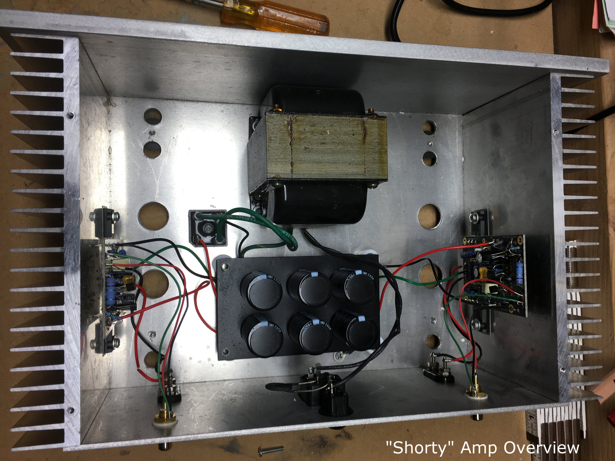

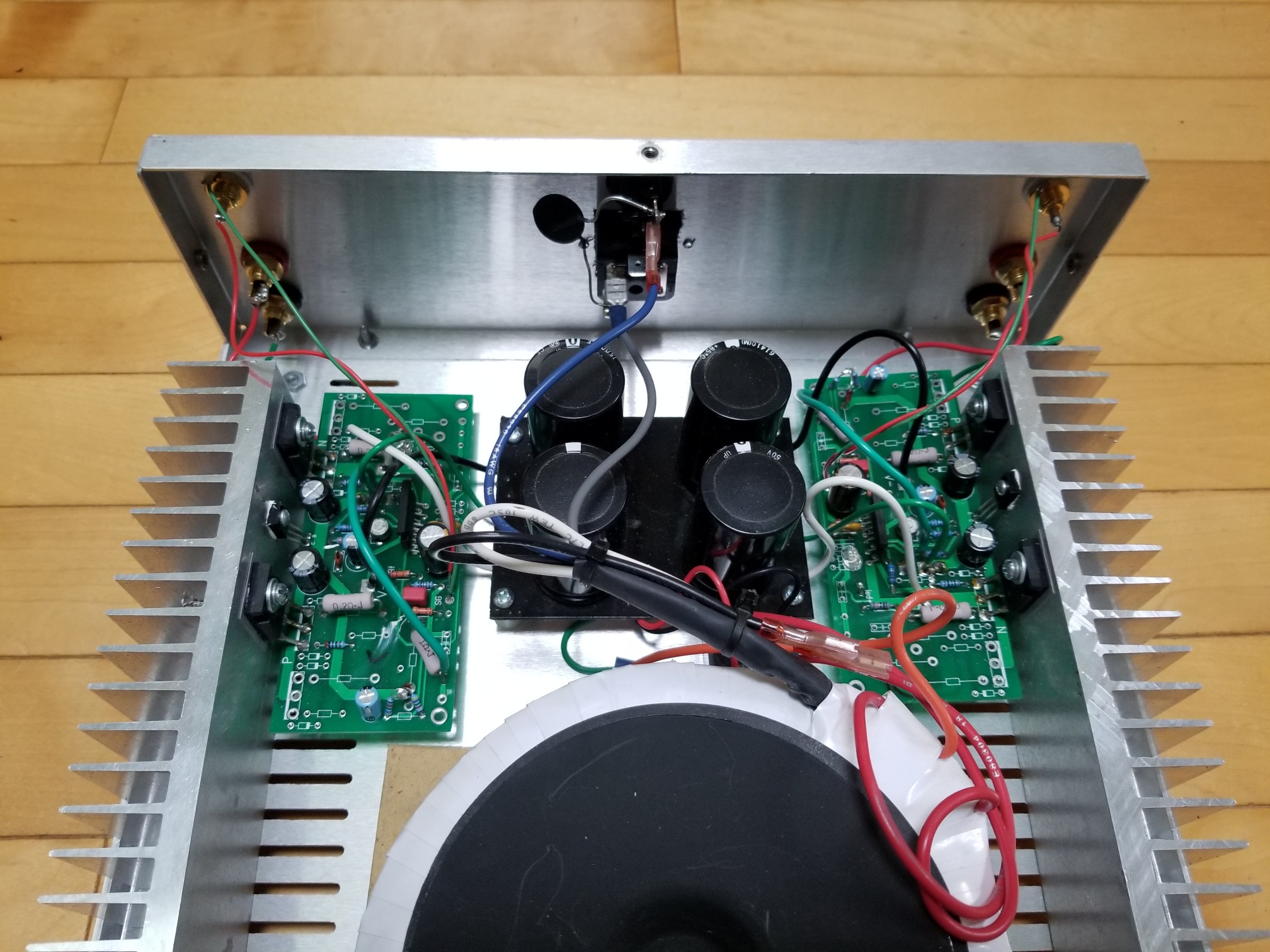

Interior view
Crack it open and share some pix. I’m happy to give some tips, and I’m sure others are, too.

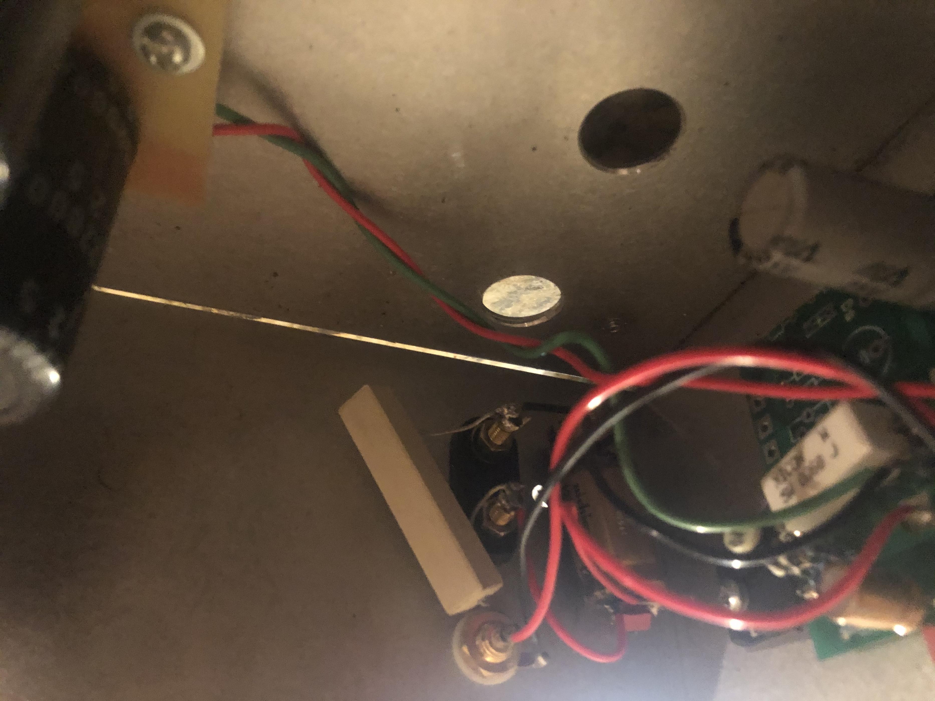

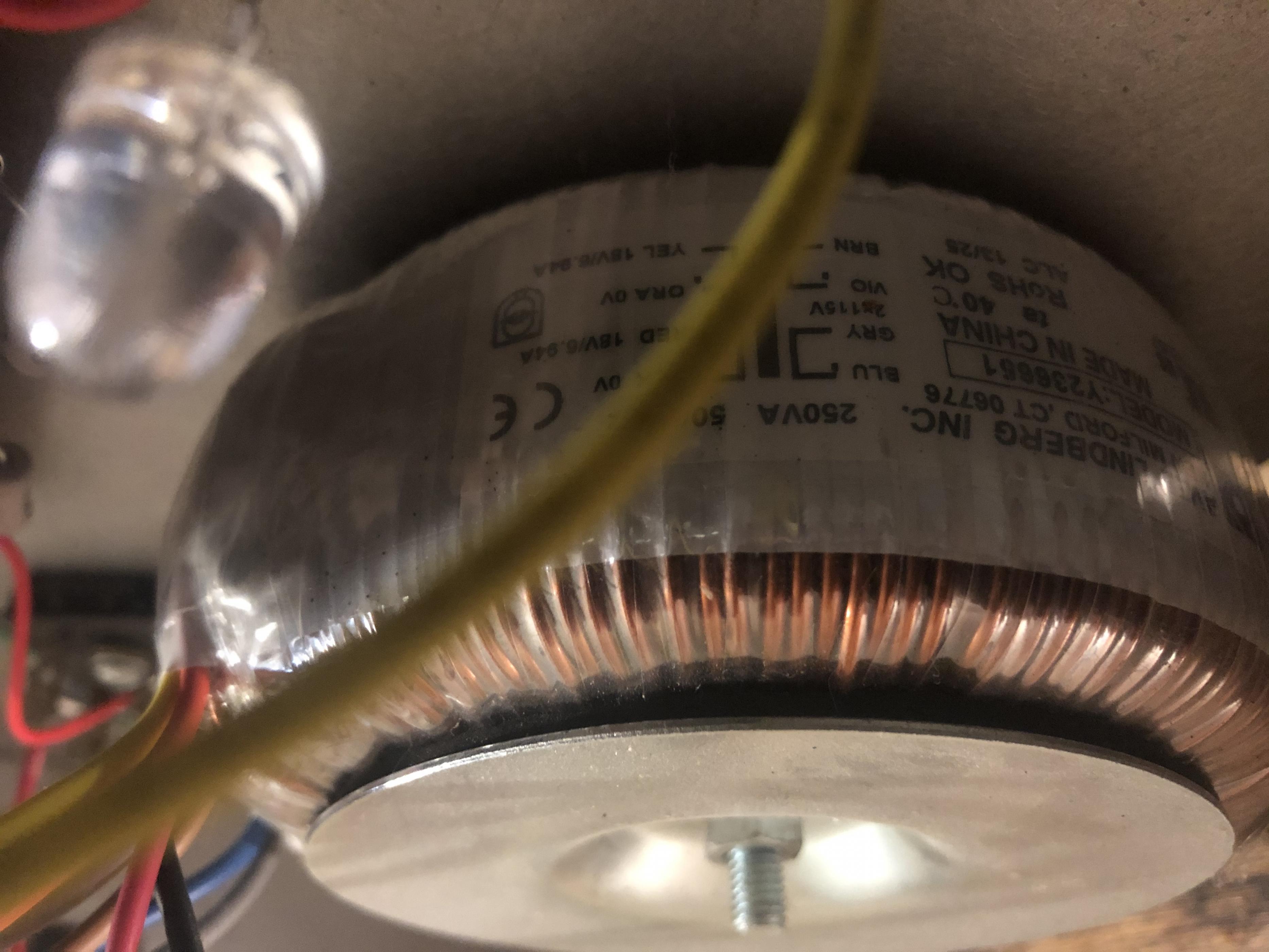

Hi. My first picture upload! Now that I look inside, it is not good. Seems to be no ground and pcbs floating in space...
You have a ground issue indeed. Can you send a few more pix zoomed out? I've never seen the half height heatsinks. Also, that appears to be a massive donut. What boards are those? Or more to the point, what circuit it it? Based on the size of that donut there looks to be little to no room to put a different PSU PCB in there. Can you also get a picture or two with the cover on?
