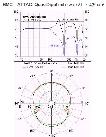

I found a pdf file done by Ridtahler himself. Unfortunately I can't remember the URL where I found it but I will post a couple of figures from it to illustrate my question about ripoles.
Is the ripole about 10 db less sensitive than the sealed boxed version with the same driver ? Check out the figures. I would suggest you google for the original pdf called ridtahler.pdf
Cheers.
Cheers.

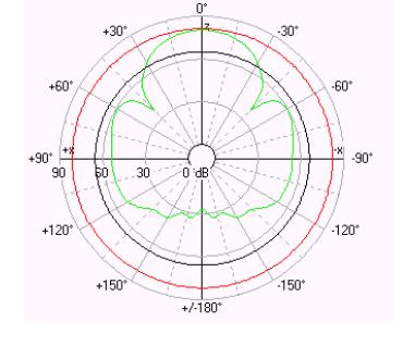

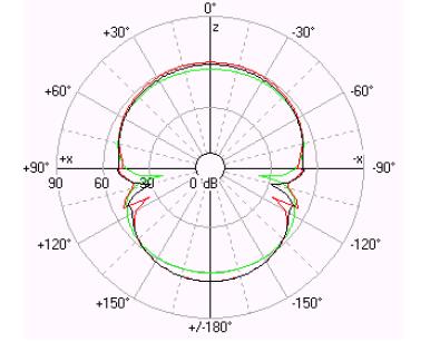

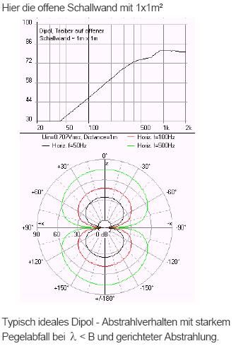

peas and apples
comparison of different dipoles with other principles of boxes is a bit difficult. It depends very much on which parameter You choose to be prime.
There are people for example who just say.....well the dipole gives me a lower SPL for my watts than a CB or BR, others that say..well with one driver its much quieter.
What they don´t compare is, that especially the BMC-dipoles are much smaller than any other box and that there ground resonance is lower than with any other principle. If You´d try to get the same amount of deep base from an equally small CB or BR (which is imo impossible anyhow) they´d have an equally low efficiency....on the other hand building multiple driver dipoles with the same volume as CB or BR You get roughly the same efficiency and SPL max.
Now You might ask, whats the use of building a dipole with 4 drivers and the same volume as a single driver CB or BR? The only answer is....hear and You´ll know! 😉
jau
Calvin
jau
Calvin
Hi Calvin,
No question about what you wrote.
However you misunderstand me. In engineering one cannot gain anything without loosing out somewhere else. In other words we do not get anything for free !
So the Ripole does a great job producing deep bass from a really incredibly small enclosure. So the design looses out somewhere else - perfectly understandable. This will be very high on the WAF list.
I did not put up those graphs to say the system was bad but to find out if it is 'really' as insensitive as the graphs show. Additionally the graphs seem a bit different with respect to levels and so they might not all be taken under the same conditions.
Maybe I'm interpreting them wrong.
It was a post to clarify the performance of the system and not deride it !!
I plan to build and use a Ripole. I want to decide how much power I will need for it . I'm not an efficiency driven person but I'd like to keep power levels down as much as practically possible.
The bottom line is just as you put it - "..hear and You´ll know!.."
Ashok.
Ashok.
