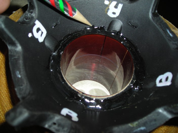

I have found the ratteling noise. aparently it happens offten according to a sterio shop I visited! I was not very impressed with the kicker sub. Had no problem taking whole thing apart! No rips tears or creases!!! I hair dryer for a little heat and a butter knife! Here is a pic of what I found. The glue used to hold the former to the flower cup as let go.

Great job skooter! Persistance pays off.
Maybe a better adhesive would correct the problem and stay together for you? Can you clean off the existing glue?

glad you found the problem, its a good thing to sand a bit the ''to be glued parts'' that's what i do when repairing this subs.
shorting ring or braking coil
I have repair subs with braking coil, IMHO and from what i have experience it is never a good idea, they put to much to stress to the cone (I think its an old school RF SPP184)
yeah take his advice and sand the parts down a bit, you need some texture for the glue/epoxy to grip.
What glue on cone to flower cup
Tred exposie on the cone to theflower cup but came loose. Lookin at the brand SUPER-GLUE PLASTIC FUSE. sopost to work on poly plastic. Surfaces have been sanded with 80 grit and cleaned with alcohal.
