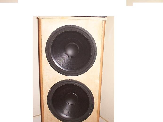

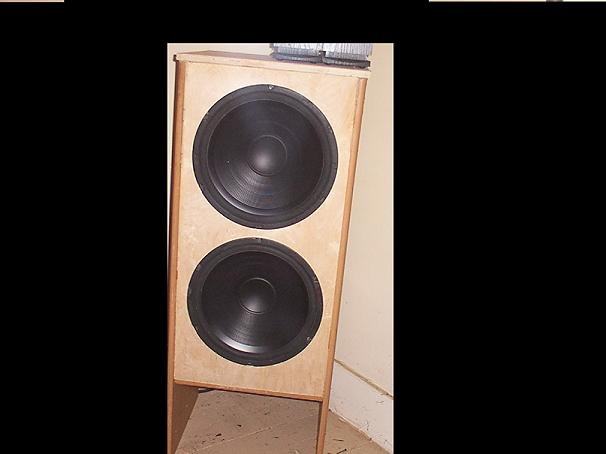

Here a construction pic
Thats not the baffle thats the internal brace
It's sealed.No drone wired in parallel they are 8ohm drivers.
Thanks for the critique,actually it's not finished literally.
The baffle and top you are seeing are raw wood.
And I still need to countersink the woofers(I don't own a router and my 8" 2ways in another thread I did with a razor and chisel definitely not an easy task doing 2 15s.) and make a grill.
Sounds very good not too boomy with a lot of low bass for only a 150w amp.
I could compare this to any sub I've seen or heard for under 700 and they wouldnt hold a candle to this.
Sounds very accurate too listening to some old JP recordings where the bass is very subtle it does extremely well.

Hmm, it should be stamped on the back of the motor, but with its inverted DC not like any RS woofer I've bought, though spec wise it 'reads' like a 40-1035.
I'm curious why you spaced it up off the floor and didn't configure it as a bipole since it's not turned around, firing into the corner. Also, while 4.5 ft^3 sealed looks fine for a corner loaded single driver, for two it's way under-damped.
Anyway, thanks for sharing, I really enjoyed embarrassing relatively expensive consumer systems with my 'el cheapo' RS loaded designs way back when.
GM
40-1035 it is.
Actually it plots rather well a 4.5 cu box (I suspect the box is 4.8 but..)with two drivers on 2 different softwares.
As far as being 3db down at 35hz is not bad being in a corner believe me I put it in the middle of the room and then the corner it was a huge difference.And having 2 drivers still give me a 3db boost in spl.
As far bi-pole Ive had bi-pole and di-pole in this case it was a matter of practicality it would have been much harder to do another way .(Don't ask.)
Oh as far as spacing,well I was never a big coupler no spikes always rubber and in this case decided see how far I could take it with isolation .
And in the real world sounds and feels good too!
