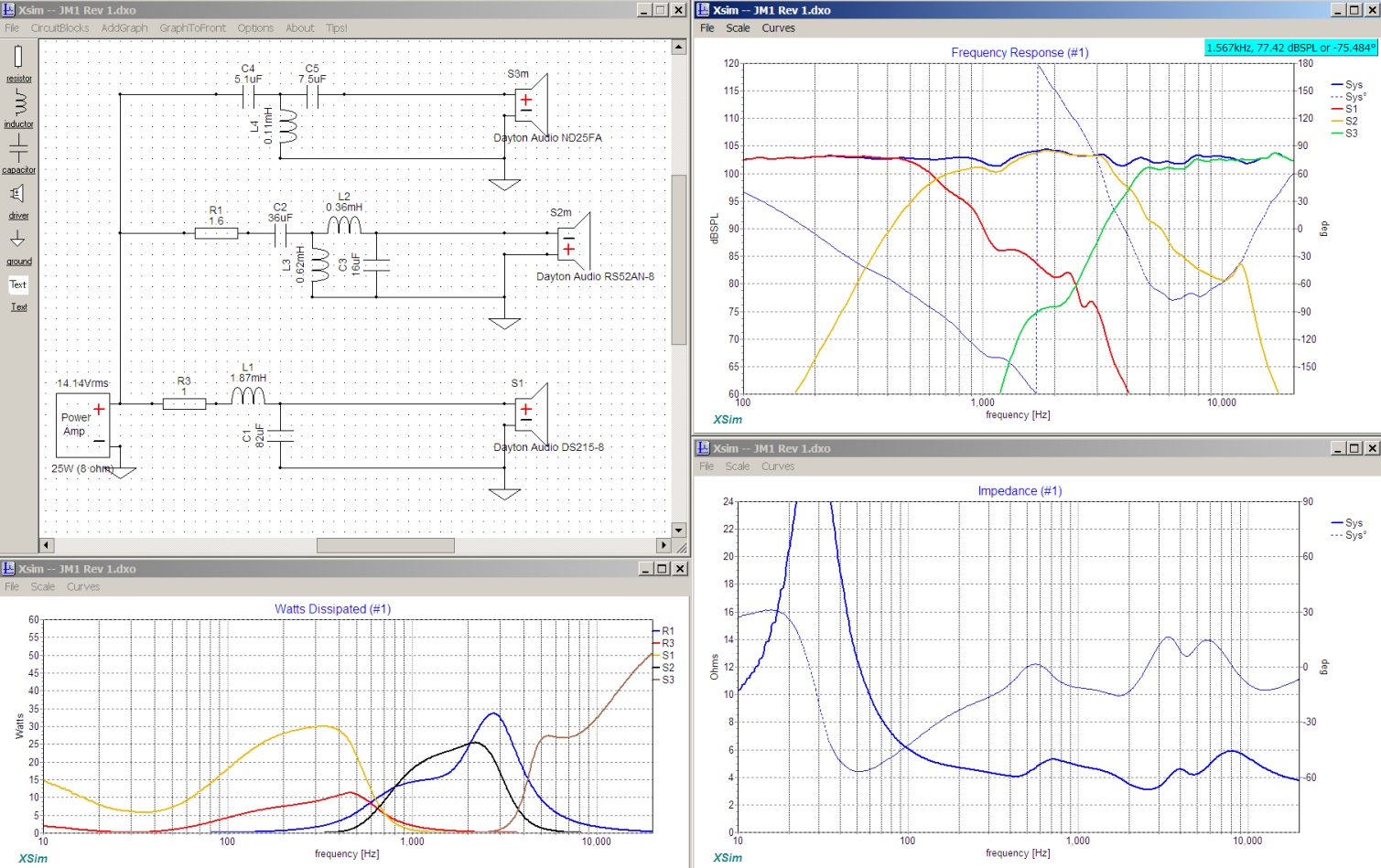

In an earlier thread I inquired about active crossover options, and I am still going that route, (DBX 260) but I really like the idea of *not* having a rack of amplifiers taking up space in my studio. More than that, I am really enjoying learning about crossover design and have been fiddling around in xsim/reading about crossovers for a couple of weeks now.
I'd love yalls thoughts on this hypothetical xover. 2nd and 3rd order to keep the cost and component count down, but the bandpass on the midrange may need something more as there are dips and bumps that I can't seem to tame while keeping the impedance curve reasonable.

Are you using the frd & zma files from the manufacturer?
They're decent for practicing with, but note that once you put the drivers in a real box will baffle effects, you'll get different starting responses.
VituixCad is a little more complex than XSim but can simulate more of these effects if you want to try to get to grips with them too.
This is indeed me just playing around. The resistors in series with the mid and low driver were an attempt to bring the sensitivity down a touch, but I now realize I should be using an L-pad, which probably explains why the dissipation of R1 is so high? I’ll have to play around with that.
I am using the FRD and ZMA files provided by Dayton, yes. I do realize that once these are put into a baffle the response will change, and I will likely have to compensate for that. I was really just trying to see how nice and flat of a curve I could get. I cut all of my MDF panels for this build today, as well as a test baffle which I will use to see how these drivers respond once they’re in place.
As Wolf suggests, it's a good idea to work the sensitivity to fit in with the woofer. This way there are no resistors in the woofer circuit for that purpose (there are other reasons for using resistors there, usually in connection with resonances).
Your woofer will only be so loud in an infinite baffle. If you don't have that and you consider the baffle step you will not need any resistors for the woofer.

Also, I will adjust the drivers around the woofer, thank you all for the input. I am curious how a crossover could affect the on/off axis response? I was under the impression that off axis response was fixed by design of the transducer/baffle. I had no idea passive components could affect response off axis. Any good things to read re: that?
You are correct about that, but there are a couple of small but important exceptions. One is that you 'blend' the directivities when you decide the share between the different ways, and it is possible to make good or not so good decisions there.
The other is that they interact due to their physical separation and you get lobing. A crossover has a hand in how this plays out.
If you are using the manufacturer's curves, they are most likely to be 2-pi responses. Also known as infinite baffle responses. This is what STV was getting at.
You are going to put these drivers in a box. At low frequencies the box is a free-space radiator, also called 4-pi. At high frequencies it is a 2-pi radiator. There is a 6 dB difference between a 2-pi and a 4-pi radiator, even with the same energy. The transition region from 4-pi to 2-pi is very broad, usually spanning about 3 octaves.
In your case, using published data to make a hypothetical crossover, you should try to get a smooth 6 dB drop from 100 Hz to 1000 Hz, and then a flat response from 1000 Hz on up. This will approximate the baffle step. The result (in theory) would be a flat response for the box.
To achieve this, get rid of the woofer series resistor, and increase the inductance until you get a 6 dB down slope from 100 to 1000 Hz. Then add resistance to the tweeter and midrange to bring them down in level.
Your baffle shape causes peaks and dips in the on-axis response which may not be present in the off-axis. If you design a crossover to be flat on axis, you have inadvertently compensated for those peaks and dips. The off axis response will suffer. In the vertical direction, there is additional driver offset and cancellation effects.
