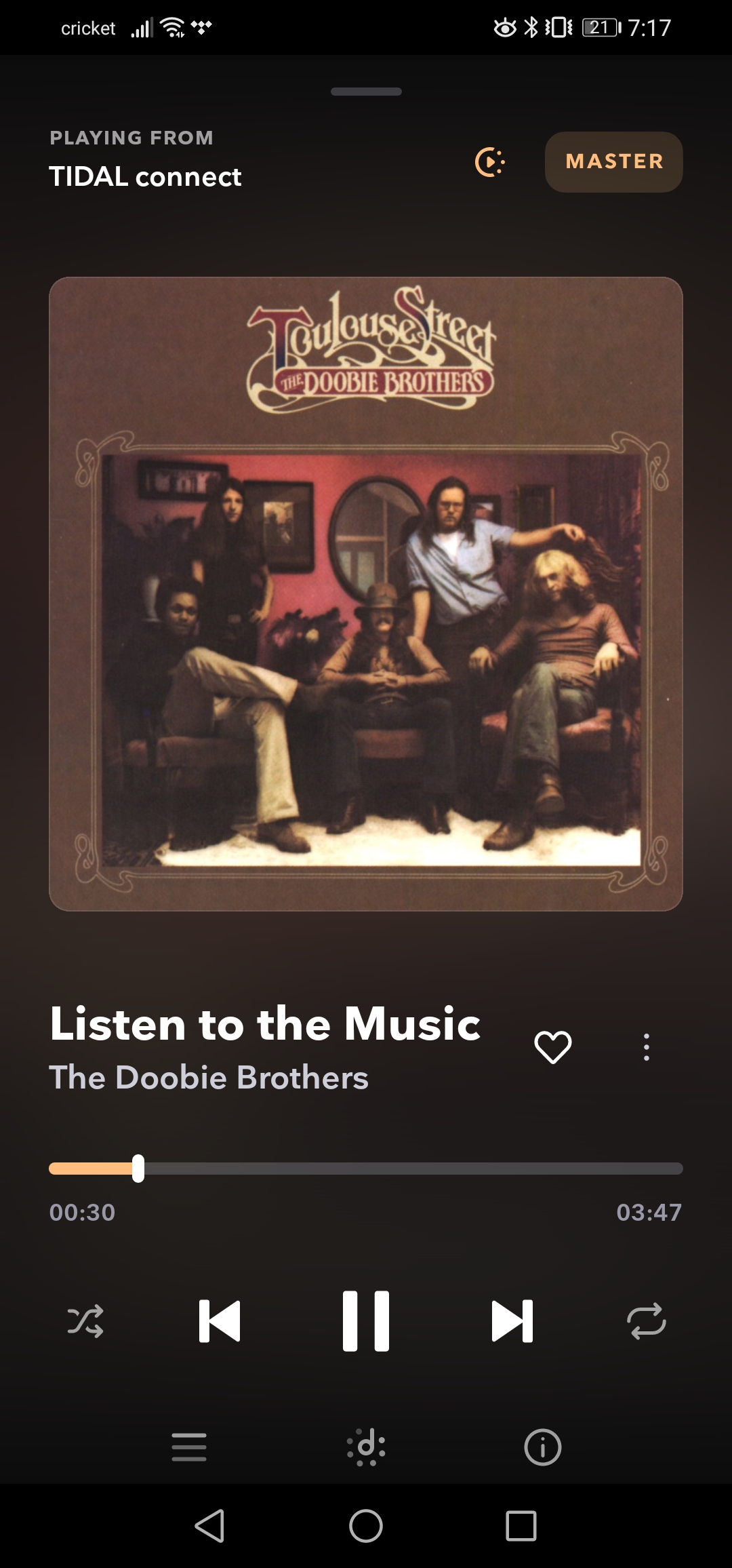

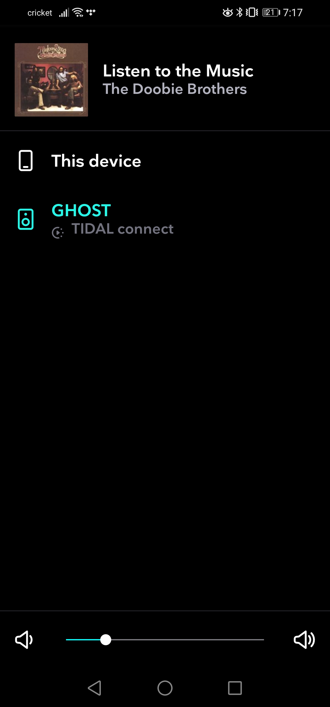

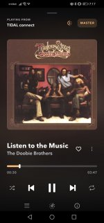

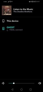

I use my own built all-in-one system with tidal connect and it is working ok so far.
The app seems buggy on the phone for the controling, but when it's working well, the sound is amazing.
Some use an additional volume control app, but I have a USB volume control connected to the Pi.
Just the lite version of RpiOS and HiTide.
Took a bit to figure out what to do to configure it, but it actually runs better on RPi than on the phone.
The other way is to use shairport-sync from a desktop to the RPi which actually works very well, but you wont get the 24bit master playback AFAIK.
Would you like to share that to help others ?
To install..
curl -sSL https://raw.githubusercontent.com/shawaj/HiTide/main/install.sh | sudo bash
To determine soundcard..
/usr/ifi/ifi-tidal-release/pa_devs/bin/ifi-pa-devs-get
Copy the soundcard identifier from the list and paste it into the file..
sudo nano /lib/systemd/system/ifi-streamer-tidal-connect.service
Mine is IQAudIODAC as follows..

ExecStart=/usr/ifi/ifi-tidal-release/bin/tidal_connect_application \
--tc-certificate-path "/usr/ifi/ifi-tidal-release/id_certificate/IfiAudio_ZenStream.dat" \
-f "GHOST" \
--codec-mpegh true \
--codec-mqa false \
--model-name "GHOST" \
--disable-app-security false \
--disable-web-security false \
--enable-mqa-passthrough false \
--playback-device "IQaudIODAC: DAC HiFi pcm512x-hifi-0 (hw:0,0)" \
--log-level 3 \
--enable-websocket-log "0"

Restart the daemon and check the status..
systemctl daemon-reload
systemctl start ifi-streamer-tidal-connect.service
systemctl status ifi-streamer-tidal-connect.service
Enable at boot..
systemctl enable ifi-streamer-tidal-connect.service
