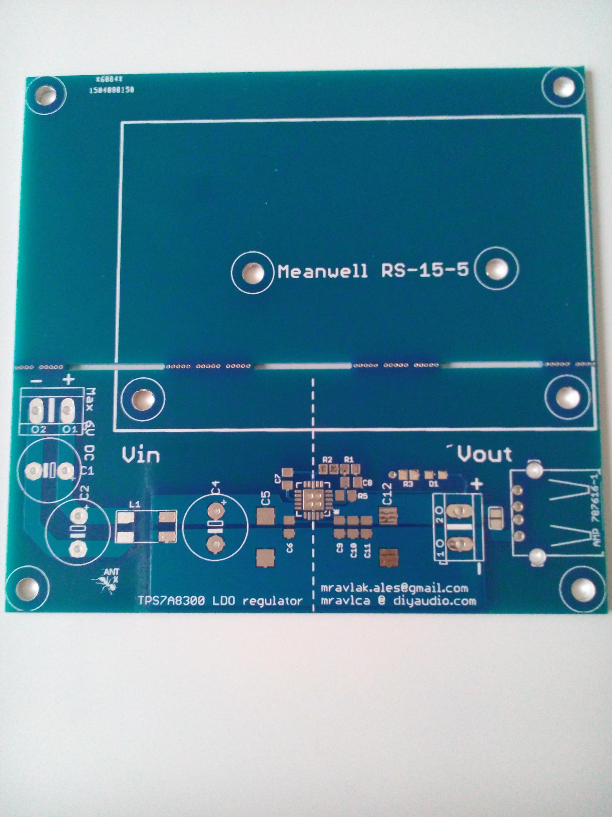

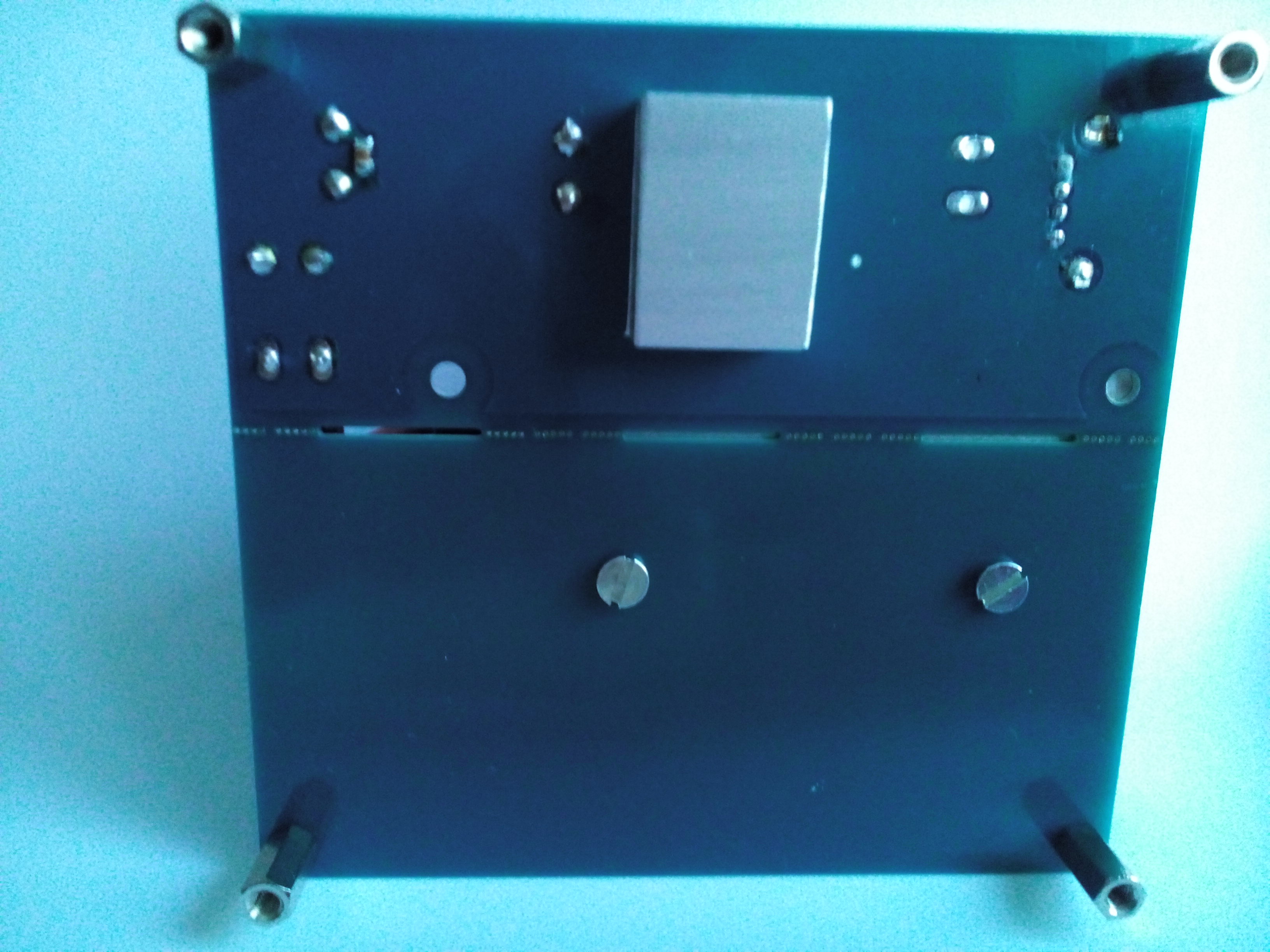

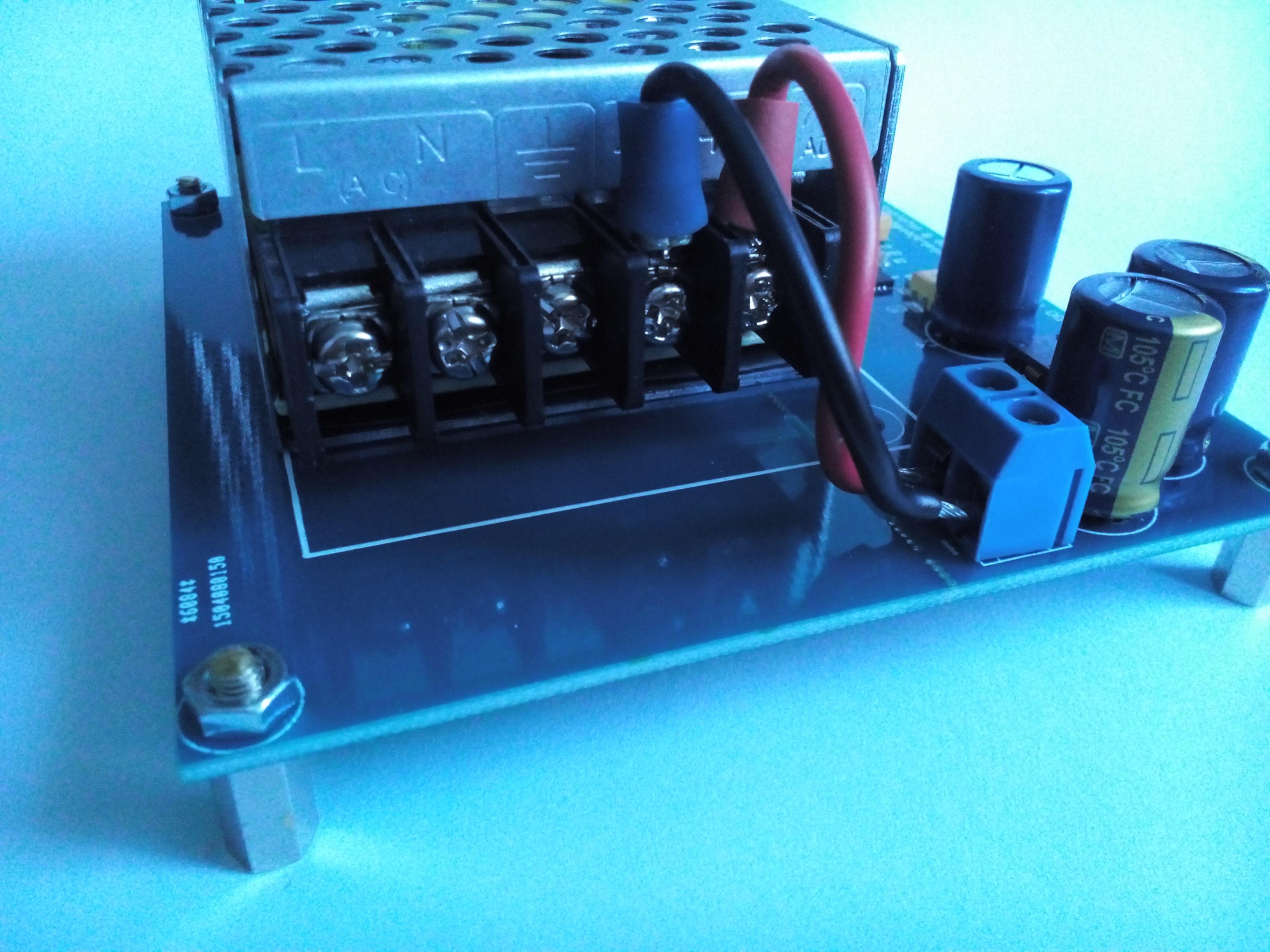

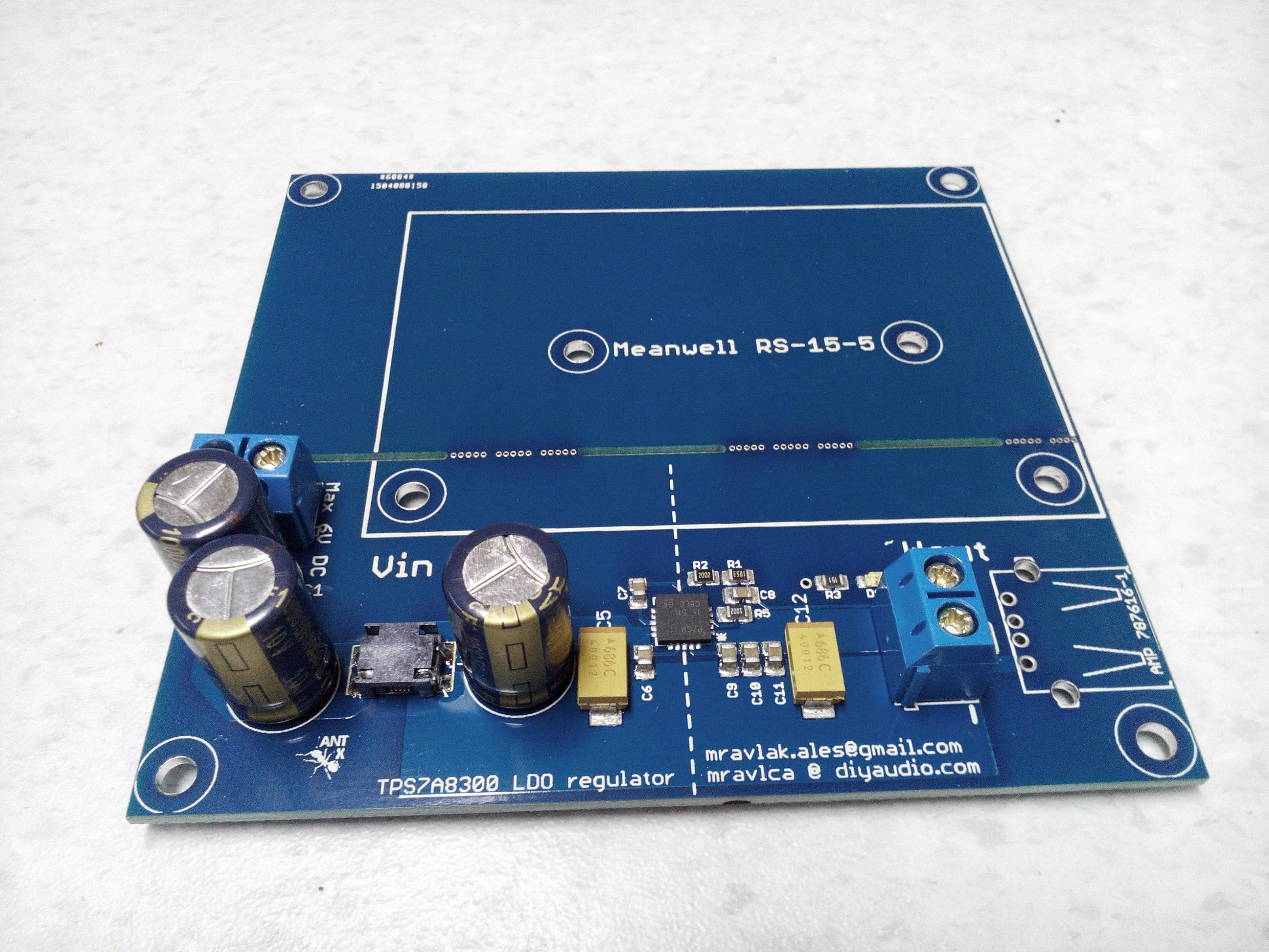

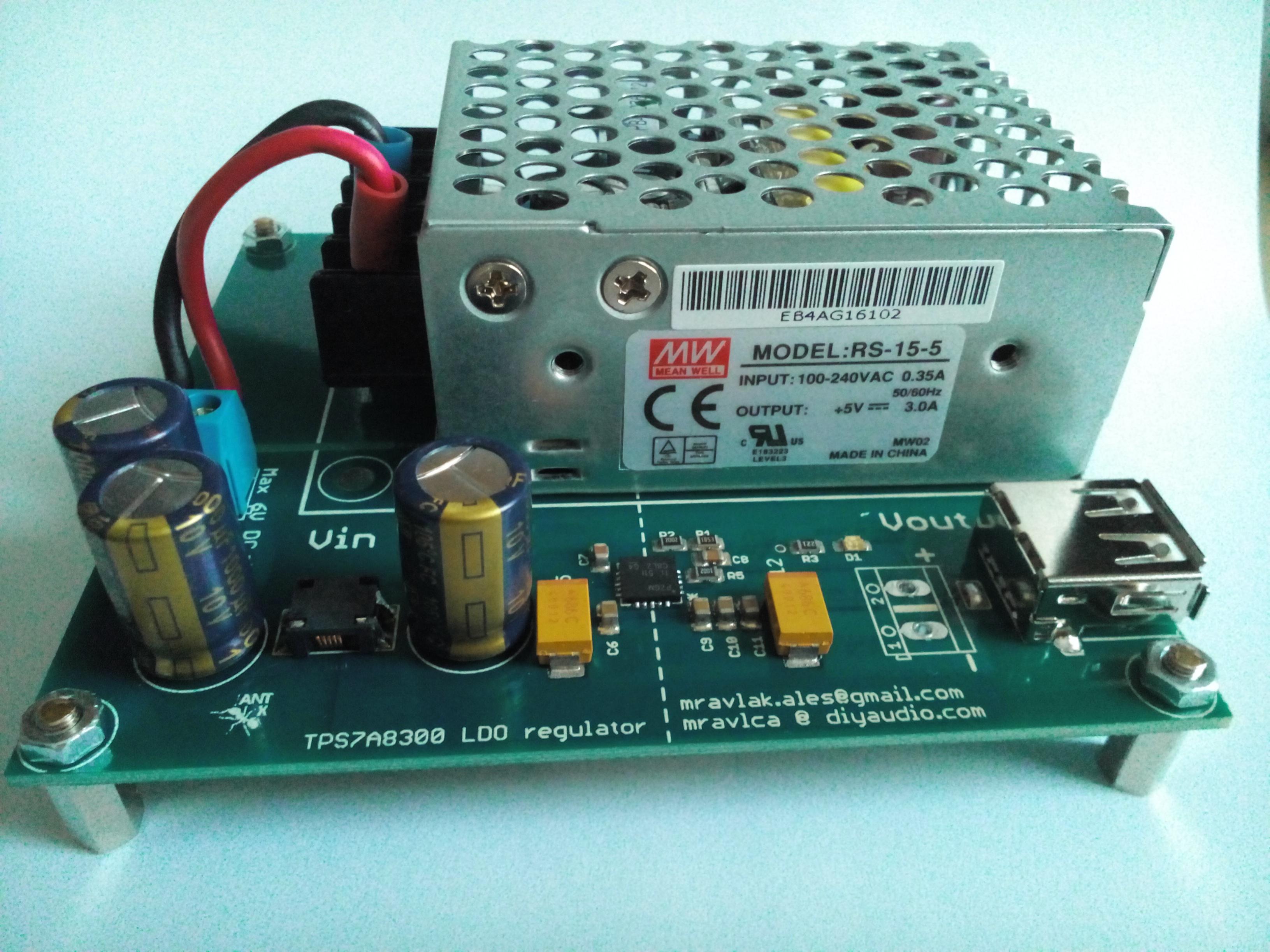

lately I was busy with building regulator for Raspberry Pi 2 player. It is based on TPS7A8300. Because 8300 has very low max voltage input, 6.5V, I used Meanwell RS-15-5 to convert 230AC voltage down to 5.6V DC. Another reason why I used Meanwell transformer is its size. Total regulator dimensions are 92mm x 82mm x 40mm. If one does not want to use this type of transformer, PCB is breakable so the size of it can be reduced. On the output side I used PCB screw terminal, for so called invasive mode of connection and USB type A female connector for noninvasive mode. How it performs in term of sound I can't say much as I am still waiting for I2S DAC board. Once altogher connected I'll report.

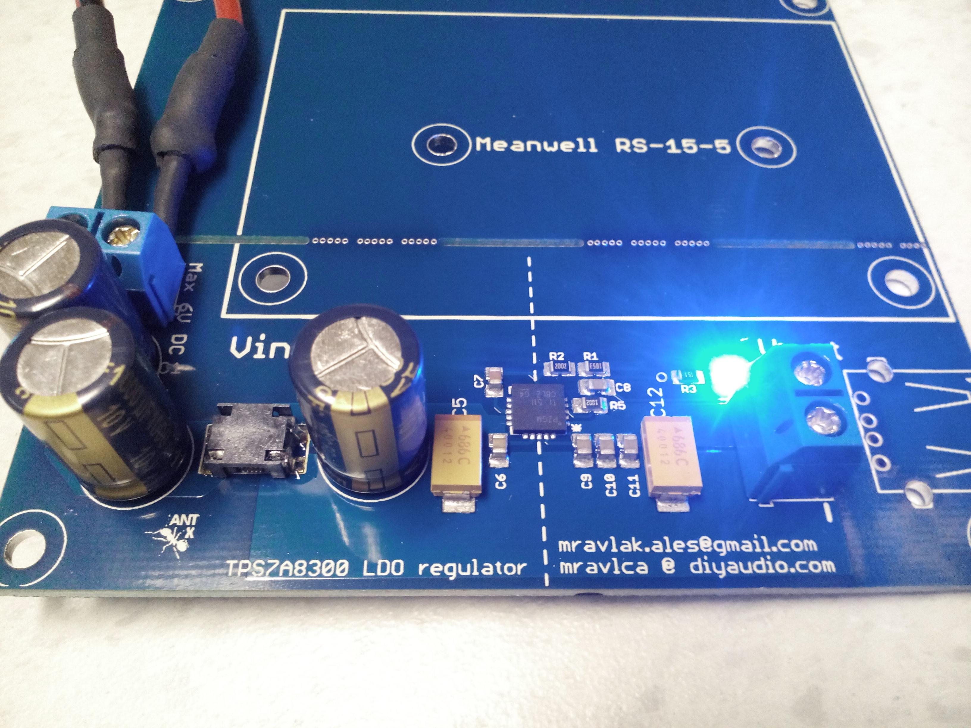

Just a few more word about the circuit. In pre regulator stage there is CLC filter. It is build from three Panasonic FC 1000uF/10v capacitors with common mode choke from TDK, ACM7060 series. This choke is small but it can withstand up to 5A of current, which is more than enough for this application. PCB itself is made by following apllication design.
On this PCB I am also planning to use heatbridge as I did used it in my TP7A4700 design. This will provide very good heat dissipation and ensure low temperature for PCB and components on it, leading to the expansion of their lifetime.

How much was that Meanwell PSU? It says it puts out 5V, not 5.6 though?
Did you solder the TPS7A8300 yourself?
Thanks. This series of Meanwell PSUs have adjustable output, ranging from 4.4V to 5.6V. 0.6V is enough voltage drop for TPS7A8300. It costed around 15€ in local shop, but on the web can be found for around 10€. I soldered this qfn chip using stencil and reflow owen.
