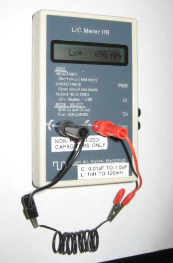

rare inductor needed where find ? 0.7uH
HI guys 🙂
I search anywhere on google - ebay - digikey - solen.ca and I don't find anywhere this amplifier output INDUCTOR value it's 0.7uH or 700nH for output of LM780 board.
OR Can I change this RL circuit (10ohm resistor / 0.7uH) by RC ?
thanks in advance 🙂 !
nicK
Get a AA battery. Or any mandrel of similar diameter.
Get a length of 1mm diameter enamelled copper wire. 200mmm gives just enough for short tails.
Wind 10Turns around the battery.
Slide the copper turns off the battery.
You now have a ~0.7uH air core inductor
10 Turns AWG-22 insulated, solid core wire wound around a 1.5V AA battery. Measured on Thurs 28 March, 1700 GMT. (1300 EDT in New York City).
Measured inductance was 696 nanoHenries on an AADE LC meter

WOW THANKS TO ALL FOR YOUR QUICK REPLY ! 🙂
I have crossover inductor in stock and I take that wire it's 20 AWG
but do you glue or other tips to get all wire loops very close together ?
on the pics of GOATGUY the loop is not close but it work well too 😉

Just start with REAL STRAIGHT wire. If its wiggly, bent, not really straight, you're not going to get nice close windings. But if its straight-straight, then by hand you can wind this and have it look beautiful, in a minute or two.

RF guys use "Coil Dope" to keep their hand-wound coils mechanically stable, so the inductance value and the Q remain constant. Google shows a number of homebrew recipes for making Coil Dope at home; the top two appear to be

That inductor is not critical at all. It is put on the output of the amplifier for provide stability in case of capacitive load of the speaker cable. You can find it at the output of many transistor amplifier with negative feedback. It is usually realized by winding 5-6 turns of insulated wire on a 5W resistor. It is not an off-shelf item. Trust me, it has no audible effect...

No 1mm gauge to hand, so i used 1.5mm, 17 turns, wrapped around a pencil. Using handheld LCR meter they both read 0.63 uH (nulling out lead inductance). Varnished using thinned epoxy resin, two turns of glasstape, then varnished again.
