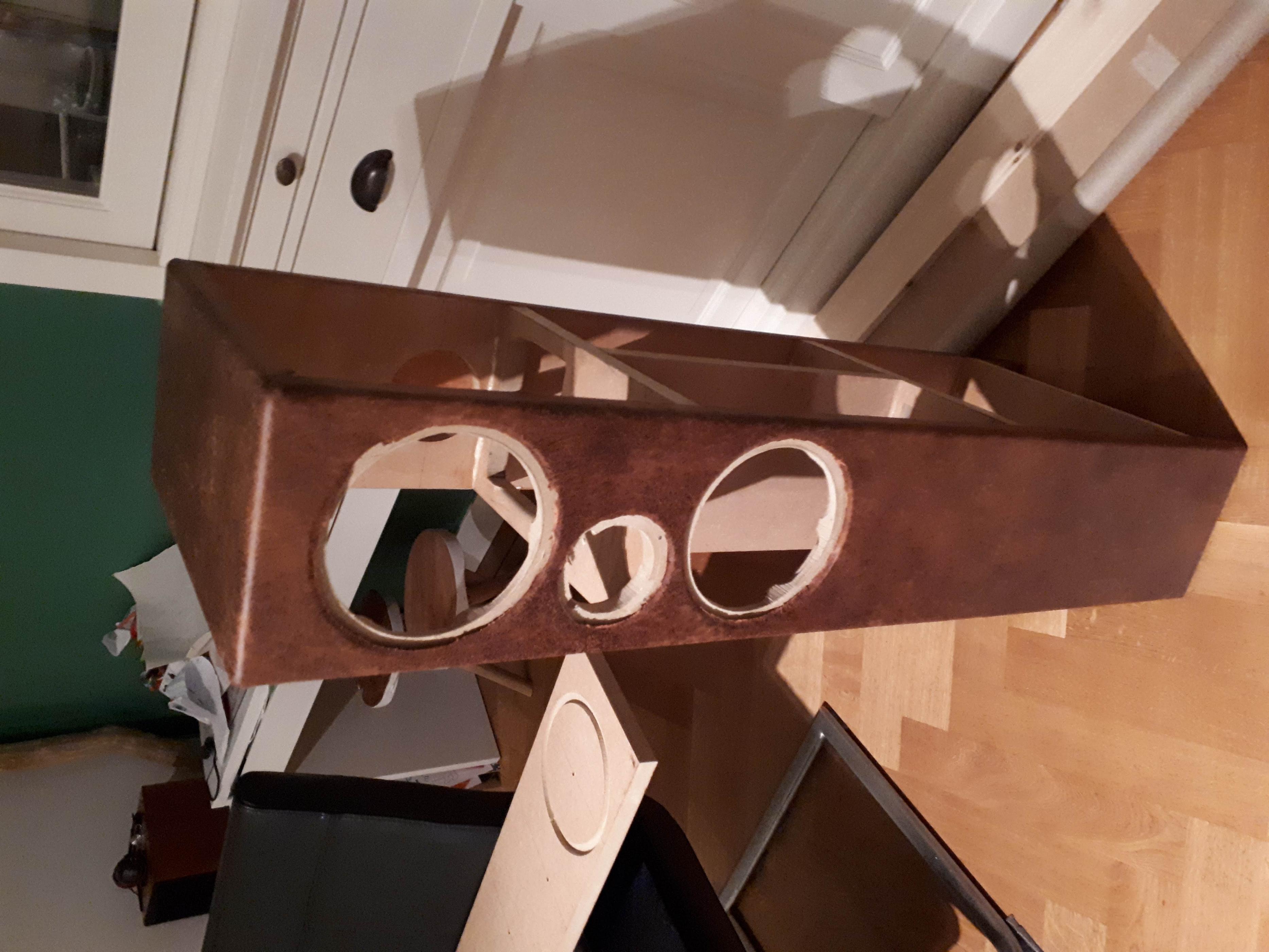

So I'm building new speakers. Fun, right?
Ordered the wood cut to size, started routing the driver and bass port holes...
First, I ****** up on routing depth.
Somehow after I was done, it started at the right depth, and at the end of the circle it was 2mm deeper.
Scratch one board, try again.
Next, depth was okay,but it ended up 2mm wider in radius.
Scratch that.
Then, got the woofer holes right, but the tweeters hole was 3mm too wide. Yes, I checked before routing. A
No idea how that happened either - I always do a test run on a spare piece of board.
Finally got the fronts okayish. On to the back panels.
Measured, adjusted, tested...
And now my bass port holes are too wide for the actual plastic bass ports.
I don't know what the **** is happening - my previous speakers using same equipment all came out okay.
I keep going back to my router and circle jig, everything is tightened, it all works fine on the test runs.
Im at the point now where I think it's cheaper to find a woodwork shop to do it for me than to order more wood myself and do it again.
If this was anyone elses story, I'd think "you're not measuring right or not tightening the screws on the router",but alas, it happens to me and I triple checked everything every time.
I have lost my mojo.
I'm going to pay someone else to not **** it up now, I guess.
I just needed to get this off my chest even though I know this makes me look like a complete moron.

Check to be sure the router collet is clean and tight. Then check to be sure the router base is round and centered. My big router jams up with dust all too often.

Pygmy, I'm sure most if not all of us have had things turn out a little different to how we wanted.
I know I sure have.
It can be frustrating, but if it's fixable it makes you feel even better knowing you did fix it.
I've had router bits come loose ending up with a rebate that started at 10mm deep and ended at close to double that.
Or the bit starts wobbling and chews the heck out of the hole edge.
Set the jig to find I forgot to allow for the bits diameter and ended up with oversize holes.
Pivot holes or pivot pins that aren't 100% will also give 'mixed' diameter holes.
Etc and so on.
Point is, stop, have a break, then when you feel calm, go back and check each item to see what happened.

Always make a test piece (or 2 or 3) with MDF to get past the mental lapses. Do each processing step first on the test piece then immediately do the same step on each of the real workpieces. Move through the overall process like this step by step. You still may screw it up but the odds are much more in your favor.
I learned the ruined workpiece way to change how I tighten router bits. Rather than inserting the cutter all the way, I pull it up a tiny amount - 1/32 - before cinching the nut. This way the wedging action of the tapered collet can occur without conflicting with the limit of the bottom of the collet. Counterintuitive but it has worked for me.

It's common practice to drop the bit a fraction from the bottom of the collet nut. As Phivates mentions, this stops the bottom of the bit from interfering with the action of the collet when tightening.
First link on google search says the same (so it must be true): 😉 How to Properly Install a Router Bit
Point is, a small fraction clearance is fine but having that thing hanging way out is not such a good idea.
Yes it is bad and risky practice to tighten the router collet with the bit bottomed out...always retract it slightly then tighten! This allows the shank of the bit to move into the collet as it is tightened without interfering with the bottom of the collet and preventing the complete engagement of the collet.

Thing with router bits is they sometimes freeze in the collet. Leaving a bit of space allows you to use a block of wood to break it free.
To the OP, I've seen often a router pull into the work especially if the material is hard or the cut too aggressive. A trick is to run the router counter clockwise and then finish with a clockwise cut.

So I got pissed off and decided to do it myself, again, and ofcourse now it worked flawlessly - because I had to prove some people wrong 🙂
Pic of happy result covered in leather:
