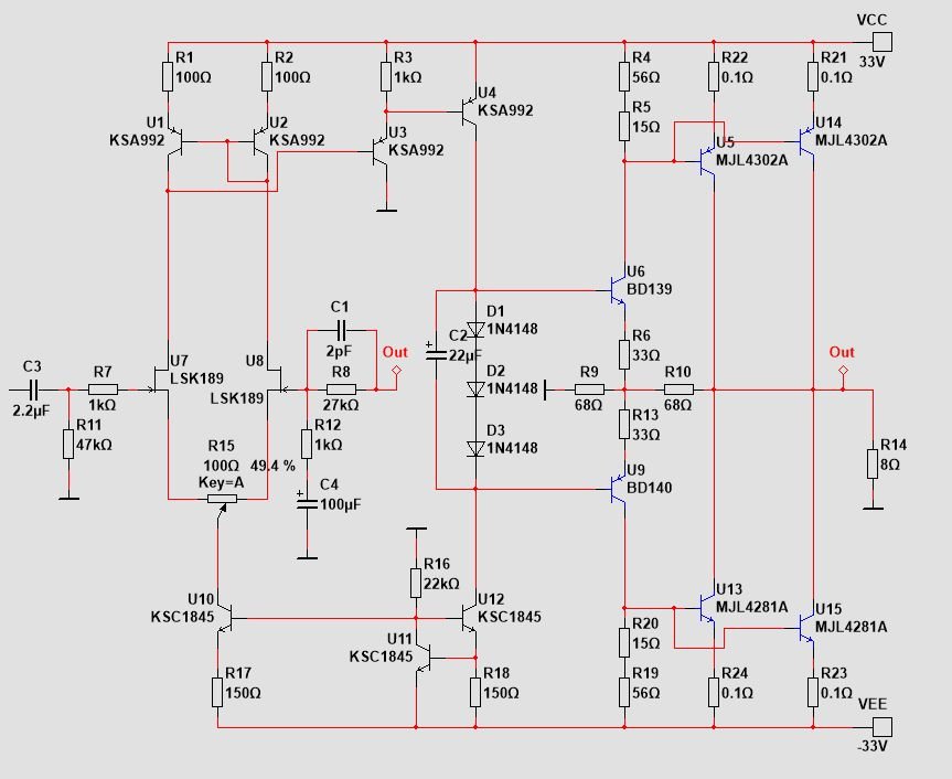

I wanted to create a "Rail to Rail" power amplifier.
This is what I came up with.
I use dual parallel output transistors.
Supply is +/-33V.
Output at 8 Ohm is +/-32.5V = 66W.
Output at 4 Ohm is +/-32.1V = 128W

One serious issue. You should replace the three 1N4148 with one BD139 mounted on the heat sink to better temperature compensation.
Not so serious: You can replace U1 and U2 with 1 p channel mosfet to get lower distortion. It needs a back diode G - D
If you put an 18k resistor from VCC to emitter of a new KSA992 with the base to ground and collector to R16 you will not burn a loudspeaker if positive rail fuse trips.

Agree.One serious issue. You should replace the three 1N4148 with one BD139 mounted on the heat sink to better temperature compensation.
Dalington VAS also needs a back diode at that position if it lacks other current limit means.Not so serious: You can replace U1 and U2 with 1 p channel mosfet to get lower distortion. It needs a back diode G - D
Good point, this is often overlooked.If you put an 18k resistor from VCC to emitter of a new KSA992 with the base to ground and collector to R16 you will not burn a loudspeaker if positive rail fuse trips.

I recall the last time I tried “CFP with gain”, it performed noticeably worse than CFP without gain. Considering CFP doesn’t require much voltage headroom at the first place, I don’t think it worth your efforts.
The THD is not the lowest.
But here is the simulation I have done.

Always a good idea to make the current sources completely independent. No need to treat it like it’s an IC op amp. And if you do fuse the rails, do not fuse U4 and U12 or anything in front of it. If R18 burns open or TO-92’s explode it will not set fire to the house. If that happens the output stage is already lost and it’s fuse(s) should have blown. If what happens is a rail fuse blowing due to momentary overload you don’t want to lose DC feedback. Those type transistors, at these low voltages will usually survive 10 ms short circuits with a typical power supply. Sustained short, no. High voltages, hell no. But you could sense current in the emitter resistors and trip a relay in time. TIP35C’s might not fare so well.
Have you tried to simulate at 25C and also at 80C temperature? Idle current? I am wondering because of D1, D2, D3.This is what I came up with.
Adding to PMA’s comments, seems like thermal stability will be an issue with the lack of emitter resistors in the CFP OPS.
Yeah, kind of a lot of power being burned in the local feedback. The usual implementations of this have higher gain in the output stage (ie, larger R10).

Also could consider a bootstrapped design, with bootstrapping boosting the driver supply, drivers being CFP-with-gain, outputs being simple EF? I think that reduces the quiescent power use compared to the OS being CFP-with-gain.
PMA has good point, collector values seem low for the drivers, shouldn't need 3 diodes.
Something I'm guilty of in sim with this topology, you end up roasting the driver and getting strange bias behavior.
Last time I got a better hold on a design, the phase margin changes with temp. Big jumps
It is a odd topology and have had my fascination with it.
Driving close to clipping at 10k or 20k is where it shows its ugly.
Wonder what THD is for this sim at high frequency. the numbers seem little good to be true at 1k.
I do slightly like the concept of low gain for the CFP, just enough to ride the rails better.
Maybe add internal resistance to the voltage sources, sim assumes infinite power.
Work well for vertical mosfet, to overcome the 4 to 6 volt losses to the rail, low gain is all that is needed.
2 pairs of outputs is the way to go, even at low voltages/ power ratings.
I think with internal resistance added in sim and decoupling of the power supply, its closer to 90 watts at 4 ohms in real life.
