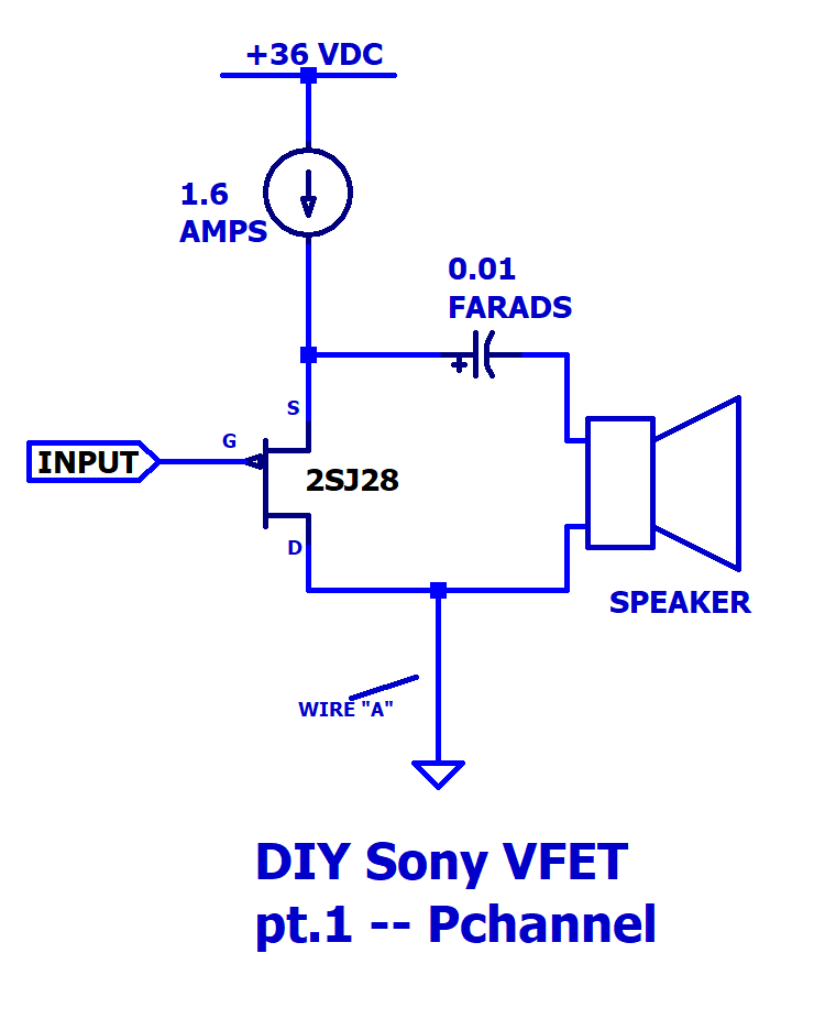

Here is one that doesn't. Nelson Pass's "DIY Sony VFET pt.1" (link to Forum thread) --Simplified schematic attached below.
This amp operates in Class A. Its supply current is perfectly constant and independent of the load current. The same supply current flows whether the amplifier is producing zero output, or 100% max possible output. The output waveform does not modulate the supply current.
And oh by the way, the same is true of the current flowing in the amplifier ground ("wire A" in the diagram). It too is constant and independent of the output waveform. Kirchoff's Curent Law is a wonderful thing.
Nelson specified an SMPS "brick" to provide the +36V supply, with a C-L-C postfilter to reduce any high frequency switching artifacts that it might spray onto the +36V buss.

We don't need an exotic class A amplifier to fix this, it's possible to reduce PS ingress as far as you like in a conventional class AB design.
"Ripple eaters" are most effective at HF. That's true for both passive R-C filters and active cap multipliers. Since ripple is loudest at LF, the ripple eaters aren't ideal. I'm thinking a better technique is to cascode IPS and VAS transistors to suppress injection at all frequencies. Of course you have to reference each cascode to the local rail, not ground, for it to be effective.
The main thing is to simulate with HF and LF rail noise, on both rails, and verify high PSRR over a broad spectrum. Accomplishing it is open to creativity. 🙂
