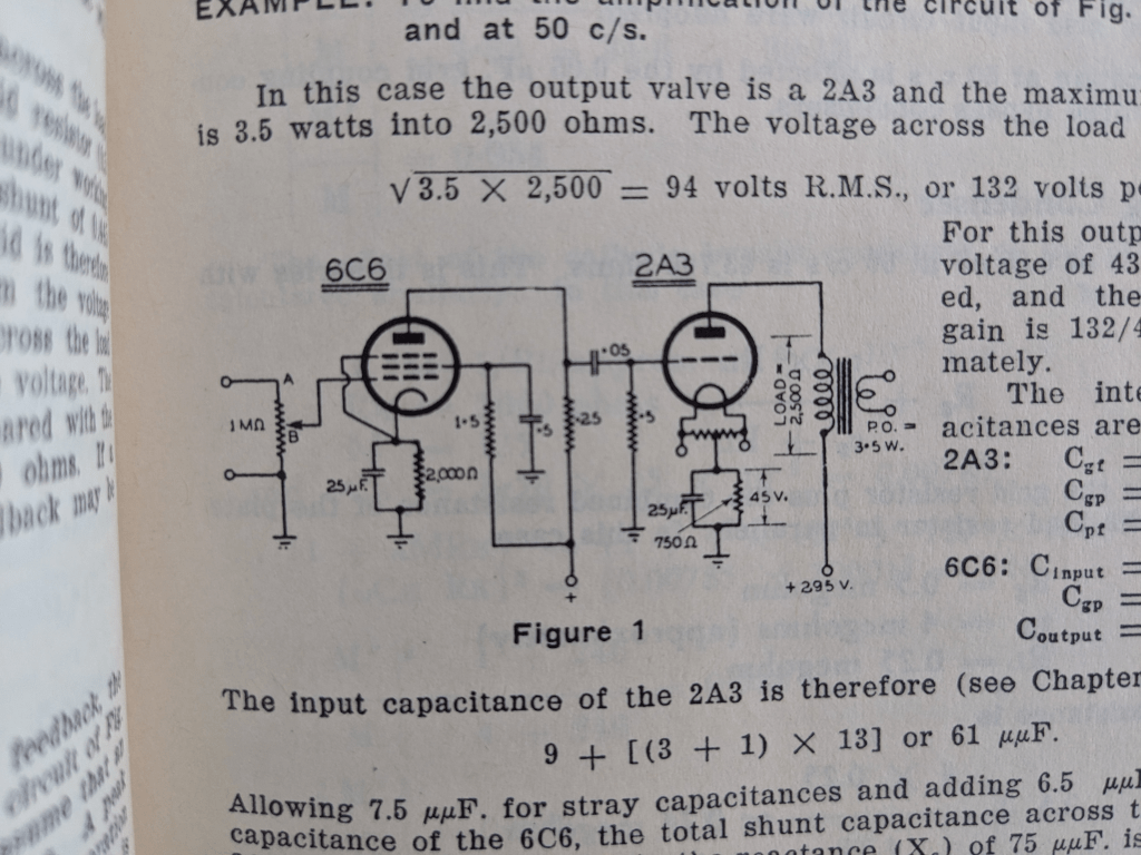

I am going back to the beginning and building the Radiotron 2A3 single-ended amp. I plan to start with the original and work from there listening as I go. My first mod will be taking the bypass caps to 100uf and the coupling cap to 0.22uf. My question regards the resistor values which are given as what looks like .25, .5, and 1,5. I assume those values are in mega-ohms, correct?

From what book is this photo?
The image posted is from RDH version 3... Chapter 8 page 53. RHD Version 4 page 601 is a slightly different version of the amplifier. The input coupling cap is changed to a 0.1uF cap and the input tube from a 6C6 and a 6J7.
I would also comment to the OP about simply changing cap values for coupling and bypass on the 2A3. I wouldn't expect much, if any, improvement. Increasing the lower frequency coupling and bypass (for the 2A3) could also result in earlier core saturation the OPT, depending on the source material and the specification of the OPT, which is not listed beyond the primary impedance. After extensive testing with over 60- 2A3 tubes over the decades, I would recommend a 3.5K load... better linearity, lower distortion and easily able to get 4-watts output.
Have fun.
Some interesting info, but not a bit surprise in the results.... one major improvement... OPT, a Tango U-808 at 3.5K primary, higher cathode resistor value of 880 ohms (more negative grid bias) and a higher plate supply voltage of 330V. Pretty much what I use for a simpler 2A3 output stage; 3.5K load, 866 ohm cathode bias resistor and similar plate supply voltage (350v). The 4.5 watt output spec is the same for my 2A3 design.
Other changes include the driver, increased idle current and a stronger drive ratio between the plate load resistor and the 2A3 grid resistor. Still, I don't see the need for such large bypass capacitors for both cathode bias resistors. Even the U-808 3.5K OPT has a frequency spec of 35Hz to 60KHz at -2 dB points.
However.... I used a completely different input/driver stage. I would also refer to Gordon Rankin's Bugle 45 document (attached) showing his design and the various formulae to calculate specific part values and such. One key area is the idle current in the driver stage. This is calculated against slew rate and voltage swing to ensure adequate bandwidth.
My earlier design (circa 2007) used for the 45 and 2A3 was based on Hashimoto iron. Using a drive current of 2.8ma and a plate load of 54.9K against a grid resistor of 249K (coupled with a 0.22uF cap) resulted in a frequency response of 25Hz - 50KHz within 1dB at 1-watt output. I've also opted to attach the schematics for these designs (45 and 2A3 SETs). Both use Hashimoto iron and cost a small fortune in parts, even back in 2007.
Needless to say, one can endlessly alter design values and some will make more of a difference than others... and some changes might even make it worse. In any case, have some fun with your build and whatever changes you make.

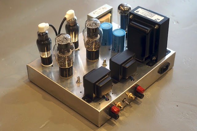

FWIW, I'm the author of the two Radiotron SE2A3 blog posts referred to in this thread. The original article stored in my blog archive came from my defunct website from the early 2000s.
I revisited the Radiotron SE2A3 a couple of years ago because I still enjoy the sound of the same circuit I worked out with Sergey in the mid 2000s albeit now with G-Trans Finemet FM6WS OPTs (instead of the Tango/Hirata U808s) + Hammond 302AX power transformer as pictured above. This amp serves sort of a benchmark for all my other amp projects.
This is my main SE2A3 amp now. It uses nickel plate choke loaded 6A6s custom wound by dave slagle + Tamura F7002 permalloy output transformers which date back to the Sound Practices homebrewer article I wrote for Joe Roberts in the late 90s.
I can assure you that the schematic in the 3rd edition of the Radiotron works. Build it and listen to lots of music so you get to know it intimately before doing any mods. Being a trained classical musician, I've learned more about this hobby through listening!
