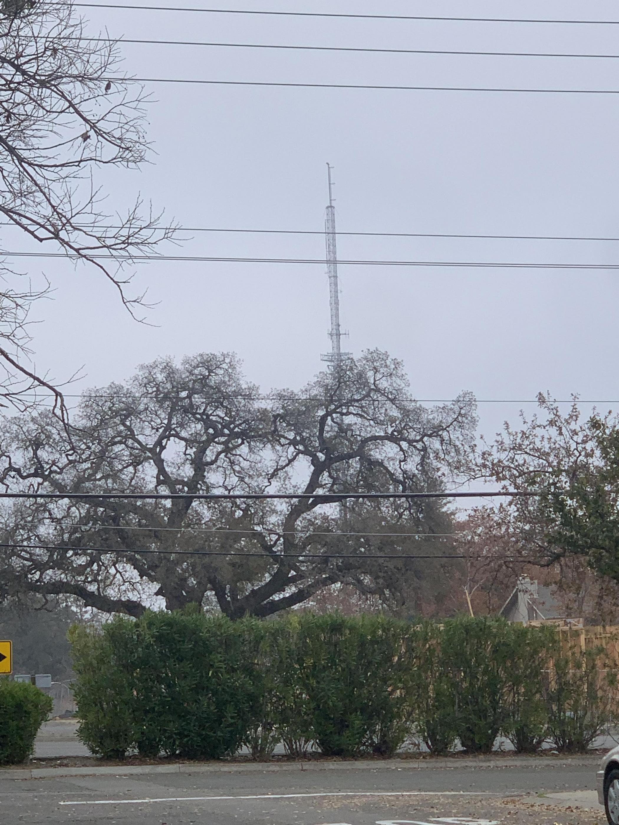

So which radio station's antenna is right next to your house?

Yeah, that's pretty close! AM, or FM, radio station?
So .. probably AM -- and the 3' test lead is probably adding a common-mode signal (that is the same demodulated audio phase) to the phono preamp ground, giving the effect of attenuation.
Just guessin' -- Cheers

This one (taken from my front yard).
edit: Do you have a schematic for the phono preamp that you could post? Is it a commercial product or home-brew?
I haven’t caught their call sign, but I assume AM. Sometimes they play good stuff!

This gave me much pleasure. I'm glad I wasn't drinking coffee at the time or I'd be cleaning my screen and keyboard right now.This one (taken from my front yard).
