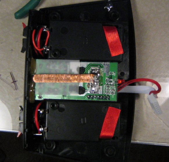

The T-amp will operate well with up to 14VDC, BUT if yours has been recently purchased, I would not suggest using that high a voltage. The T-amps went through a "de-rating" and the solder heatsinking was eliminated. So the heat you detect is the chip glowing and radiating the heat into the plastic case. If you dont put a heatsink on it, I wouldnt use more than 12V. Did you check the wallwart while powering the amp? With no load, the wart will read higher than when powering the amp(provided it is unregulated). Check it with the amp operating with no signal and then with. That will give you a realistic voltage.
I heatsink all my T-amps. I would suggest doing the same, and operating it moderately if you dont.

As for heatsinking, because I have it in the original case still, I'm thinking that I don't have much headroom in their for a sink. I have some very small BGA ramsinks from my computer that may work I guess... anybody know exactly what I can fit in there? Height specifically.

As to a heatsink, flood on some solder, through the vent holes and onto the slug and then attach a small piece of copper or aluminum. Make sure to tin the heatsink piece first, and keep it hot or you dont have to re-heat the whole thing mess.Copper is far better since it retains the heat longer. Below is a t-amp I added a scrap of copper to. Ugly but works well.
