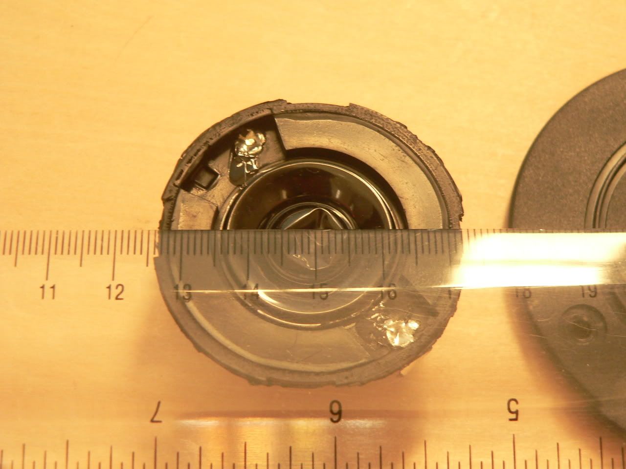

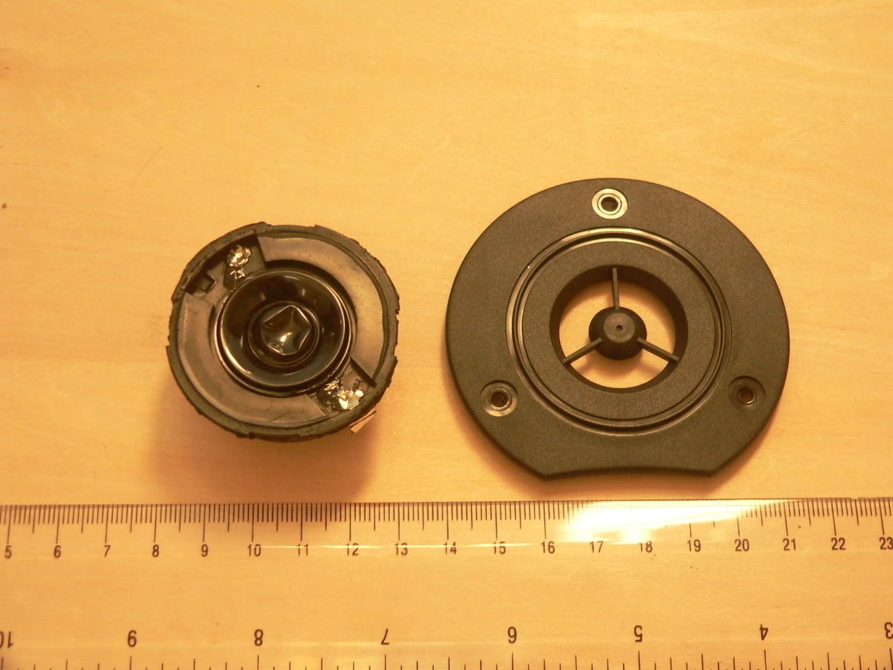

I've got a set of old Radio Shack speakers. They're labeled RCA cat# 40-5000, which I believe are identical to the old Optimus 7, which are the same as the even older Minimus 7. One of them dropped and the tweeter assembly broke off its mounting plate. Does anyone know where I might find an identical replacement tweeter?

What is the dome diameter -- tyhiose are either Audax (or one of the zillions of clones that followed), thry cam in 2 sizes and in many versions.
The version i most often use is frame ApexJr, but you might have to fiddle with the mounting. You should also be able to fins some with the same face plate. )i just put one away the other day)

I think you're right. They aren't from the 7. The speaker is smaller than the 7, but the die cast chassis construction appear nearly the same. Out of my set of five, two are labeled Optimus and three are RCA. Radio Shack seems to suggest they were the model RCA PRO-X33AV.
Where would I measure to specify the dome size? The outside is maybe ~25mm (1") but the actual dome part is maybe 12mm (1/2").
Cosmetically, you'd never be able to tell if I just stuck the pieces back together and epoxied them. Is it going to mess with the sound too much? Can I try to pull the dome back out? It's not as if they were exceptionally high fidelity speakers in the first place, but it'd be nice if the center channel matched the left and right.

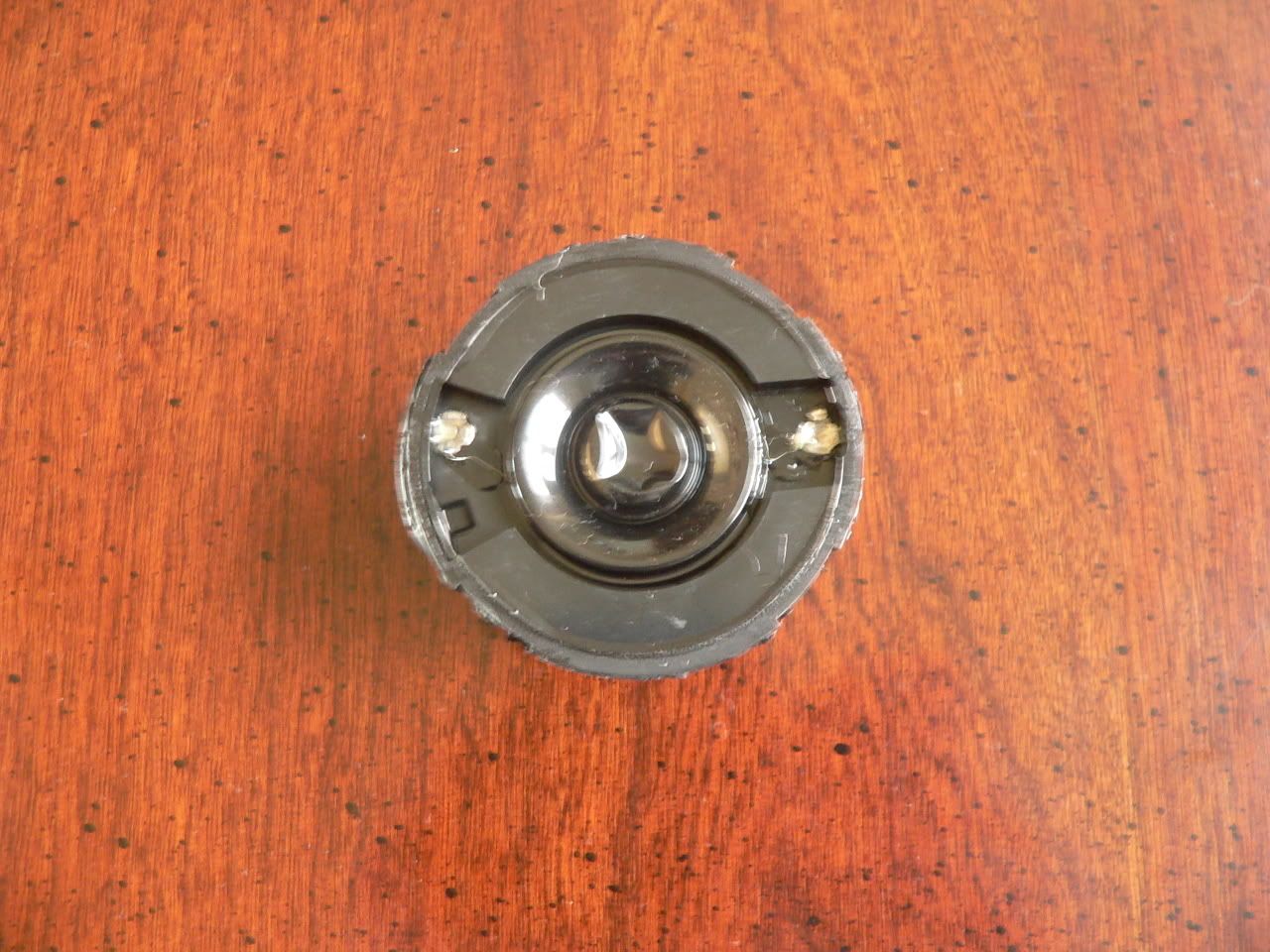

That tweeter (minus the escutcheon) looks almost identical to those used in the Infinity MICROII satellites. I am trying to find suitable replacements for a pair of these speakers but so far have had no luck. Infinity repair agents say they can't help either. So, if anyone can assist with further info I would be pleased to know about it.
BTW, the outer diameter of the plastic frame on the ones I have is just under 48mm.

Many posts on modifying and improving 'Minimus 7's" from memory most of them condcerned XO but a couple mentioned replacing the tweeter with the Vifa neo D26NC, saying the benefits outwayed the cost as the woofers in these were usually reasonable.

I doubt you'll be able to find an exact replacement for that tweeter. Radioshack outsourced those drivers from all around the world during the life of the minimus 7. Not all were created equal during that time.
I've owned 3 pairs of minimus 7's and none of them had the same drivers. The tweeters were the most obvious difference as some of them had completely different mounting flanges from each other. So you'll probably find something that fits, but it probably won't be to the same spec as the drivers made during that time period.
Ty_Bower said:Where would I measure to specify the dome size? The outside is maybe ~25mm (1") but the actual dome part is maybe 12mm (1/2").
Audax called then 10mm & 14mm... they were, i believe, just taking about the inner dome. I'd get a pair of the ApexJr tweeters and mod the existing face play so you can use that to fix the tweeter to the box... shipping will be more than the tweeters )i've gone thru a 100 some of these).

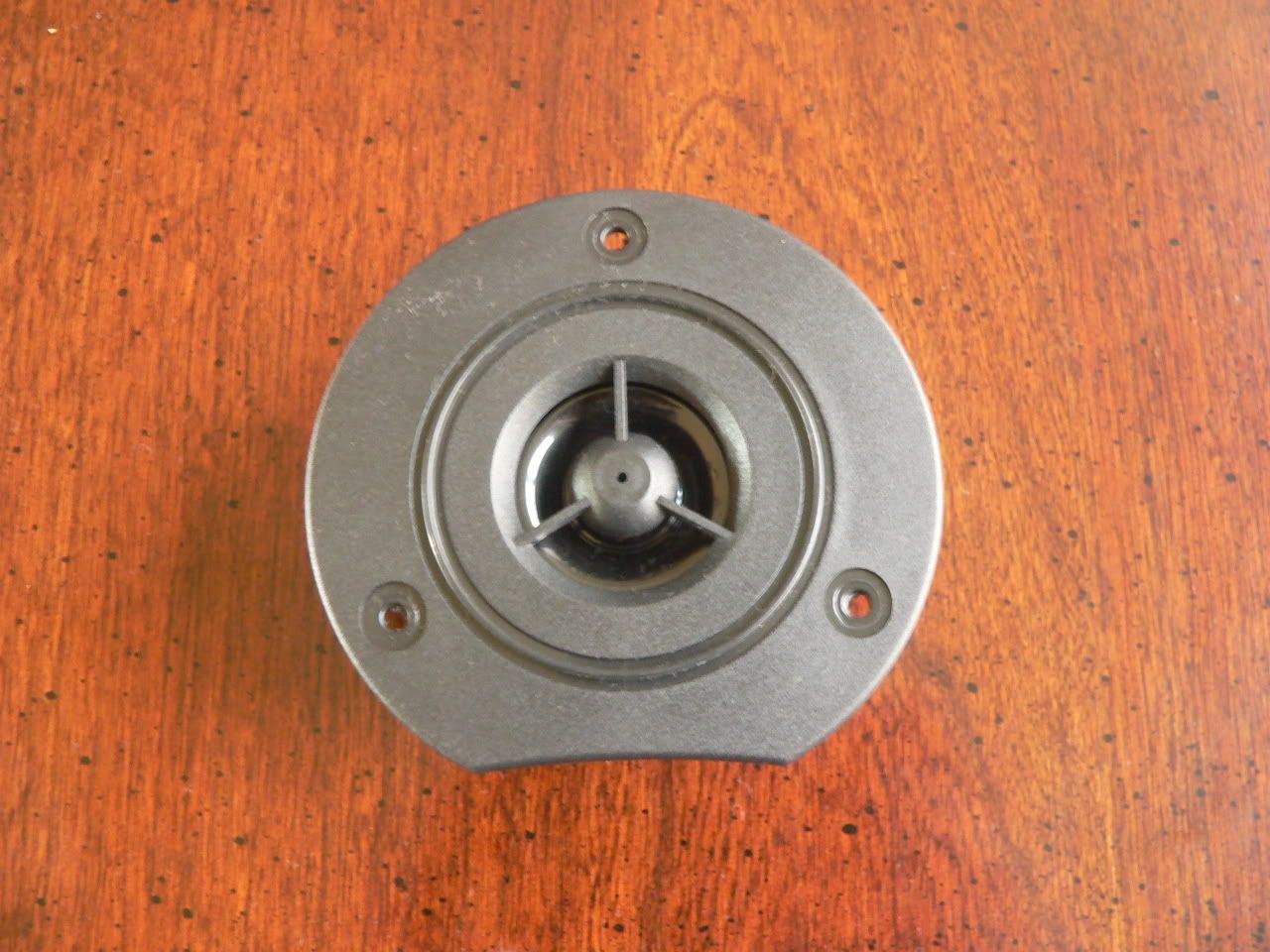

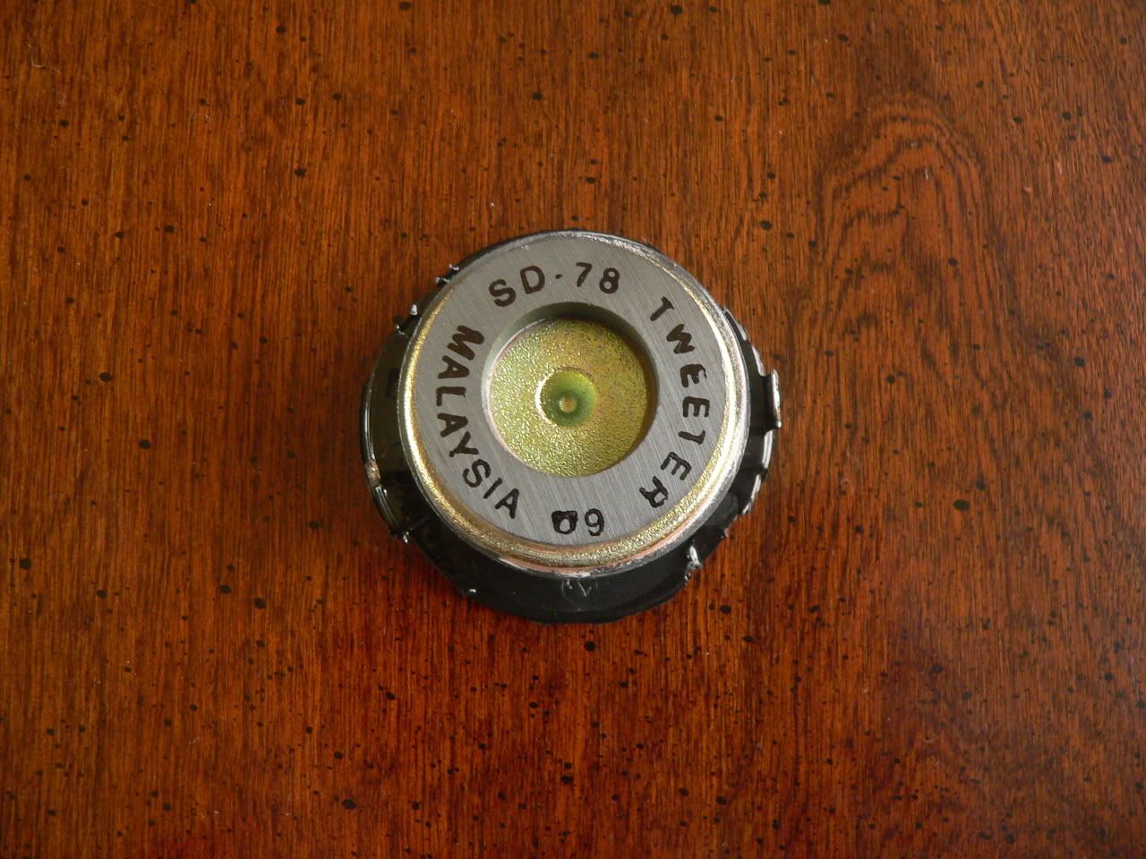

Ty, I discovered an almost identical tweeter in my local Altronics store only yesterday. It is stock code C3010 and is nominally known as a "20mm mylar domed tweeter".
http://www.altronics.com.au/index.asp?area=item&id=C3010
You would need to cut away part of the escutcheon to suit your speaker but other than that it should work perfectly. For my application I was able to remove the escutcheon and clean off the adhesive so that it would fit into the Infinity MICRO2's - it fits perfectly BTW. Since the Altronics item is not shielded I removed the magnets from the back of the originals and super=glued them on the new ones.
