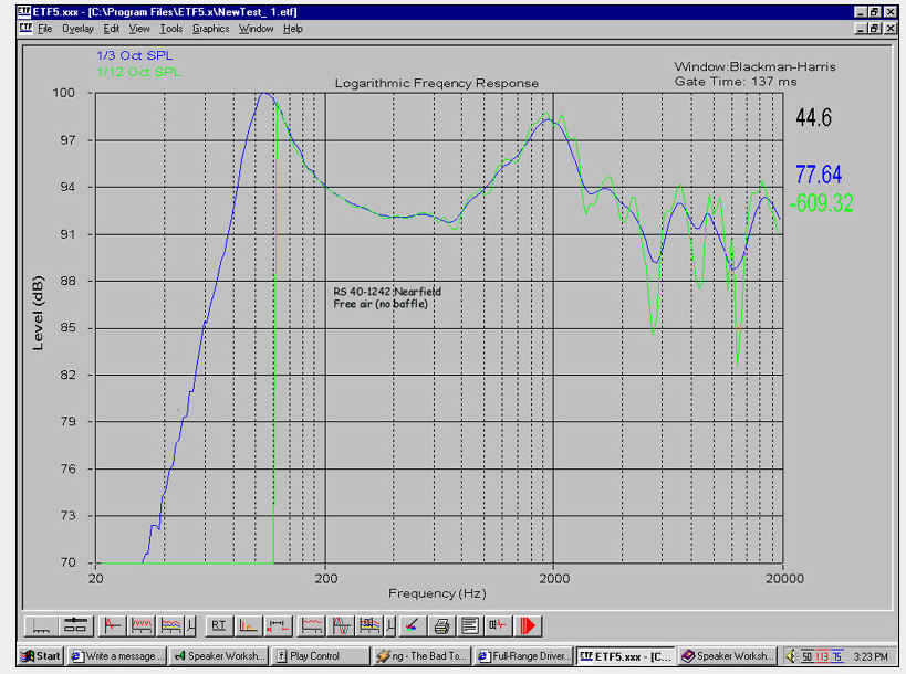

i've got a pair of 40-1242e's, and i've never seen any plans for them. anybody know anything about them? they are a 6 inch cone, 5 watt max, labelled Full Range on the box

i bought 'em on sale for 15 bux the pair and have had em sitting ever since, as i was unable to find anything that would tell me what kind of enclosure to use with them. i might heave em over the fence
Oh, don't do that. Just don't expect them to be much use for hifi purposes. Me, I'd slap them on a baffle & use them for background listening in the garage or something like that. They'll be fine for that sort of thing.
Greets!
If you want to play with them, then assuming yours has a similar response they could be front horn loaded, though only as a ~110 - 2 kHz BW unit, so think big. For sure it's underdamped BP response begs the Q of what was it optimized for? Cheap PA horn?
GM
GM
if i'm not mistaken, that particular RS 6 inch was made like an oversized boombox speaker, so its capabilities suggest it was made for large boombox replacement or PA use.
