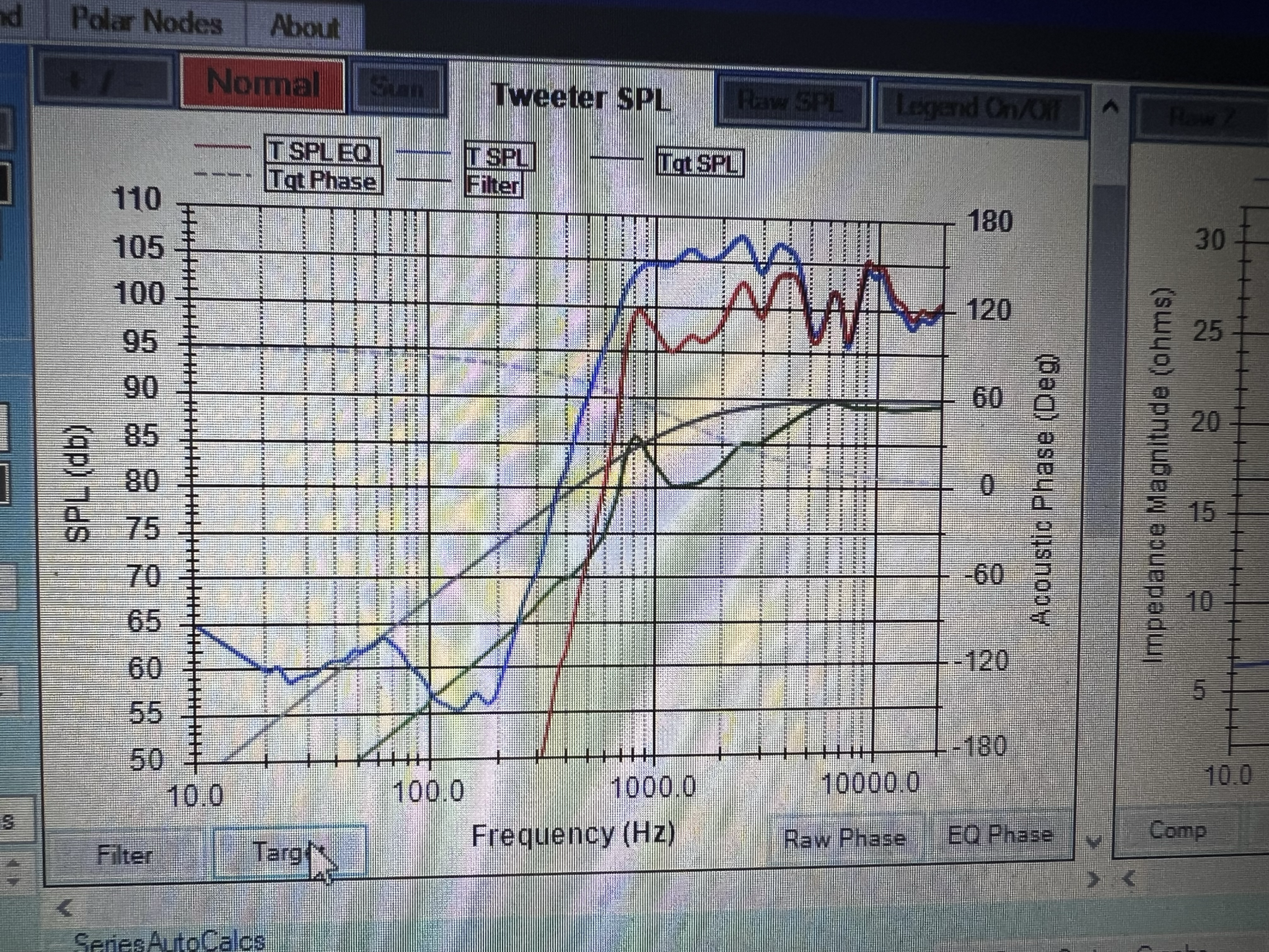

Second - the crossovers! I've plugged the T/S numbers in every free software I can find, and the a friend and coconspirator who has a Windows rig used Jeff Bagby's crossover designer as well, and I think I'm in the general ballpark but still not sure. I will post the FR of the drivers below, as well as the tweeter response with 5uF, 10uF, and 15uF caps on the tweeter (first order). Here are my questions about the crossover:
1. Frank declined to sell me his crossovers, and wouldn't give me the values, but we had a great conversation anyway, very good guy. Although he uses first order on both drivers, he said I might want to go second order on the tweeter. I would rather avoid an inductor on the tweeter mostly due to phase concerns, which is really high on my list and part of the reason I was originally going to use full-rangers. So first gate: first or second order?
2. With first order Butterworth, I've got pretty typical values at 1200hz, 1350hz, and 1500hz: 16.56uF/1.06mH(woofer), 14.72uF/.94mH, and 13.25uF/.85mH. Second order on the tweeter only lowers the cap values a bit and adds a small inductor.

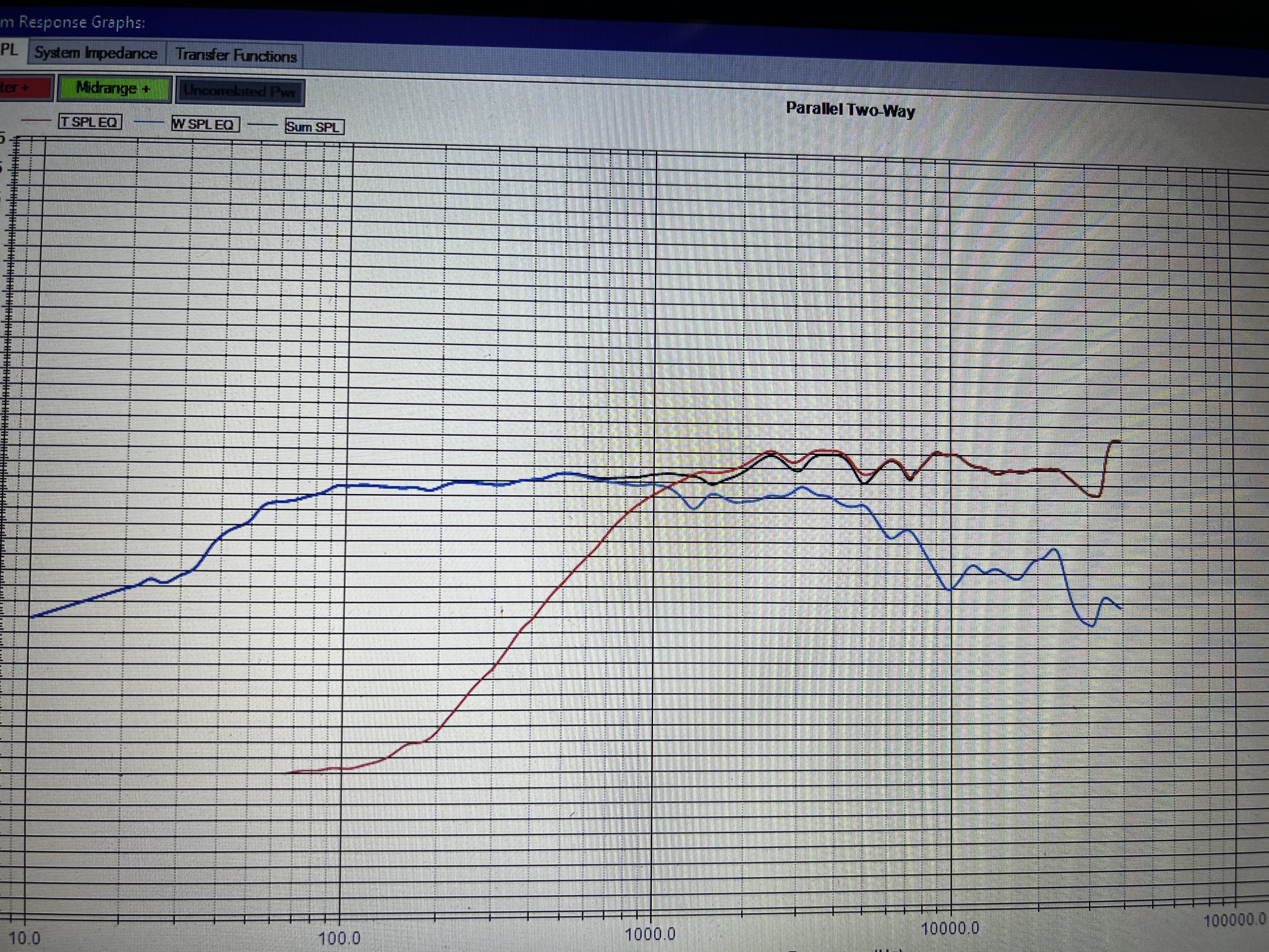

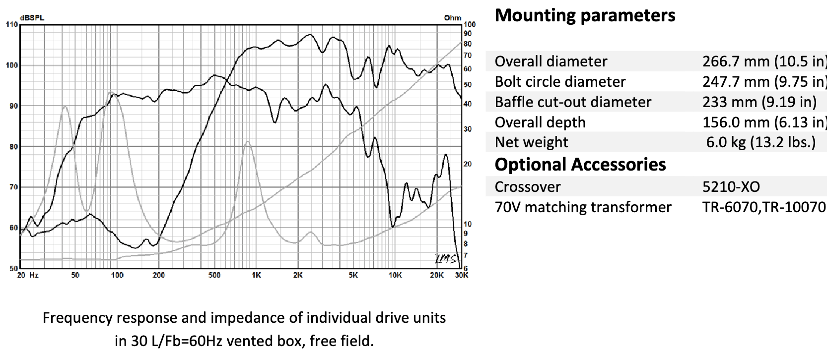

As you will see in the frequency/impedance graph for these drivers, there's a really knotty issue due to a sharp impedance spike from the tweeter at just below 800hz, and this is really interfering with the falloff of the tweeeter and pushing up the FR almost all the way to the intended xover point (I'm using 1350 as a general target). I don't know how to remedy this, and am beyond reluctant to even go to 2nd order, let alone 4th. I'd rather start from scratch with a different driver, BUT this doesn't seem to bother Frank, he's got some way of dealing with the impedance that I don't understand. Zu audio is another example of a popular speaker using cheap Eminence drivers and squeezing out very good performance. I'm guessing these guys are manipulating the enclosures to make it all work?

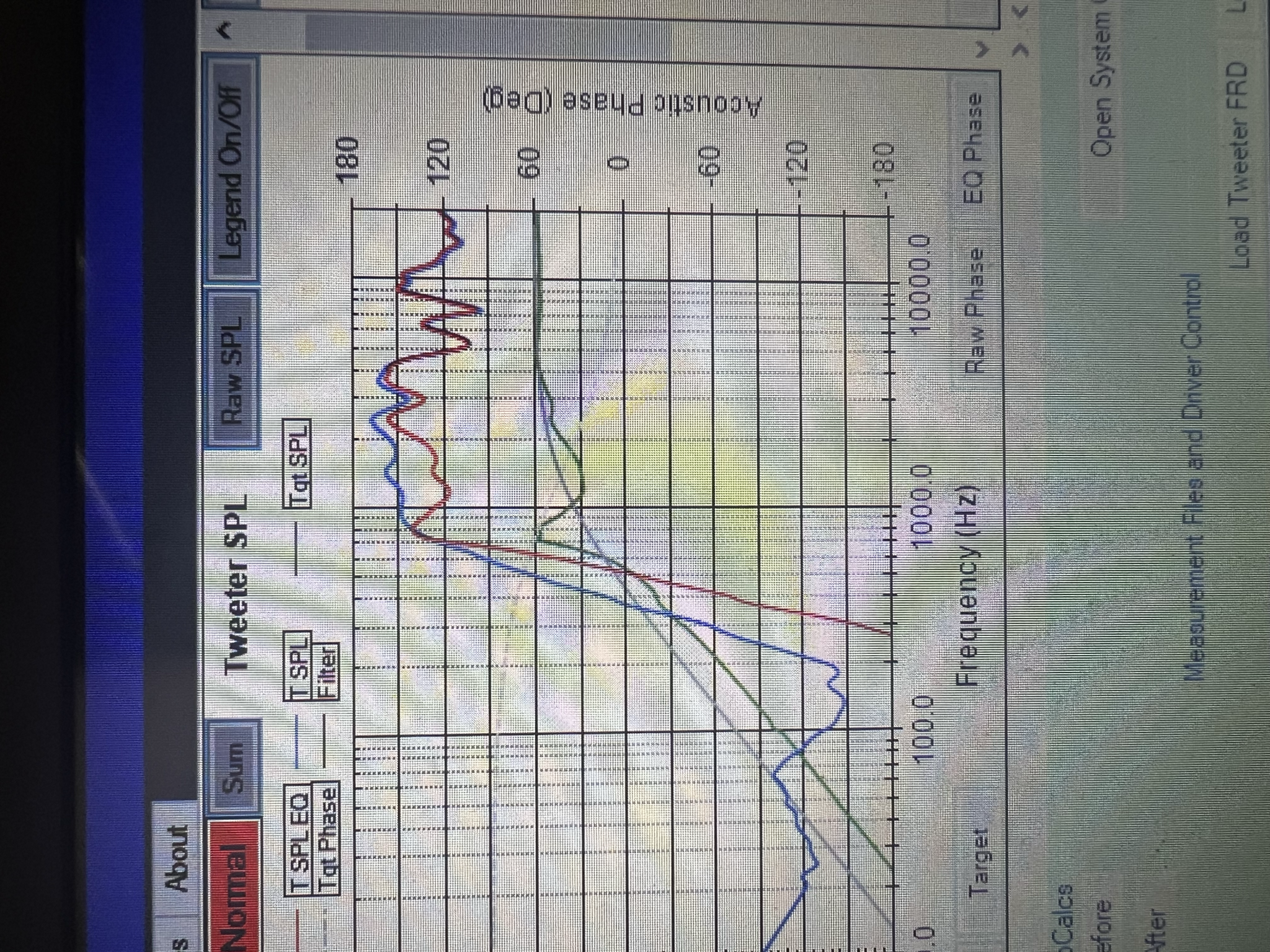

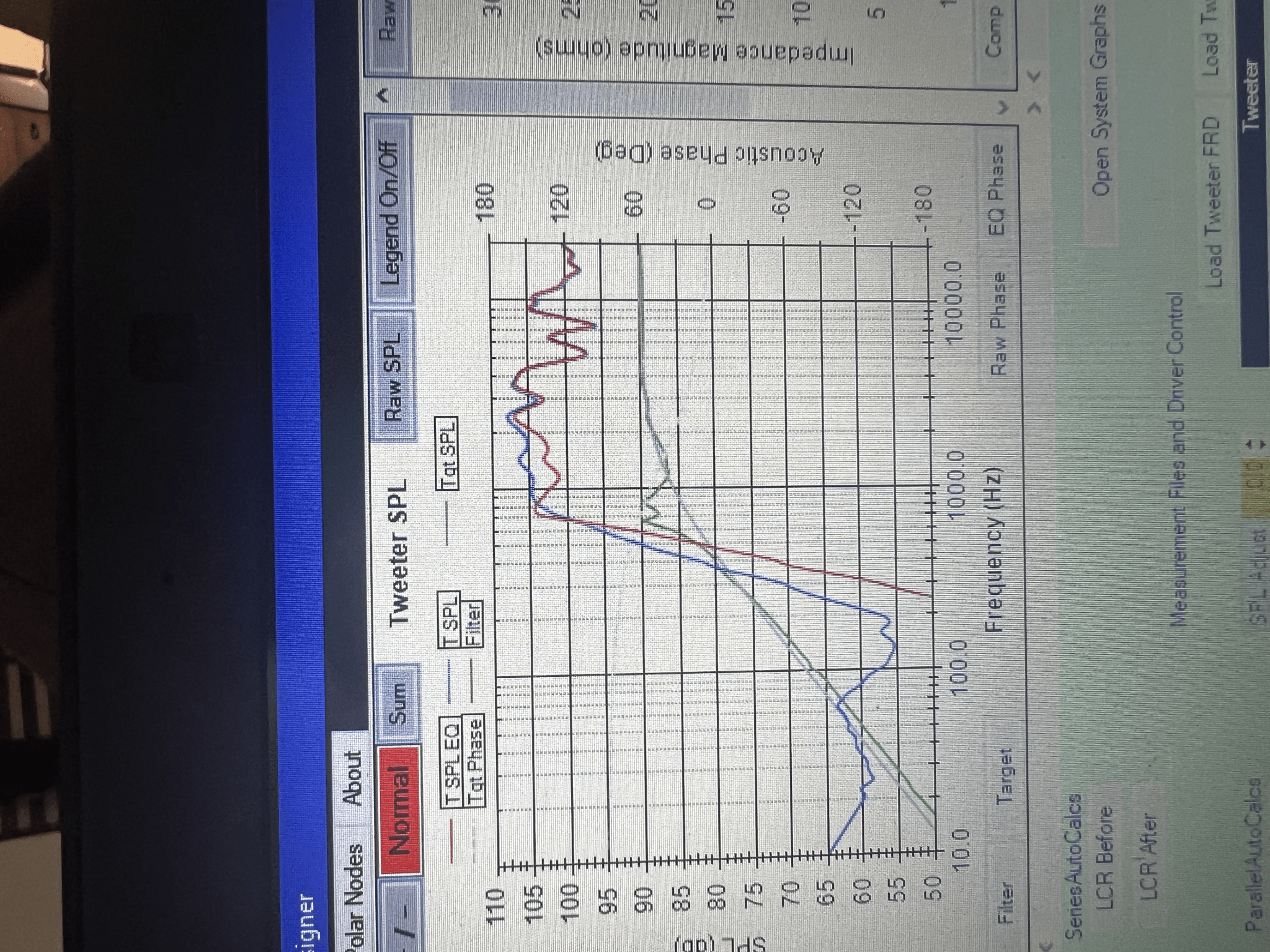

Below I will post the following: The Radian EQ/Imp graph, and the tweeter response for first order using 4.7, 10, and 15uF values plugged into Jeff's program. Any and all guidance is much appreciated, and like I said earlier I'm willing to pay to learn here, I wish I had a mentor in my area but there is nobody doing this. Cheers, Bryan
I APOLOGIZE FOR THE LAST TWO IMAGES BEING ROTATED, I DON'T KNOW WHY THEY LOADED THAT WAY!
With 4.7uF cap, lower green line:
With 10uF cap:
15uF:

Hmm, since this amp isn't made by a big company I don't have any printed data, but I do know it's designed to really want to see an 8ohm load like a lot of small single ended triode amps, if that's any help. I think I understand what you're asking, but I find it odd that the Fs is 67 hz but that falls roughly between the two impedance peaks at 42hz and 90hz, is this because they're being summed somehow?

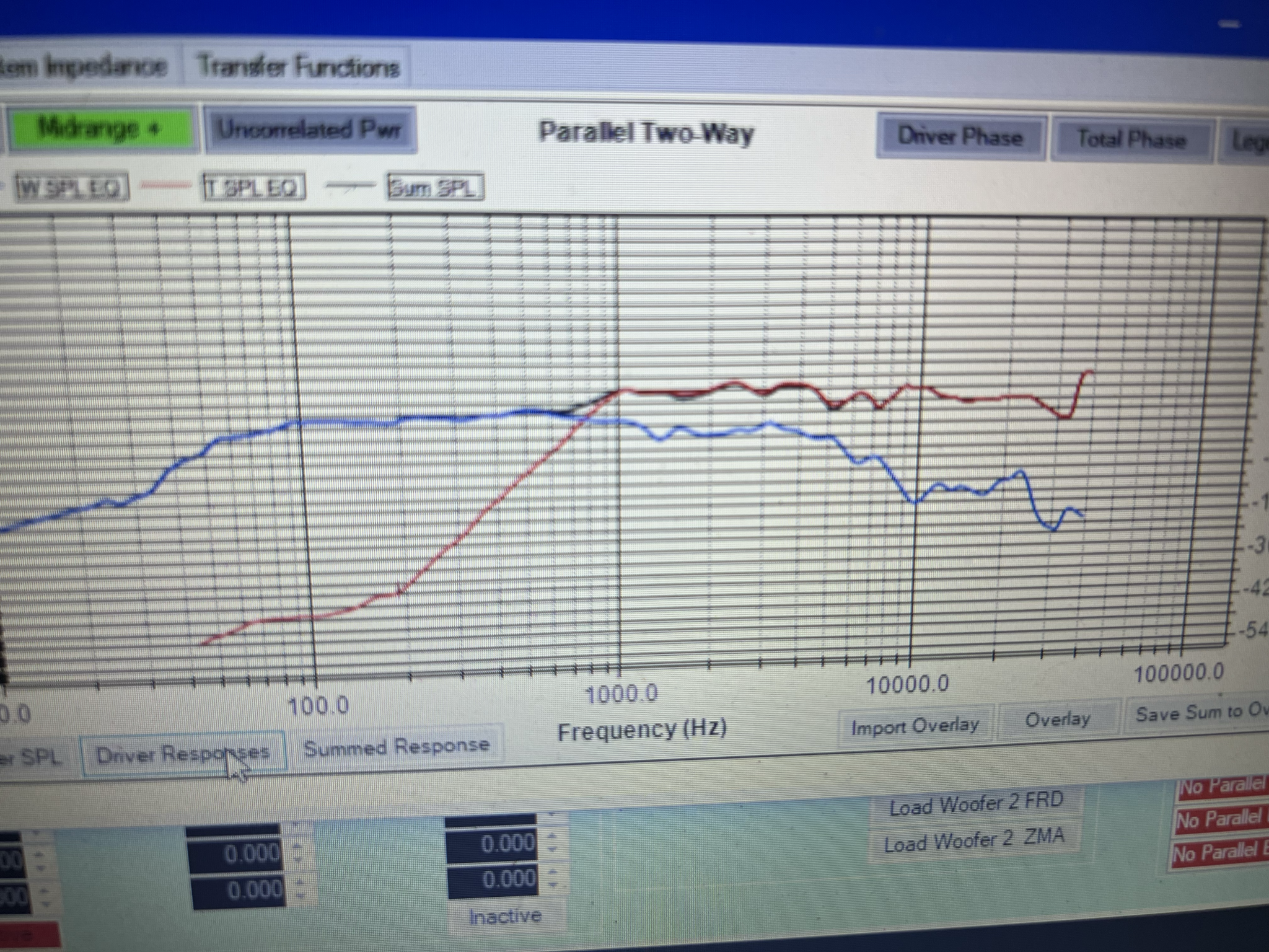

Another odd thing that keeps happening when my buddy is doing the modeling, is that if he sets the xover point at say 1350 in Jeff's software, the plotted crossover point shows up around 800hz. I'm new to this end of things so excuse my ignorance.
For example, the graph below is for second order on the tweeter, first on the woofer, for a target crossover at 1400:
He had to move the target to 2500 to get it to plot the crossover at 1400:

Thanks pico. Since this is a pro audio speaker the crossover is designed mostly for the purpose of achieving a decent FR without regards to the same needs of the home audio community, ie dynamics, speed, phase coherence, etc, but more for protecting the drivers at high levels. The people who've succeeded in using these drivers for home audio scrap the stock xo design and always seem use very simple first and maybe second order (on the tweeter). I know it's a bit of a challenge but I'm trying not to step all over these drivers because the purpose of the project is to create a highly responsive speaker in the vein of big Altecs and other full range and coax/horn speakers. I could easily copy the Radian crossover or the one linked by vinee above, but it's taking me in the opposite direction. I know this can be done because I've seen it done, but don't have access to the designs used unfortunately. It may take a lot of fiddling with the enclosure once I get relatively close with the crossover, but I'm confident it can be done. The tweeter is very challenging though with the impedance spike at 800 hz.
I think the 12" and 15" versions are less problematic, but I really want to solve this as much as possible!
Well, 2nd order on the tweeter is advisable. 3rd order with treble tilt (1uF//6Ω) might be too much. And the woofer might suffer ( !!) from that big coil...I mean, it kills most of the midrange so how is the tweeter asked to come into play? A balanced response from both drivers, as the norm, is advisable ( again). Otherwise it makes no sense to use a 300 W driver and attenuate it where major efficiency shines. But that are the skills for good crossover...and so this thread belongs to Multy-Way !

Also, with stock 5210, average SPL of HF section is something like 7-8 dB above LF section, so you need some HF attenuation. If they only have a capacitor for HF, then it seems like HF section is also somehow modified, so it can match LF level in such way, just with single cap.
My point is, you need more complex crossover for stock unit, like the one mentioned in post #6.
Btw, judging by the component values in that crossover, it looks like its made for 5210 driver variant with 16 Ohm HF section.
The second image in your post #3 looks promising.

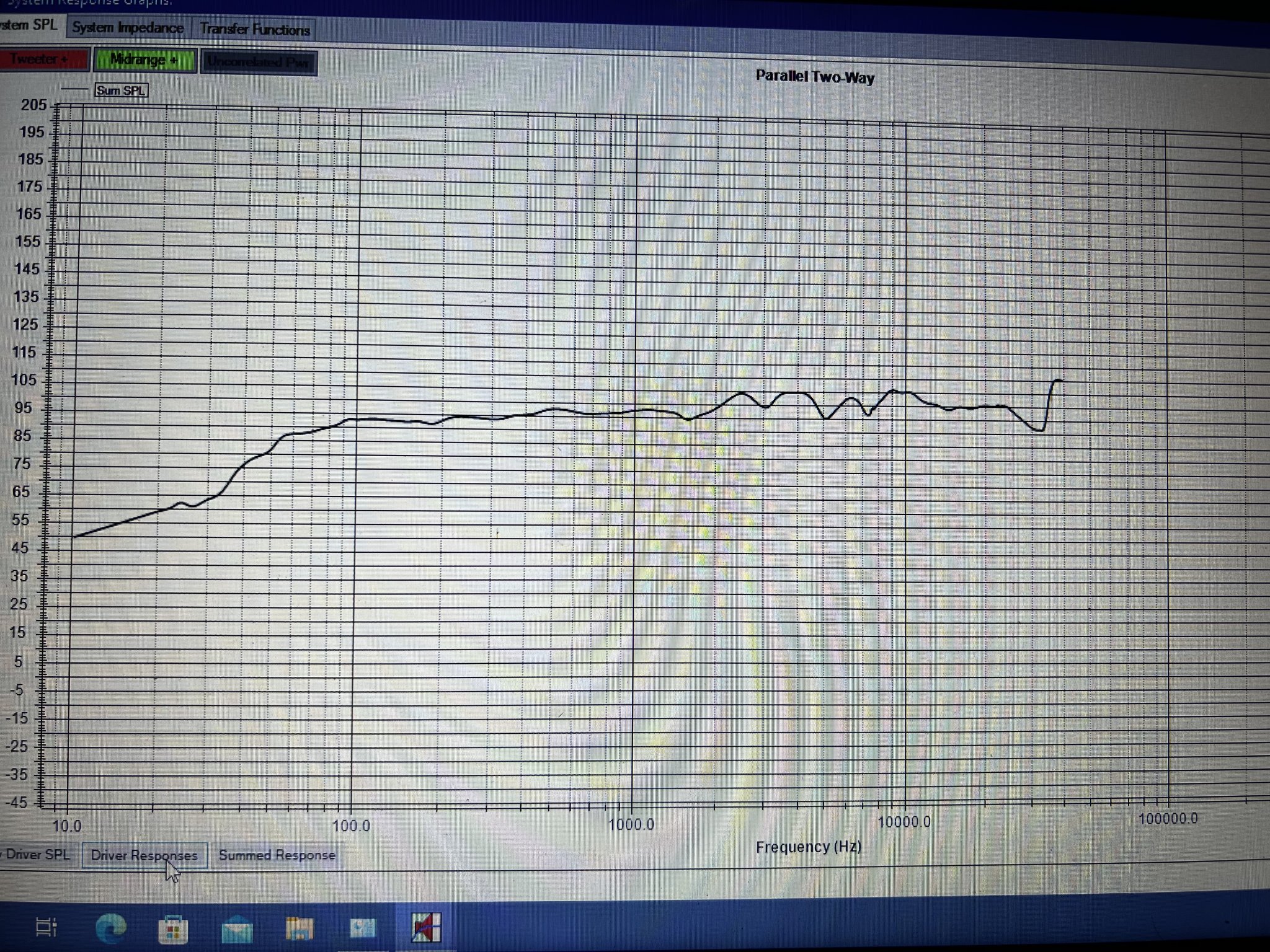

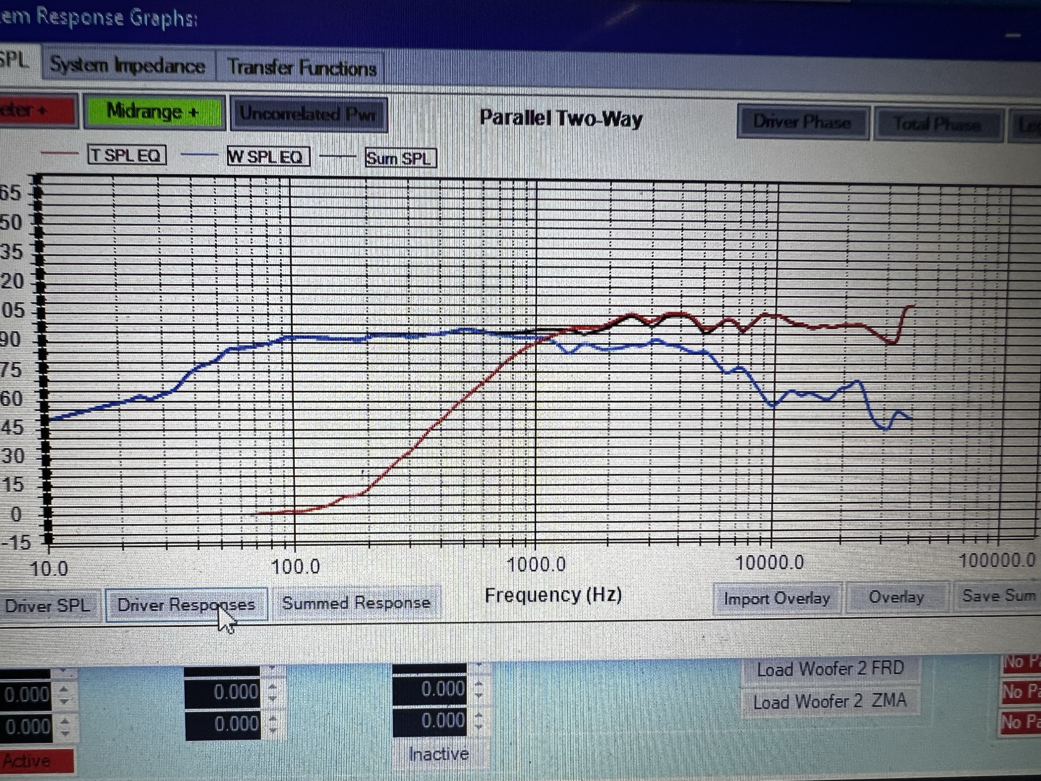

I’ve been using winPCD and I’ve come up with a pretty good solution I think.
1st order on the LF and second order HF.
Crossing at 1300. Any issues/problems/suggestions from you pros?

Thanks Davor, I hadn't noticed the suspension, you're absolutely right. That change alone changes the T/S numbers quite a bit I'm sure. What Cam says is true, Frank is ordering the drivers without the dustcap, I think in earlier times he cut them out if I am not mistaken.
That second image you refer to is where we had the issue of the crossover shifting to the left on the graph, Cam had to push the input values to 2500 hz to get it to behave like that! But he realized there was some volume matching issues causing that, so reworked things and came up with the latest scheme, which looks fantastic and crosses at 1300, using a 5.6uF cap and .64mH inductor on the tweeter, and a really small .25 inductor on the woofer. I was surprised especially by the woofer value, but the impedance is rising rapidly through the crossover area so maybe that's making it easier to choke the woofer off?

So I think I"m getting close. Thanks mattstat you were right, I just can't get these to play together without an l-pad. So right now it's second order on both drivers, plus the l-pad on the tweeter, crossed at 1500. Will start with a pretty good sized ported enclosure for testing and work from there.
